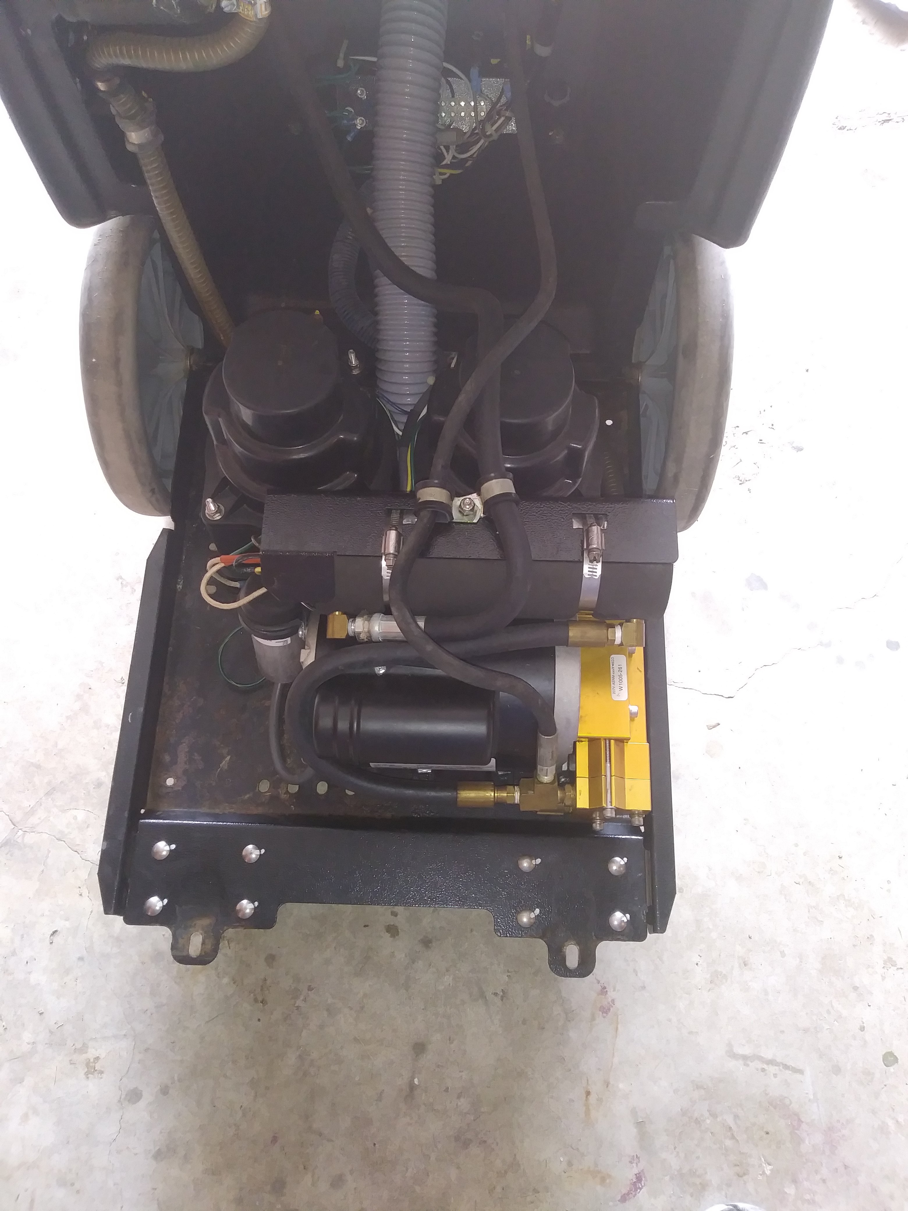

Could you just install any vacuum motors I mean electricity is electricity right as long as the specs olhms amps current etc are the same what makes it not work ??
Not and have your motors in parallel I believe There's a manifold involved below the stand pipe if I remember correctly and the only place I found the right vacuum motors was from a dealer. You might be able to run them in series or build a manifold. I also wonder if you would have to pull the heater as the room in the motor compartment is at a premium.A lot of things in that machine design are strictly proprietary and only marketed by the dealer network. The toggle switches aren't the best either. Can you post a picture of the machine's guts?

Sorry I was away for a bit. Tomorrow I will be where I store my machine and I will post a picture

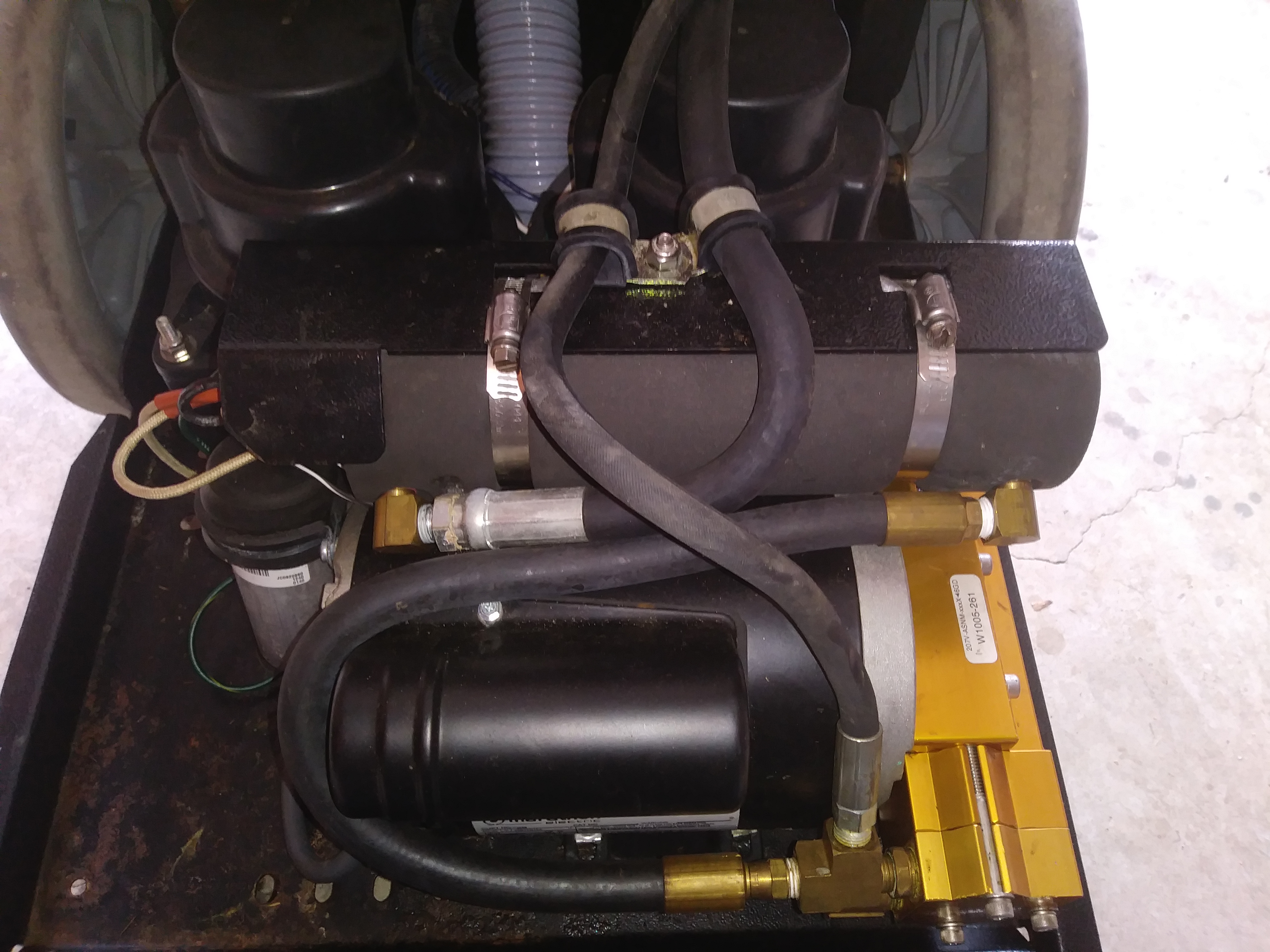

Here are those photos of the machine
28,255
The covers over the vac motors look a little oddball compared to most units. They are in parallel. They are probably only 2-stage as you wouldn't have enough power to run anything bigger with heater in there. It may be possible to ditch the heater and install 3-stage vac motors but I can't tell how difficult it would be without seeing the manifolds with the motors in place. If you did that, you would wire one vac with your pump and the other separately.
I forgot to mention that I had to get the upgraded pump motor. The original one was way thinner, this is almost the same size as my treadmill motor. What do you mean by oddball because I always had a weird feeling about this unit. I did buy it brand new from a jondon location so maybe this had a issue that they fixed before selling it
It appears that there are black plastic covers over the vac motors. Most machines, the motors are exposed.

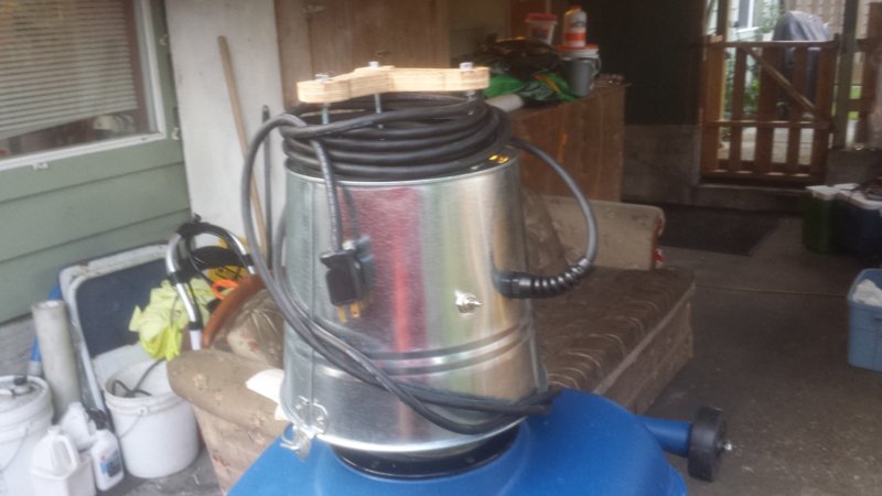

I've looked and I can't find pictures of my bucket booster experiment. I mounted a 3 stage motor on to the lid of my machine. It wasn't pretty but it gave me plenty of air flow. I'll dig around some more to see if I can find it.

Willy P
There you go. It was mounted on a lid. It gave that old powrflite much improved air flow.It doesn't look pretty but it worked quite well
