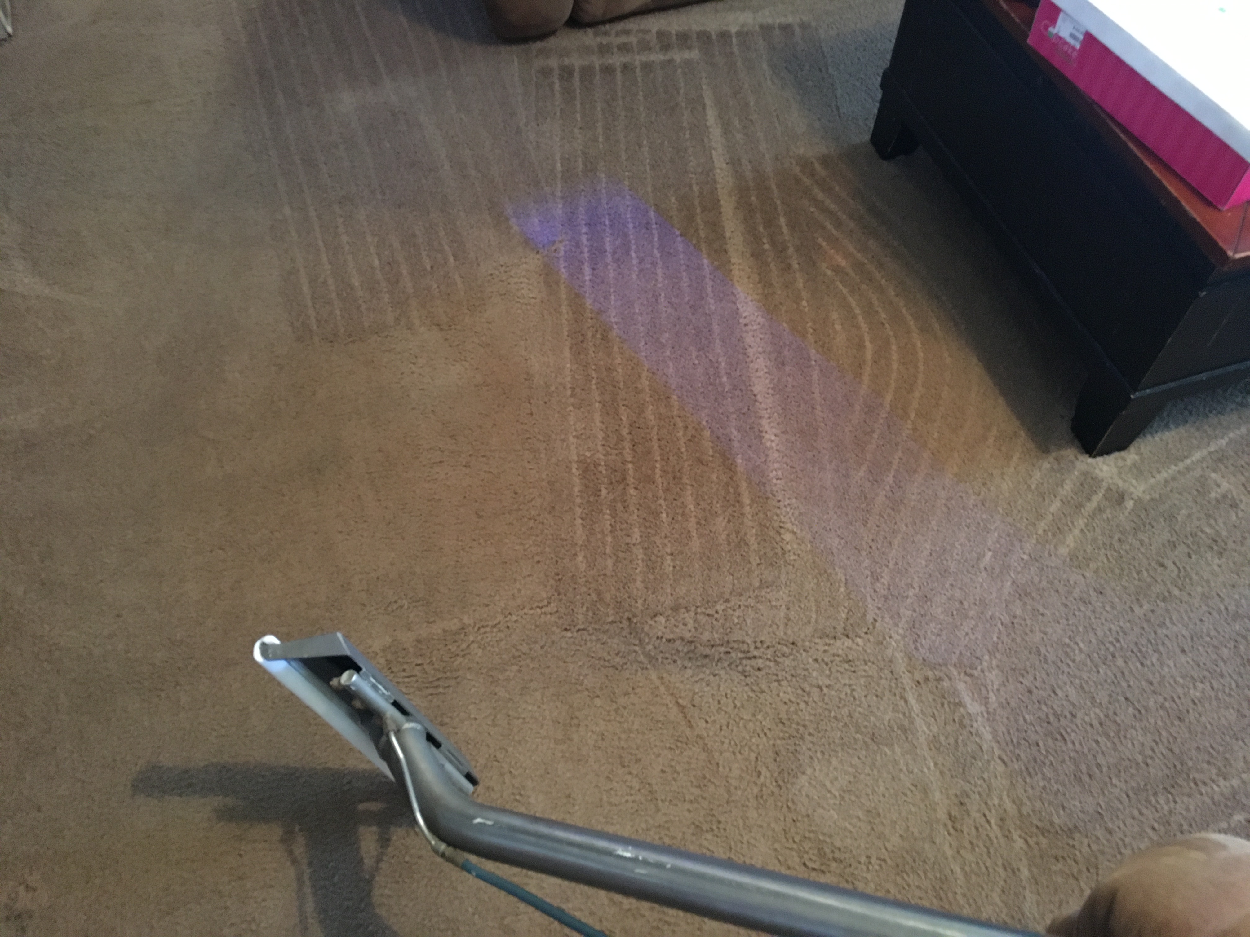

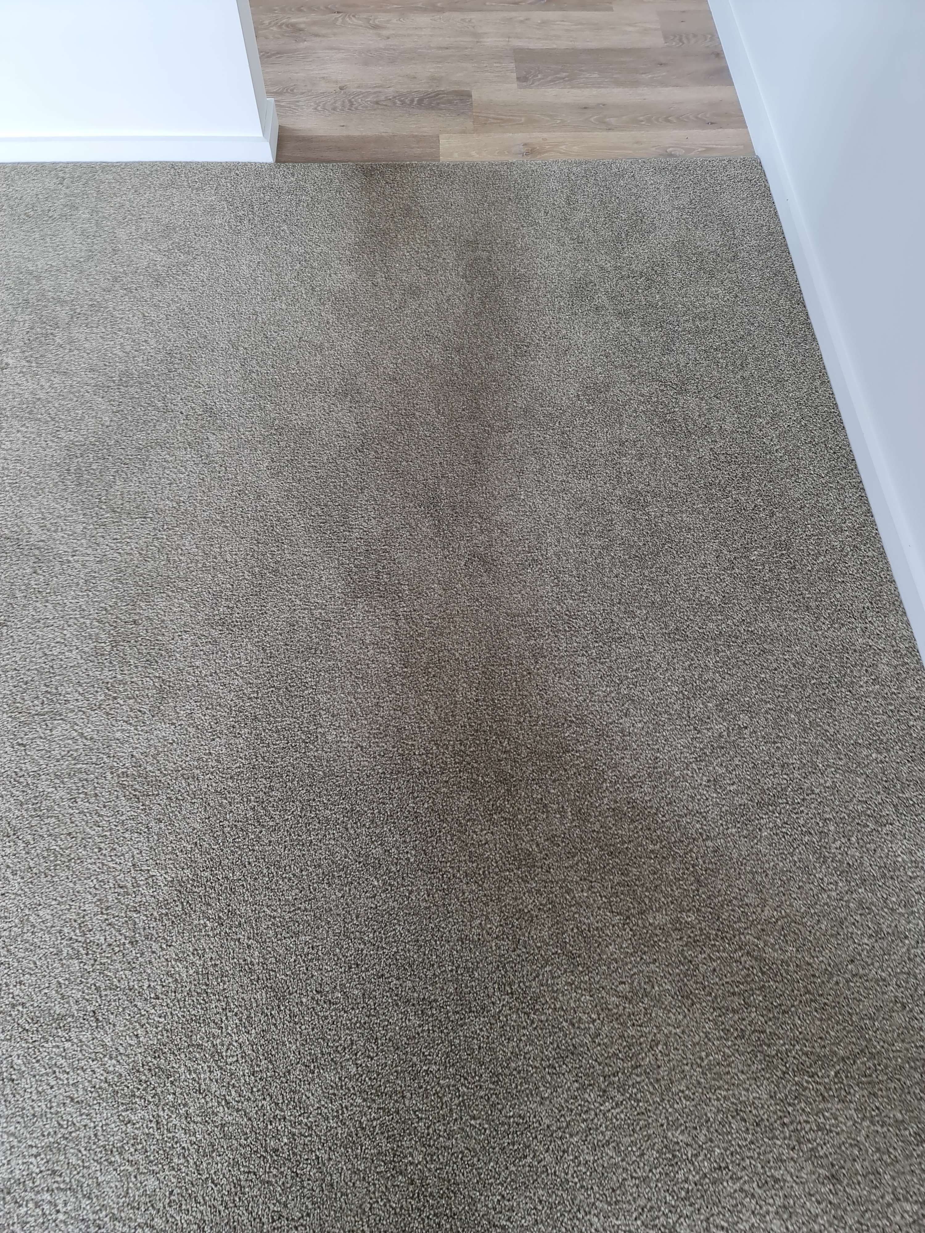

All you old guys...don’t ruin it. Let’s see if the newbies can tell us
7,040
it's a lighting issue.
The window has something with color that is shining the color onto the carpet. put a marker/coin in one corner and in 15 minutes the coin will not be in the corner. This is due to the rotation of the earth.
Sometimes a spot on a window will Shine a spot on a carpet.
14,634
You are correct sir. Just a reminder that different lights and shadows can harass us when we are staring at the carpet while cleaning, thinking it’s a stain or color loss

I've never scrubbed shadows before.....:icon_redface:
I s'pect most of us have had "spot" call backs.
In the early years, I had a call back on two spots in a white burber.
I was puzzled for a minute, cause I knew they weren't there when I cleaned it .
(well maintained and no spills/spots when I started)
noticed the ceiling fan chain knobs and gave 'em a push ...yep, spots started moving.
Mystery solved....

I learned a long time ago .I turn off the lights and carry a flash lite to show the true color of all the carpet. Not affected by lights or shadows . jz.

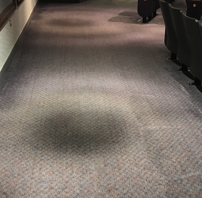

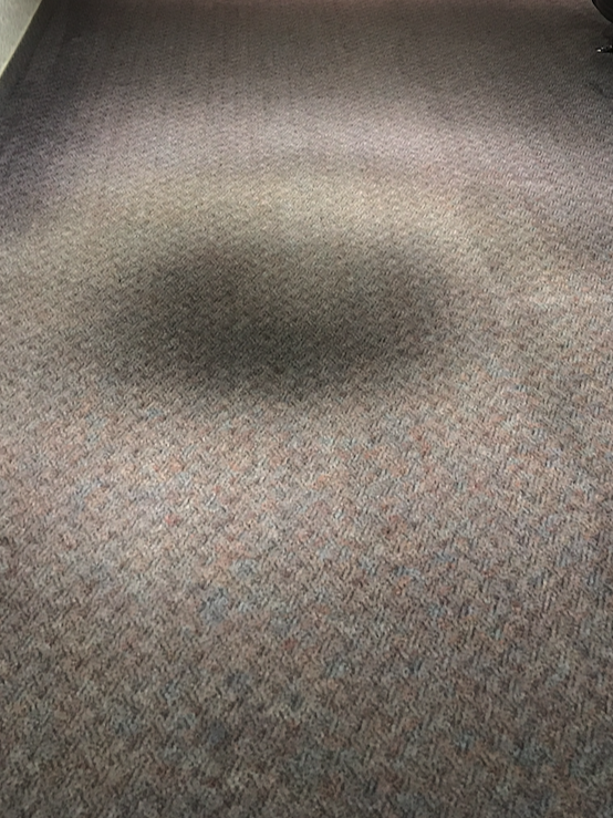

No Radar, it has nothing to do with the method of cleaning.
Let's give it another try, Here's another view...
I’m guess it’s from chair wheels and you couldn’t remove it cuz you’re a rag spinner?
encapman
2,405
Rick Gelinas
The shadow on the right side of the photo is from the backs of the seats in the auditorium.
