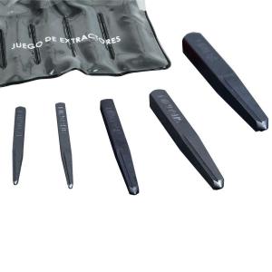

Because brass is soft........the best extractor for the job is this style......
just tap it in there and turn.....screw drivers are not a good idea...
