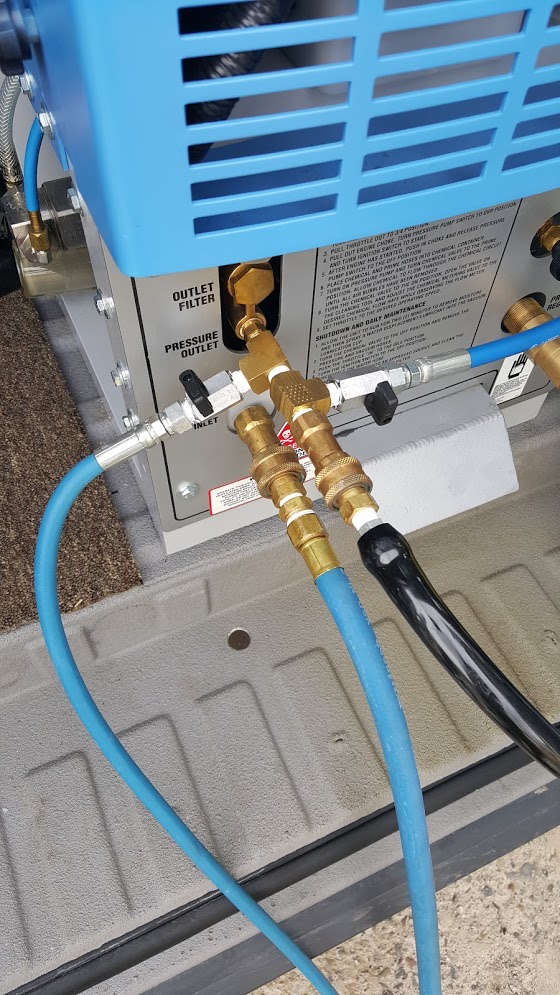

The fine folks a Carpet Maintenance Supply hooked me up with a "Hot Water Convenience" hose (left ball valve)
and a other line just for filling my rinse tank.. (right ball)
Y9RB6FLU6hu4KGXbaKHMokvxSipcGSo5MCQVOSBwA4hblx_4t6zTC-9IAwIYpUTTIVDOCH29lA0WdF74PG8=w560-h995-no.jpg
Most TMs dont come stock like this so lets see how you do it..

doubt those shut off valves are going to last that long with all the heat that comes out of those quick connects......we have a hard enough time making those last on our tools..If that is the way you want to go then I would replace them with the red handle ( for hot water ) 1/4 inch ball valves...mine have lasted for years..
on mine I don't want all that extra weight hanging out there waiting for me to break it off...I use one connection to run to a live reel and just put a red handle brass valve with a QC and just use a courtesy hose to fill all my jugs that I can disconnect and not have in my way...
top one set up for courtesy hose...
bottom with shut off valve plumed to live reel.....

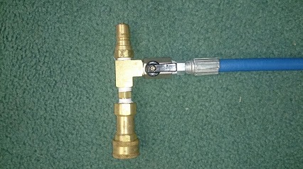

Hydro-Force just introduced a quality convenience hose outlet two weeks ago. Top quality 1000+ PSI ball valve and Qucik connects. You can buy it assembled View attachment 12017 for less than the cost of the parts to build it.
That looks convenient, Scott. But why not just plumb the tee directly to the machine and eliminate a set of quick connects?
Buy that assembly, remove the female quick connect for use elsewhere, and plumb the tee to the machine.
