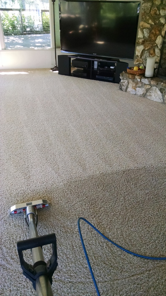

If job is not too bad I will Pre Vac, I'm not gonna ruin my vac if it is a flipping mess.
I will throw in a extra scoop or two of my PS of choice, right now I have ProC, Extreme Clean, ProZyme, POP, Oh and TIDE with color popping power.
Pre scrub with either my 175, or my makeshift scrubber.
I almost always wand out very seldom do I have to use my RV.
As far as spots 95% of the time they are gone after the Prescrub, if not FellsN takes care of most unless red or some sort of colored stain and then I will get Red Relief, carb cleaner, or WD40 to get them out.
Here is one I hacked out today... Pre Vac, Pre Spray, Wand out.
