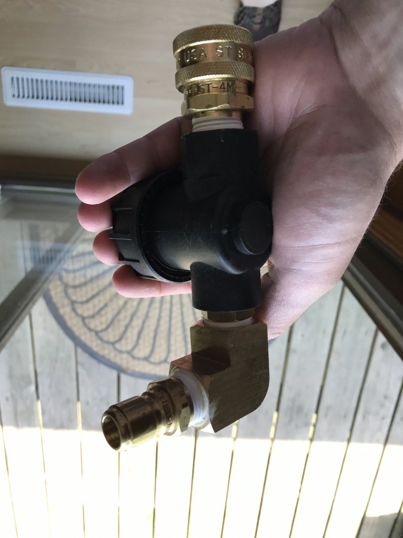

It's just a filter, but it's plug 'n play.
I'm about to replace the CAT pump, and I'm not even scared.
