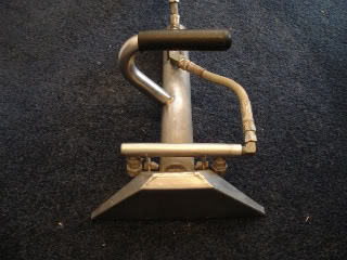

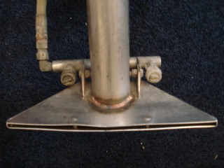

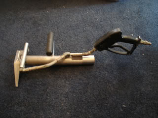

Has anyone used a tool like this? It's supposedly a Stanley Steamer tool. Not sure if it would work any better, but I have never seen one before.

Kevin that one is a lot nicer, 4-jets and constructed different. Anyone know if they are any easier to use?

I think Bob has one of those old stair tools. 2" pipe, just a little short. Apparently works really well.

KevinD said:
http://www.ebay.com/itm/Used-Carpet-Cleaning-Cleaner-Stair-Tool-Stanley-Steemer-/170779335703?pt=LH_DefaultDomain_0&hash=item27c33ddc17
Yep that's the Stanley tool. Just saw it laying in my neighbors yard while the steamer boy finished up.

That ss tool pictured must be very old and some tube cut off. They wouldn't have that valve handle sticking out like that. Hey Chavez, stay away from that one on Ebay. It's all mine. You'd hurt yourself trying to clean these days. lol
What you didn't walk away with any Stanley tools when you left? Rumor has it they are still missing your van. :p
