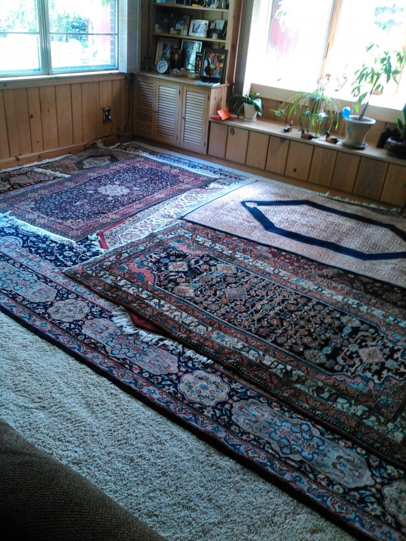

I cleaned 7 fairly clean rugs last week and it took about a hundred gallons of water just to get a couple of the rugs wet all the way through. If there was urine I would still be rinsing them.
The thin ones or loose woven aren't as bad to flush out.
13,372
one 9 x 13 one 8 x8 hex three 4x6 one 2x3 and a 2 X4
Cleaned them in the garage and dried in the basement,den and garage. Three dehumidifiers that I got for $100 each 50 pints. Five fans including a Studebaker.
