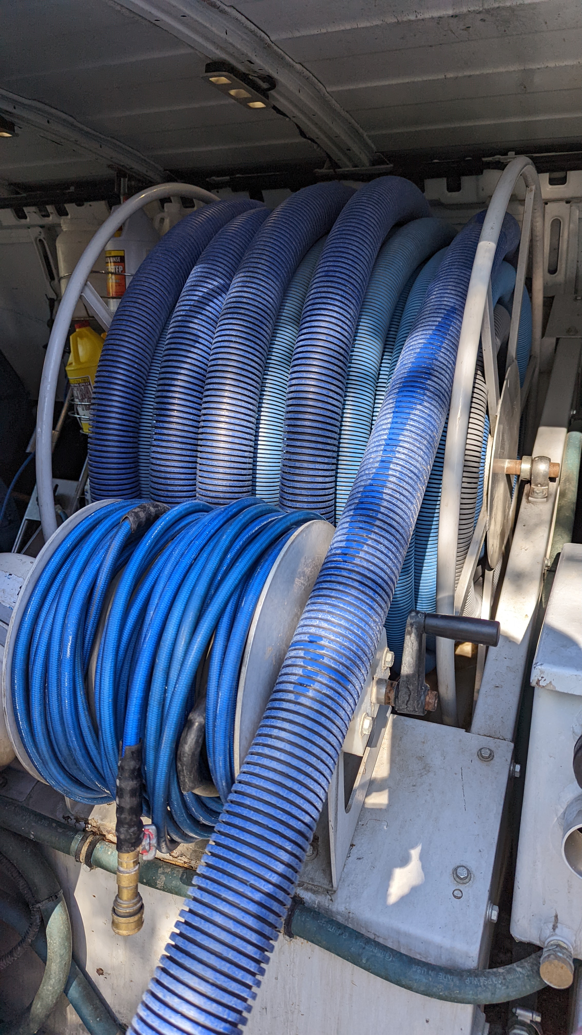

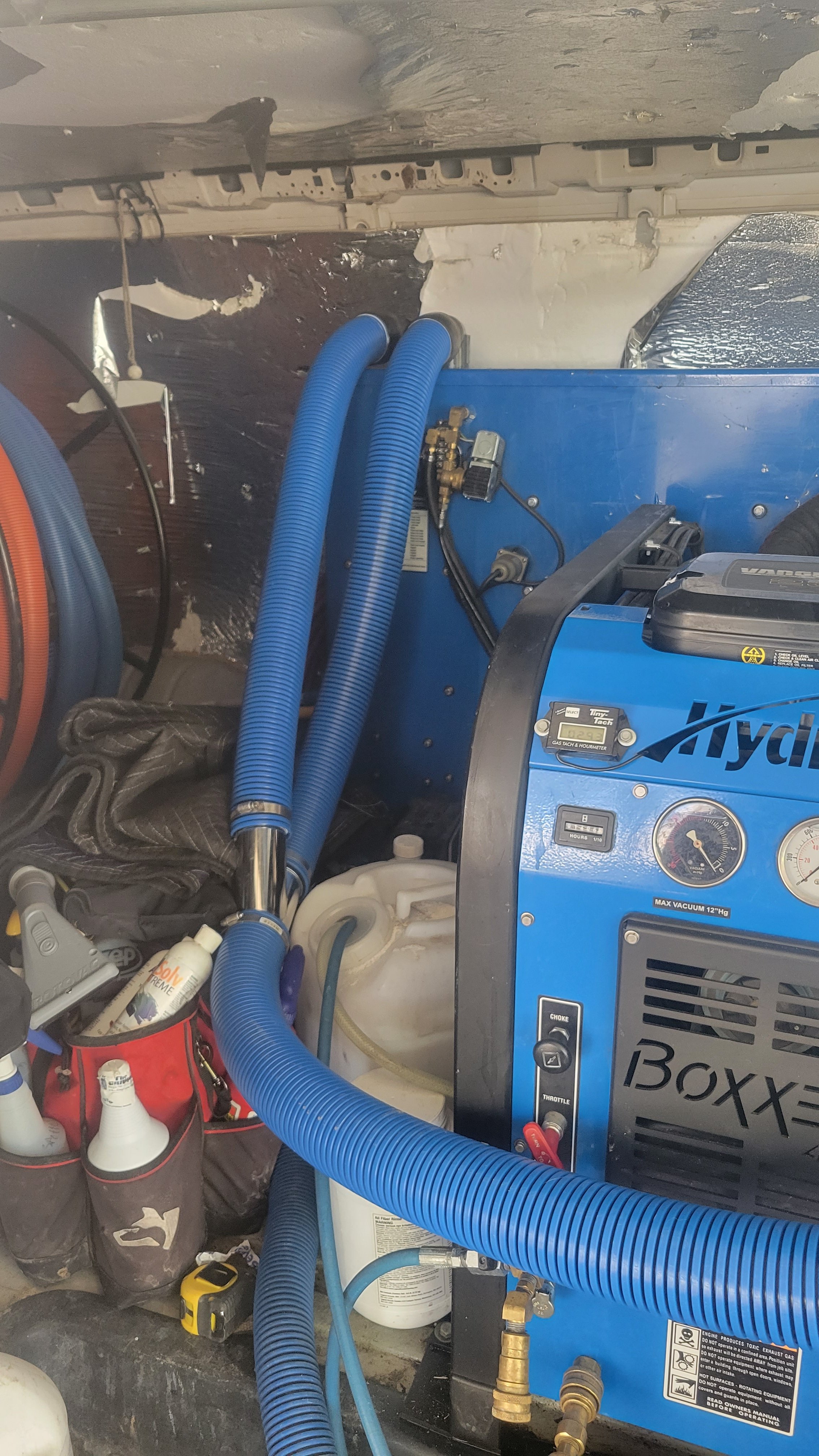

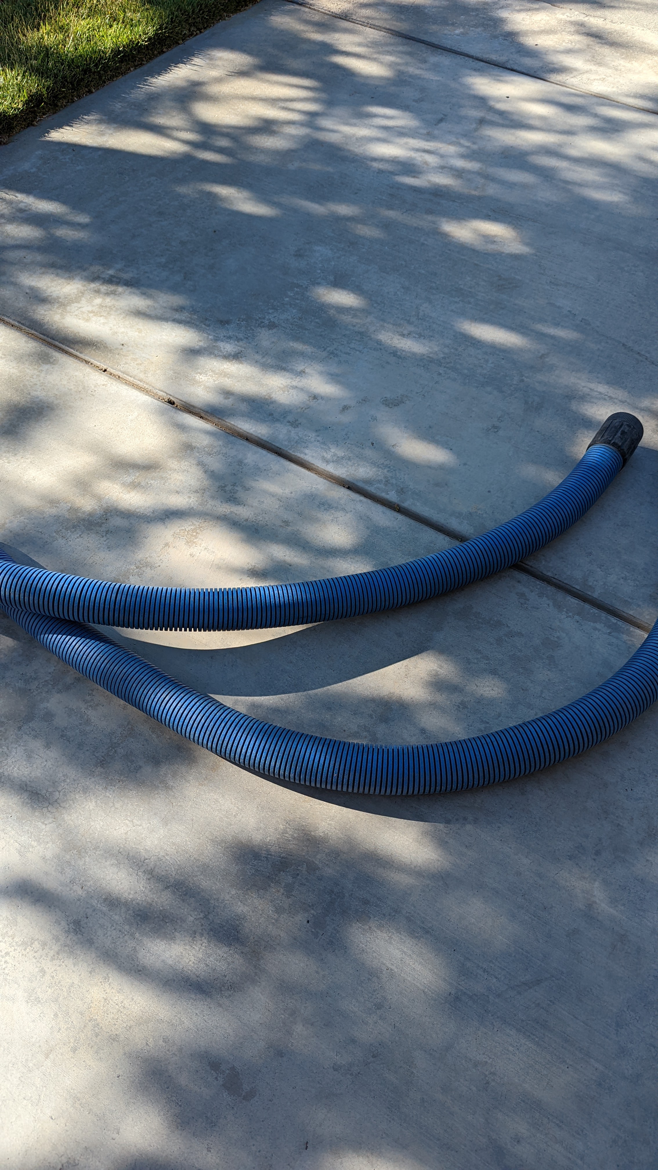

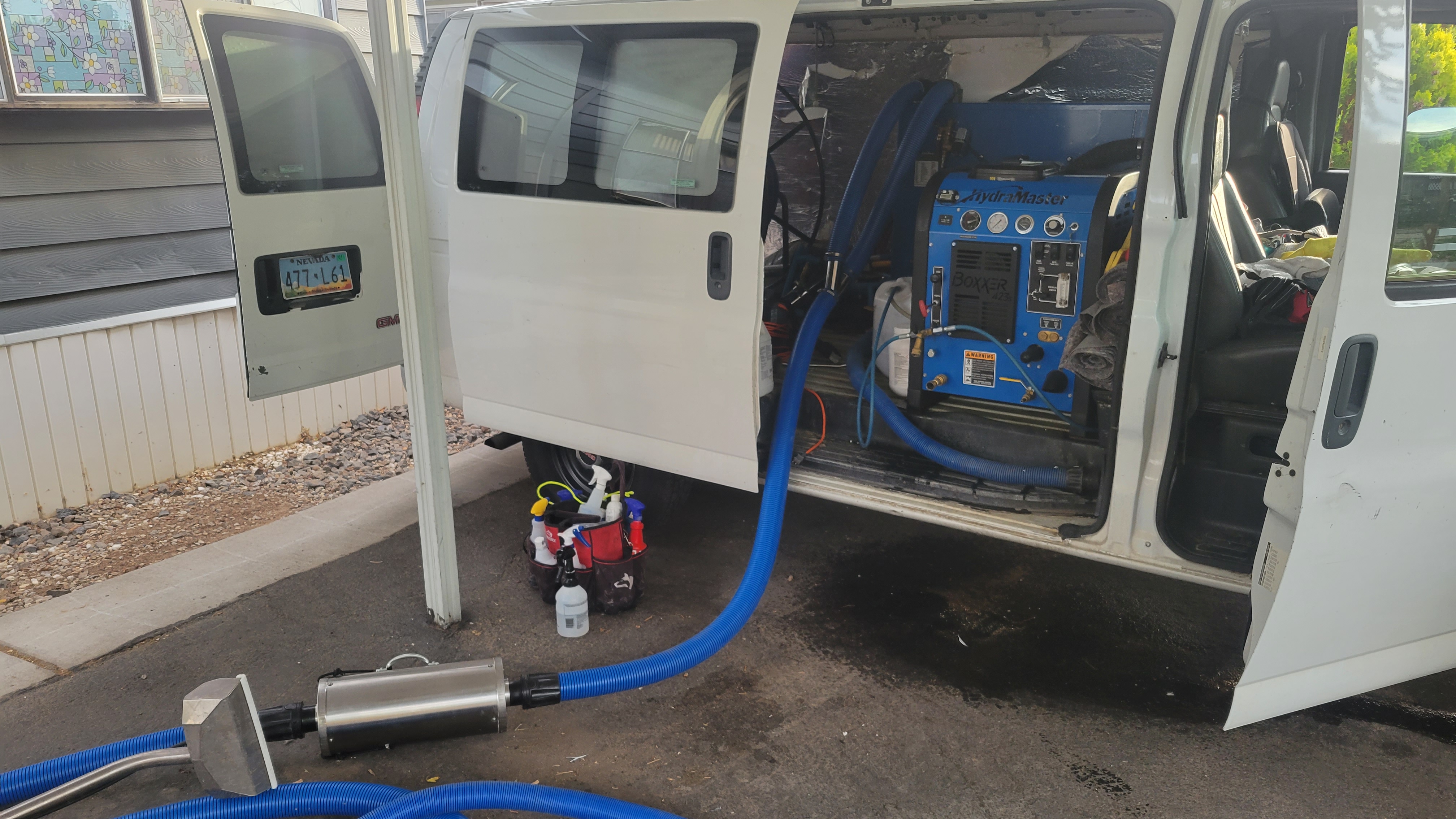

That's the way it comes off the reel 2 small 2.5 leader hoses to filter, 50 ft of 2.5, the last 200 ft is 2 inch.
My 15 foot 1 1/2 stays in the truck.
I mostly run 14 inch devastator or 14 sapphire wands
2.5 to 2 to 1.5
is that called "chokin' the chicken"??
Actually I believe it's called the
Law of deminishing returns
PXL_20220610_150246364.jpg PXL_20220610_150426695.jpg PXL_20220610_150305294.jpg
