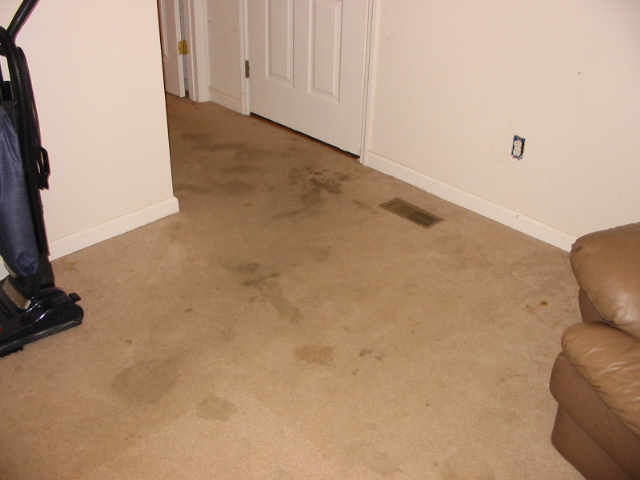

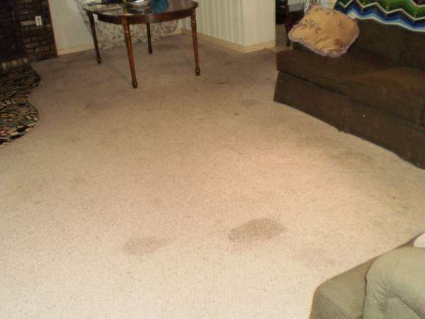

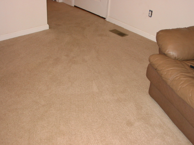

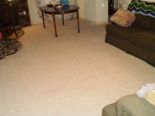

Your full of crap...angle change?...sorry I didnt mark an x on the first pic..25.00 tip..pic legit .. spot aint there DA!!another POG with a chip on his shoulder.

Lets see who is full of crap...
The two spots in the foreground of the before pic are still visible in the after pic as well as the spots by the sofa. The camera angle has been changed...look at the table...and "Jenny" herself was obviously added to the pic later for advertizing purposes. Look dude...I took the photo into Photoshop and enlarged it to make sure I was right..if you want I will email you the enlargement. Spots are there... Duh!!! You and I both know that you could have removed those spots with some prespot attention and some agitation. Try putting an OP machine or rotary175 on your trucks and using it for agitation sometime.You must have been too busy splashing and dashing and cashing...all those TMs and still can't clean a carpet.... :wink:

and your before and after pic...your angle lens is different and I see some spots.. do I need to photo shop? are you hiding something?... camera dont lie.
