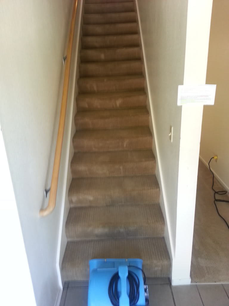

How real men clean a staircase.
114,150
hack?
came out great!
no mini wand or hand tool will out clean a full size, full flow wand.

I'm kidding.....I'd do it, but it makes me way too tired trying to manhandle the wand on a staircase.

yup, unless I cant get the bottom couple stairs I use my ti wand, occasionally I will use a hand tool if the bull nose is trashed.

If custy isn't home, not a bad way to clean stairs. But....custy "perception" of that awkward way of cleaning stairs. Do you check whats under the stairs? Around here, there's finished ceilings under just about every staircase (basements in this neck of the woods). If steps are not built tight, all that extra rinse has to go somewhere before you follow up vacuum. Seen it, done it in my "formative" years. Try and charge $85 around these parts for a standard staircase, and you'll be wearing the custys foot in your arse! Hell, the insurance for WD cleaning only pays $2.50-3.00 a step.
I can probably get away with $50 for a full set of standard steps. That's pushin' it.

That's cool but I definitely prefer using my stair tool as opposed to a full-size wand or upholstery tool

thousands upon thousands of staircases cleaned this way...
if not more.
Ely's 4 months of experience is evident by his speed but he's got it down now to the point that I don't need to inspect his work.
Unless you guys are cleaning the whole house with a mini wand or hand tool, I'd have to call you a hypocrite.
11,182
I think if it were possible to keep all the angles the same as wall to wall than maybe your analogy works, but with all the twisting and straining it isn't worth it.
A Prochem upholstery tool with a #2 jet will out clean anything, more lift as much flow as your ti wand why aren't you cleaning wall to wall with it??
Still if your happy doing it your way congratz my 5 foot 8 son couldn't do it that way maybe with a quad.

I've been doing it that way for a long time and it's actually less labor intensive, faster & much more thorough. I do the noses on the way down then go back up & start from the top. I felt like a hack for a few days when I first did it but it wore off once I started cleaning the majority areas of sofas this way. Wait till you bust out a mattress in just 2 minutes for $75

I've been a real man a few times, however I much prefer to be a puss! I believe a stair tool is much more aggressive where u need it to be. However with that being said we always ran church (wider) stairs with the Ti

Usually use a stair tool but we also have this crappy little wand must be 8-9 inches that butler gave us on our first truck. Took me about a day to order a new one, its perfect for stairs though...

Isn't worth it to who?
$85 a set is more than worth it to me.
Physically a ti is a toy to you it's a big wand for the rest of us it's not worth the strain and pain you talked about.
So I guess you sons not getting a stair tool???

I always follow up by toweling the stairs. Helps on the bullnoses and water that drips down the risers.
I just do about 4 steps and then use the vacuum hose and run it across the bull nose...sucks all the water right up..picks the carpet up and makes it much dryer and look nicer......
no way I would try to use the Ti wand on stairs......I hate that wand.....plus the weight of the hoses and just trying to reach back to key the trigger would kill me.....
That's how I clean them too!
Large carpet wand for the tread but I go back with the small Prochem stair tool for the riser (rarely dirty) and to clean up the bullnose. I agree the big wand rinses so much better. Hurt my wrist after doing and set because it's awkward but it's faster and looks so much better due to the flushing.
