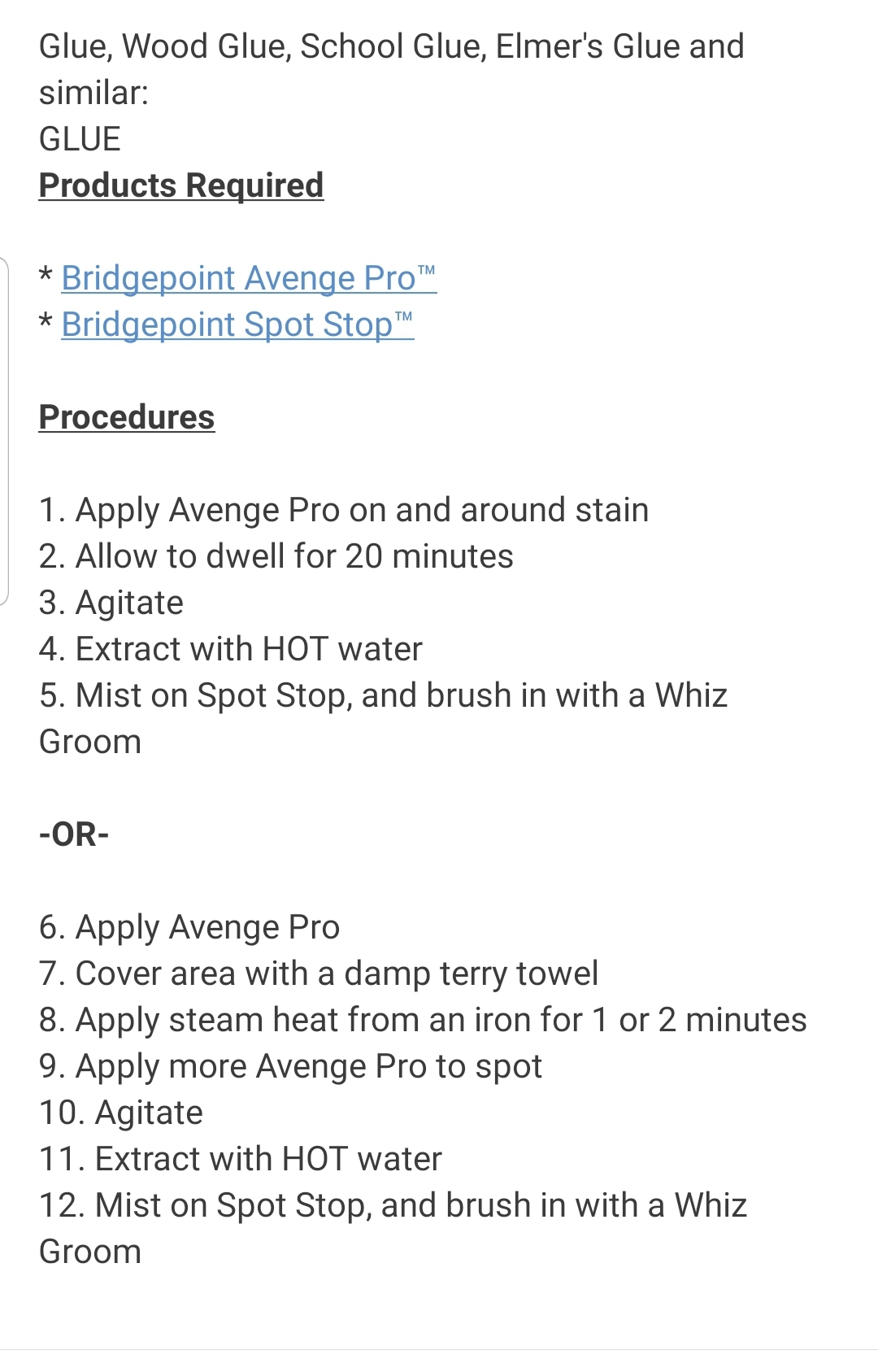

I used avenge pro or solvent clean and cut slits to let the chemical in the goo. After 15 or 20 minutes dwell I hit it with the 360i Quad or BH and it came out. I was surprised and it was the first time I had had any success removing the junk.

a scottw post I stole from somewhere.. :shifty:
never tried his way so dunno?
This works pretty well for glues. Slime usually adds a few ingredients to make removal difficult. There are several recipes for slime. Usually adding the citrus solvent and more moist heat are the best additional steps to take.
