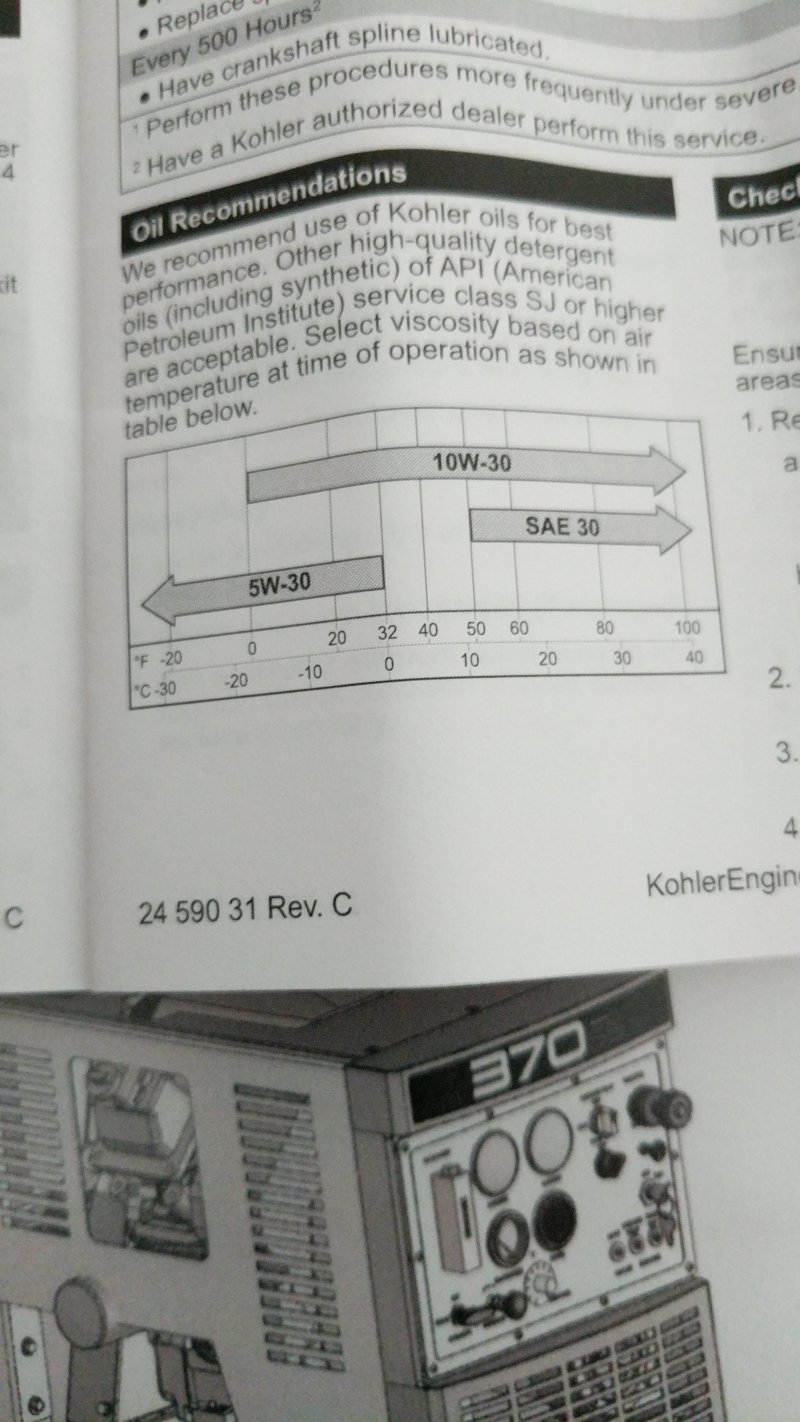

It's the same weight as the 10w30. I've read that it stays on the cylinder walls better for the cold cranks, which is the time when the engine suffers wear the most. Does the manual say to use 10w30 on the west coast?
114,519
The graph is all it gives me Matt
But I'm not on the coast, I'm on the east side of the Sierra at 4800 ft elevation. My working temps range from 15° to 105° through out the year, and on some occasions, the same day. :eekk:
