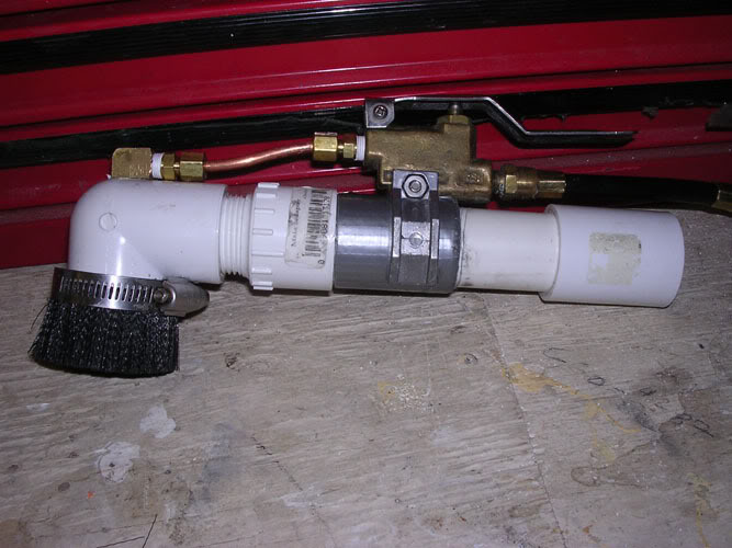

If you're on a budget, no need to go buy and another tool. Rig up your uph. tool. Tape a small piece of rubber or something to the ends.
Shawn's product looks good but you can get away with whatever you have for an alkaline, add degreaser. Mist with some dlimone as a last step before you do your acid wash. Try not to let the cleaner drip. I used a small tampico brush from HD for this and agitation. Works good on uph. as well but use any brush if you want. If the jet in your uph. tool is inside you probably won't make much of a mess. Tarp and a few rags will be fine.
I don't think the white stuff is effloresence. I see this in a lot of bricks , some kind of paint.
I know what you mean about spending money on everything. The mini turbo would do well on most of it but how do you do the top and sides with it, you'll make a mess and you'll have to tape the walls. Sooner or later everyone will need my ghetto tool for detailing. I have it on sale for $249.00 so hurry and buy now. Oh yeah, your choice of color on the duct tape to match your company uniform.
:lol:
Albert
