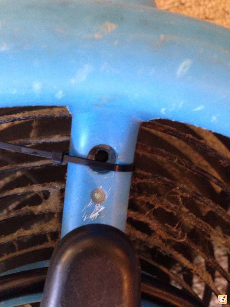

Just wanted to say I had one fall sown some stairs worked fine then started making a a racket fan rubbing.
I pulled it apart jimmied the fan and made it workable I used zip ties to put it back together.
Then I heard you guys mentioning the screws holding the fans in place and sure enough there was one missing from loud racket fan.
Put a new screw and tightened other's down put it back together with more zip ties works like day one.
Then the next day another fans lost its screw.
All I'm saying zip ties!

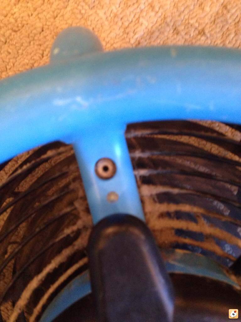

Ill post a photo tomorrow but I zip tie right around the same place the rivet comes out
11,182
Drill out rivets
Then you can open easily and tighten screws that hold fan in place
Put back together with zip ties
