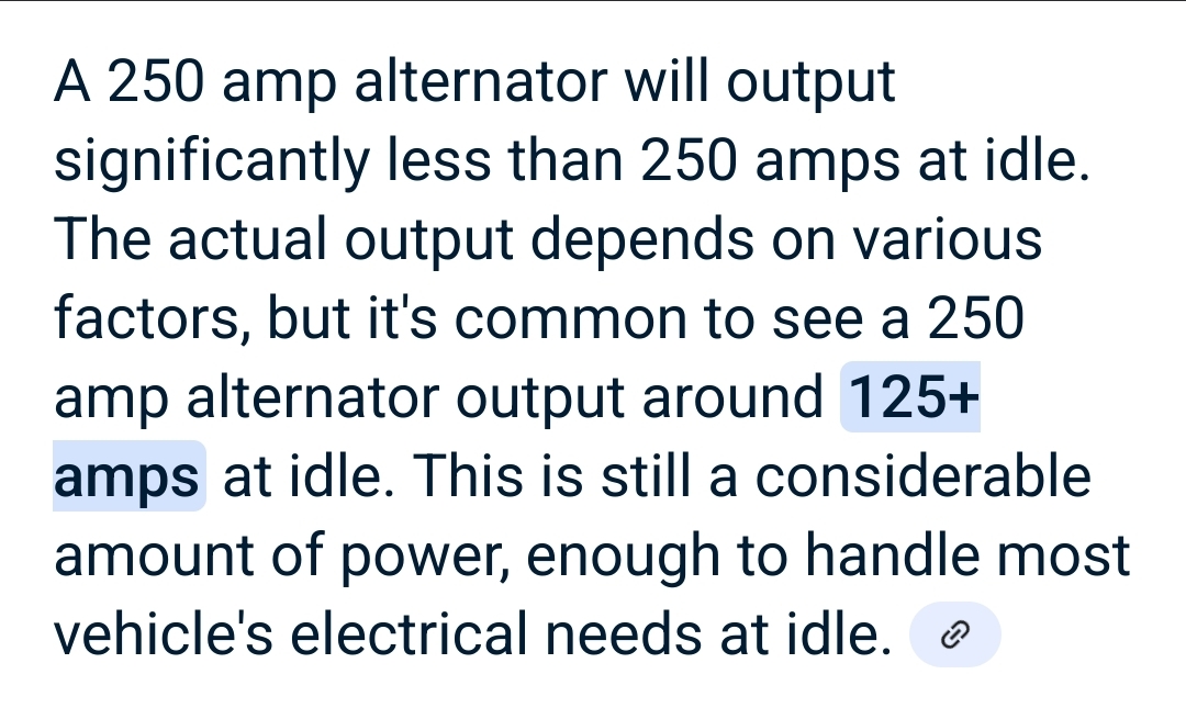

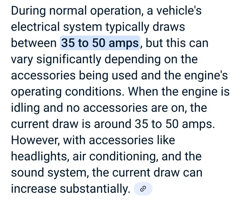

Do you mean it has a 250 amp alternator? Tell us what the actual amperage output at idle is. 250 amp alternators put out around 125 amps at idle, and your vehicle is consuming about 50 of those amps while running........

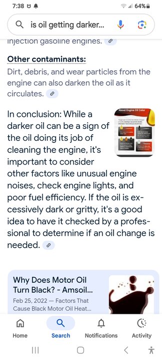

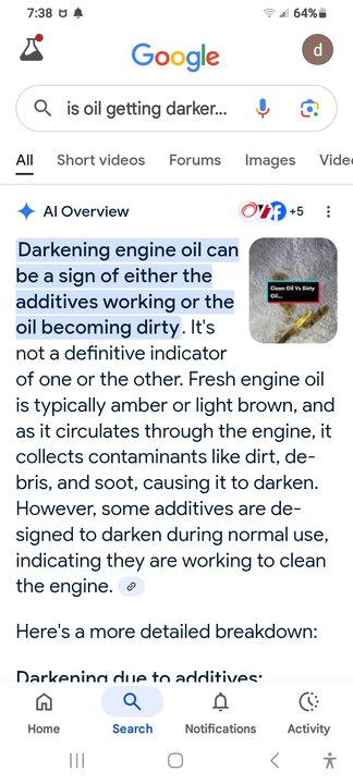

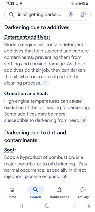

I have a friend that several years ago i got into a heated argument with about oil change intervals he would change his oil every 3000 miles and he said it was better for the car. My stance was he was wasting his money and shiuld change oil every 5000. Well he moved away and a few years later i got a call outa the blue from him. He asked if I remembered that argument i said yes he said that he had just bought a 750BMW and got the extended service package and the manufacturer and dealer would only change the oil every 7000 miles or once a year. He just thought id like to know
I'm always concerned when I see motor oil getting significantly darker. If it is high quality synthetic oil and you're only 3k in since the last oil change but the oil is quite dark compared to new... still fine to wait until 5k to change it?
Why are you so hung up on a huge alternator??? You gunna power up the ho
Oil changes color partly as a chemical reaction to the detergents and additives working more than being dirty

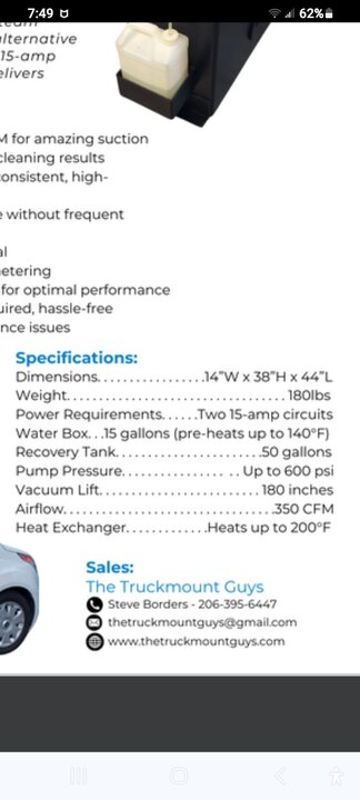

Regarding this Hydroclean electric tm? If he's not running a generator, or plugging into shore power from a home or business.. the power to run electric vacuums, pumps, and more has to come from somewhere.

A 400 amp alternator with a small pulley will you give you the most rotations and output at idle. With a small pulley that could produce about 250 amps at idle, and produce about the same vacuum and psi of my Hydramaster PEX 500 portable. But then 120 feet of vacuum line creates a loss.
Unless I missed something he is planning on powering the vacuum and pressure from the van, electrically.
I don't know anything about that machine except what the information sheet says and it says it requires 2-15a home circuits in addition to the van so im assuming that its a portable mounted in a van and possibly using some sort of a heat exchanger
