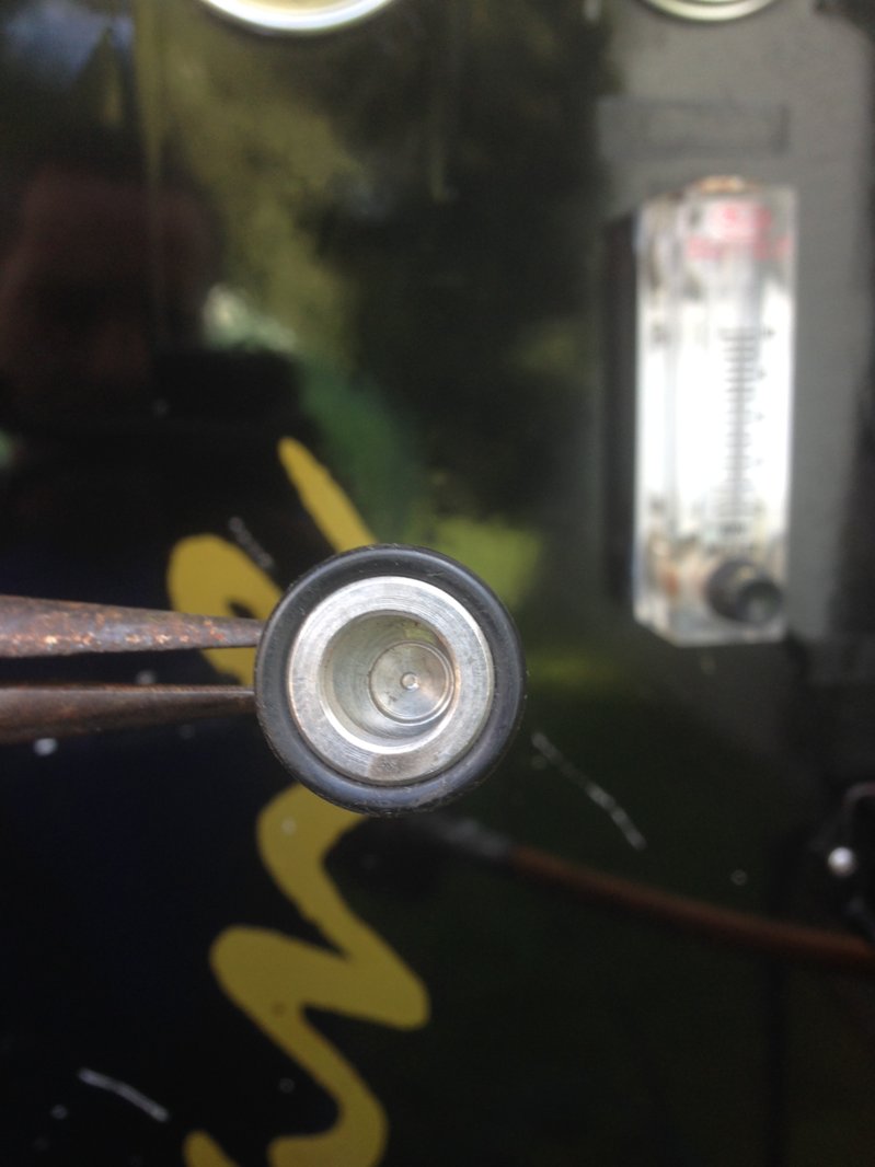

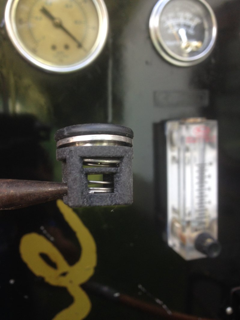

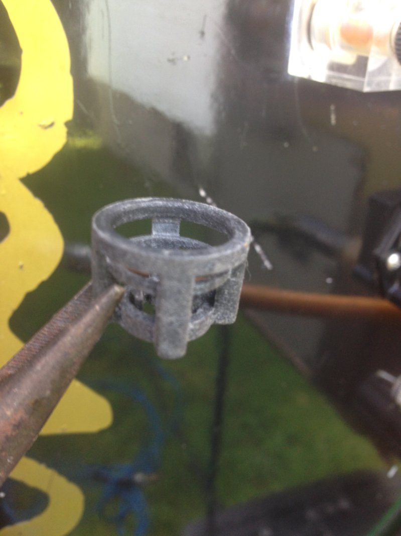

Dan hit the nail on the head !! I pulled out the check valves and the plate that rides up and down seated above the spring wore down the side frame enough to cause a lip which the plate got stuck under leaving an opening up top. 3 out of 6 had a lip - 1 more than the 2nd which was more than the 3rd. 1 was caught under the lip, 2 snagged but did spring back and 3 was occassional snag. I replaced all 6 and pressure is rockin !!
Spurlington
Dec 15, 2012
1,324
On The Board
Spurlino
You can see the circle looking from the top is off center in pic 1 .. see the lean in pic 2 .. pic 3 you can see the side worn down creating a lip
