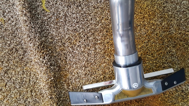

Mark, I love your zipper videos, but would you the zipper on say, a 65oz Saxony carpet?
I have....but sometimes it is not as easy...but once I get it rolling (pushing) I just keep going.
Sometimes, I am still faster just to gut through it vs go out to the van and get a wand or something else.
Also, if you lift up the rear glide a bit (depending on the pad cush) it can make it easier...but again, sometimes, I can have it done before even bothering....

I'm calling his bluff on it being faster in a house
I've been using the zipper in the house since day one. It's definitely faster. Keep in mind I mostly do large homes. It's also easier to train some one on. In the beginning I would train them on the wand and the zipper. Not one guy would choose the wand.

If you could only have one and you wanted to use it for resi, which zippididooder would you reccomend?
Reactions: Mark Saiger
11,200
Regular Zipper...and probably the 13 inch to begin with if doing mostly residential.... but we use our 15 inch all the time.
The 13" will get into more places. I have both but almost always use the 15". If you move most things the 15" will be fine , if not then the 13" would work better.

Mark, how much agitation do you do before you Zipper on residential on average?
Do you ever detail out with a wand in the tight nooks and cranny's (closets, toilets, dressers, chairs etc...) 1st and then Zipper?
Have you ever tried going straight up and moving over 50% and straight back across the room? It is two cleaning passes as well but the edge on the first pass gets the center on the second pass. It actually ends up much faster too, because going straight up and back you tend to overlap a bit when you move over.
We agitate a lot of residential with CRB, but if really trashed, we just go with Rotovac 360 XL if don't feel we can get it as easy with Zipper and Agitation of CRB....
BUT....
We don't always have to CRB agitate....we get lucky and have some nice cleaner clients and don't have to agitate...but today, I think we agitated 2 out of the 3 residentials, but then had a fairly easy to clean commercial (except for the hose runs) and no agitation needed.
We are really good with detailing with the 15 inch Zipper even in closets and other tight areas....
for passes...one wet pass forward, come back on the same pass wet (yes it does overlap a bit) then keep doing for a section...then zig zag dry passes but not like a wand for shark tooth look as we groom everything....
We rarely pull the wands off the vans....
