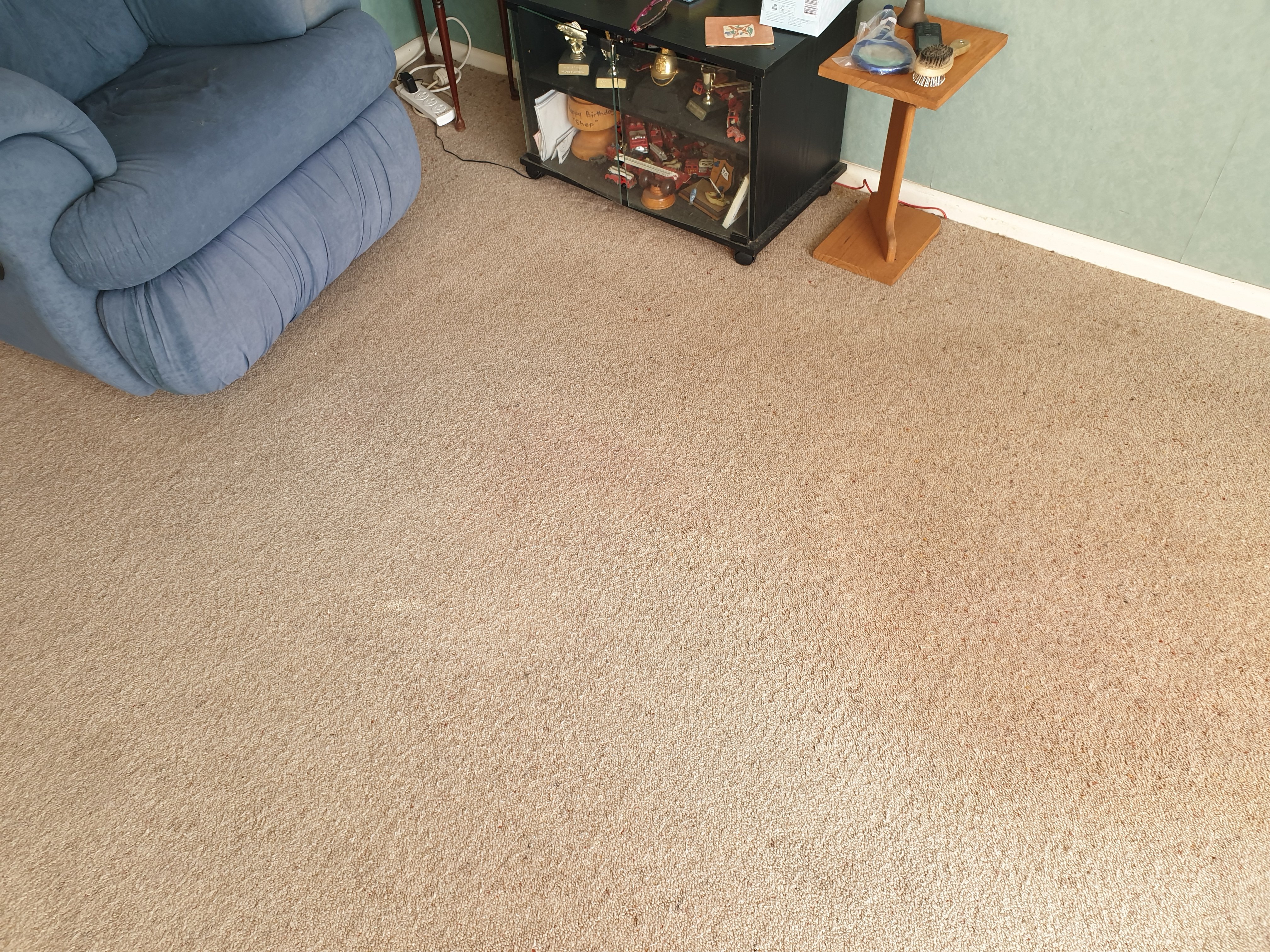

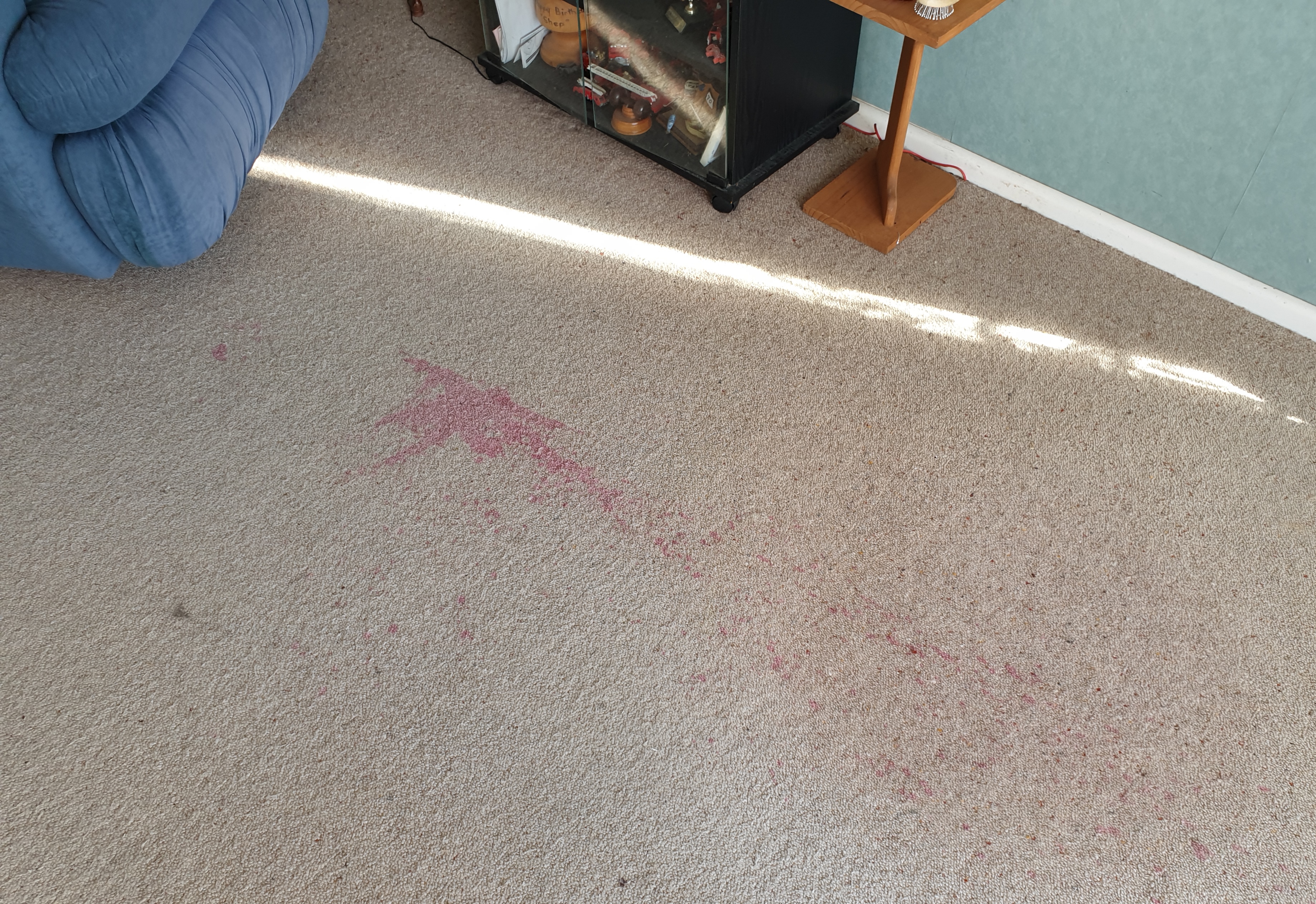

Regular elderly clients, he had a heart attack and threw his raspberry drink over there wool carpet..
still a shadow but should fade out as it drys

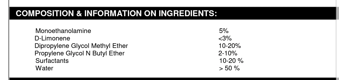

so changed to a local product which normally works better for synthetic reds, it will be rebranded I suspect from something you probably have access to?
SDS specs of what I used with heat transfer and acid rinse
