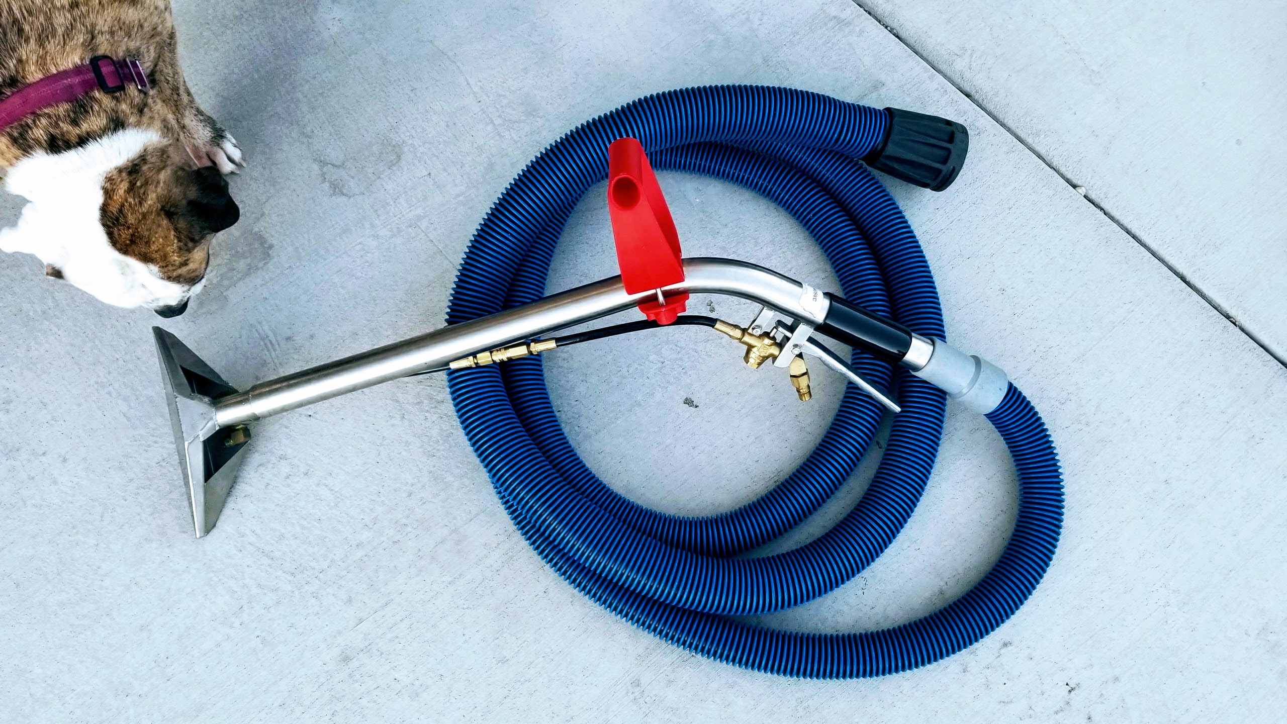

I finally love it. PMF stair wand.
114,522
Took a while to get er down but now she's my pal.

There was a learning curve for me. When I first got it from an auction on this board the glide wasn't ready yet. I really kind of hated it. I bugged PMF enough that they finally sent me a 3rd party glide so I would stop calling them. The glide made the jets hit correctly. I first used it the way I used stair tools in the past and so I hated the loose swivel. Was ready to junk it ...then I watched Saigers Aaron demonstrate how they use it. The loose swivel is perfect for knocking it around to do risers and back again for the treads. I really like it now. A lot.

I just bought the PMF SS, flare from 1.5 to 2.0. It makes the wand just a little longer, I actually like it better, I smacked it on so it doesn't come off. so no need for whip tool is ready to go.
At first I didn't like the tool, but now I just don't see the need to to spend thousands on making another stair tool, for such minimal gains and a not really a everyday tool.
In fact I don't even hate stairs anymore, I use my crb on them first and rinse them clean with the PMF stair tool, not having a glide on it, it sucks up everything the crb pulls out.

Did pmf added the spray guard? The jet set set up looks different then the other two jet setup like mark has..your looks more narrow

I had Mark give me the tutorial in person, in one of my own custy's homes.
You fellas can't keep up with the Kid.
It's a great tool. It definitely took me a week or 2 to feel like I wasn't Marty.
I don't have the glide on it yet but have enjoyed it without. I really like that I can suck up some goobers from my CRB without clogging a glide.

I use mine with the original single jet and no glide. Works great. Although I haven't tried with a glide, I feel that it wouldn't let me get into the crevice between the riser and the tread.
