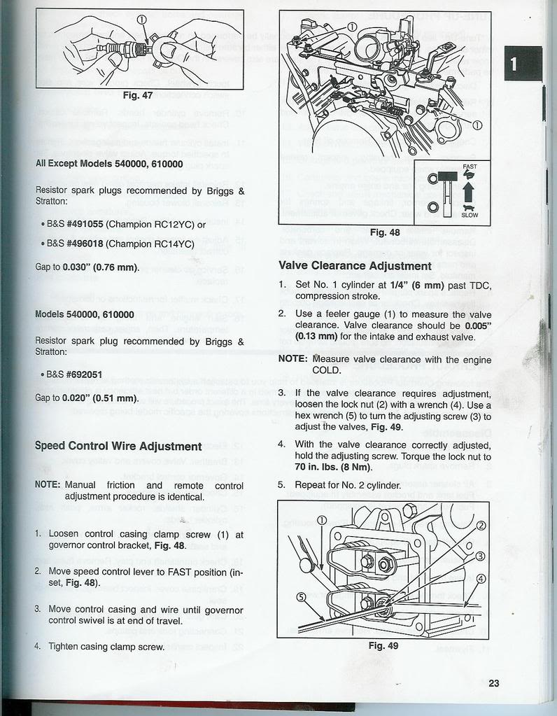

Meanwhile, back to the subject at hand ... SOMEBODY ... no need to say who ... told me to set my valves at .005. So I did and the thing backfires like danny farting. So, I checked and Briggs says .004 on the intake and .006 on the exhaust.
Mr. Knowitallandthensome didn't even tell me about one being the other.
Free help is so hard to come by these days!

Why would'nt you check with Briggs in the first place. ya da

Marty,
When I get home tonight I will scan some more photo's for you.
If you are still having problems with speed control, I think it will be the spring position on the govenor.

Look again CAREFULLY, Porky the above picture contains Figures 47, 48 AND 49, Dooooofus.
