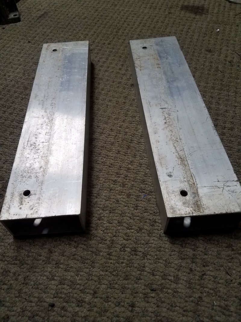

Just wrong.. If you want to take it out you use these..
Aluminum bolt them to the floor and then you can take the reel out and in no problem..:biggrin:
