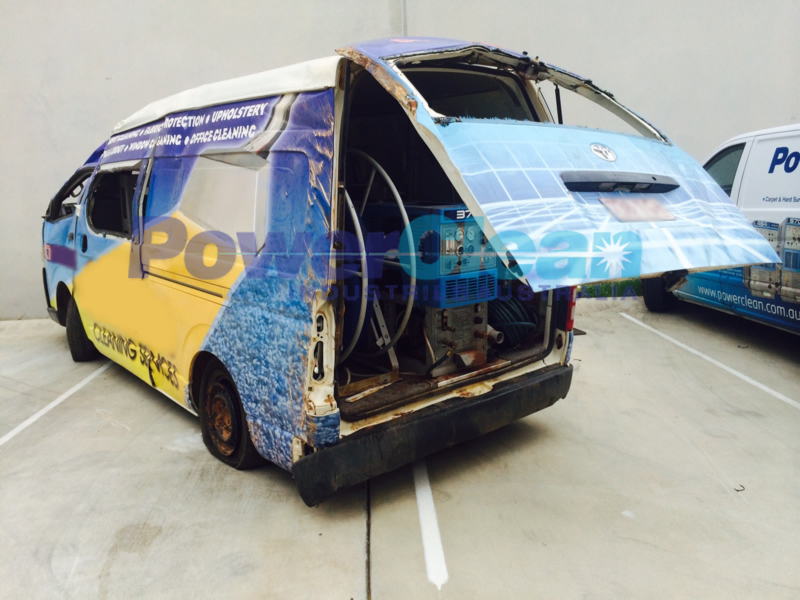

I have been checking out all the pictures of truck set ups out there on the O'l world wide web, and I keep coming across these companies in Australia with there SS or PC Everest in the back with there hose reels. Whats up with that? Is there a reason they do that there? Parking issues maybe? I must admit it seems like a space saver... I would love to put a hose reel next to my next slide in install, but... what about maintenance? How? ... and what about handling? All that weight in the back?

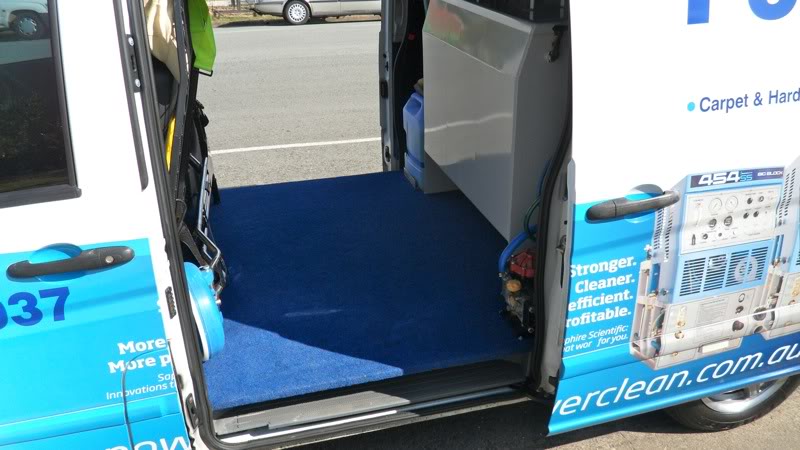

Maybe the Bethels feel that it's safer in certain vans...

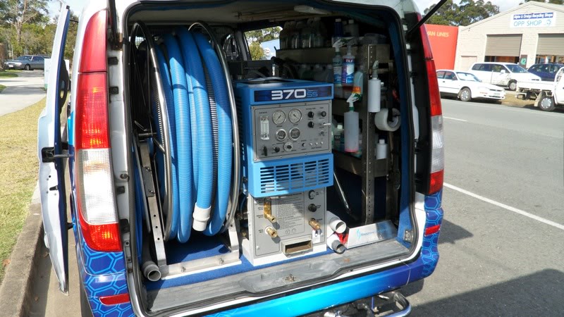

I think they are doing just fine, down under. I am actually planning out a very similar setup to Powerclean's demo Mercedes. Most likely would get the same Vito (Metris here) and get the SS370 installed. I think it would be a very very good setup. Efficient, good gas mileage, small footprint -both van and equipment- and looks good. In my opinion that is the type of setup that companies with several vans, should run.

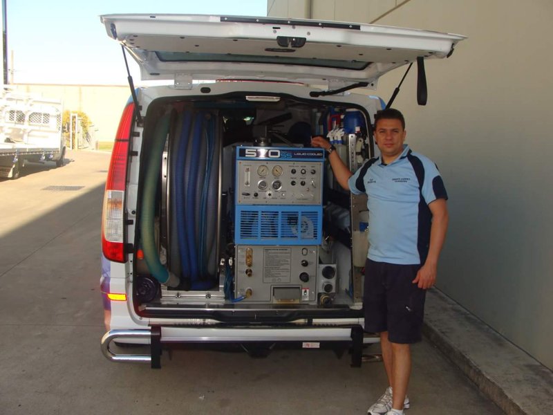

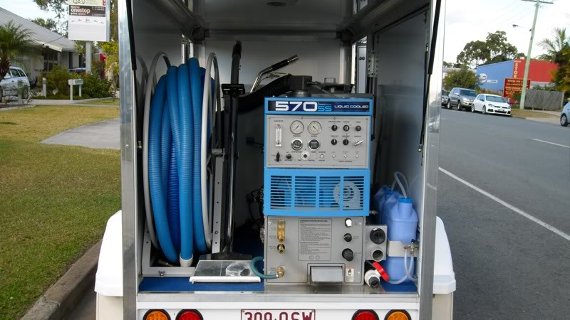

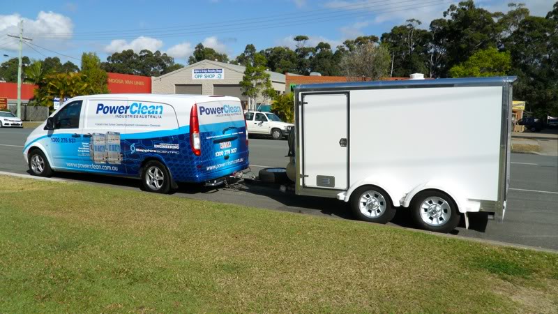

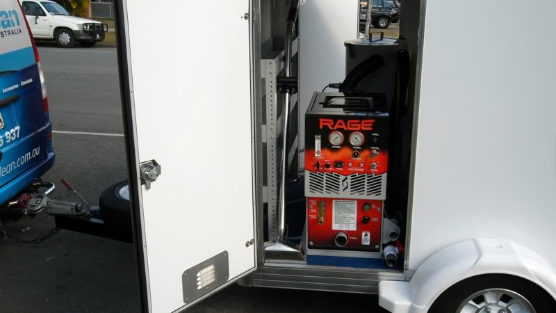

I really like this setup with the 370 and they can pull a trailer with two other truckmounts installed for demo.
In real life you could set up a van like that and for a backup, you could have a small trailer with a truckmount. Or when you have a large job scheduled, you hook the trailer up and become a true dual wanding van where you can run a trailer on one end of the building and the van on the other.
And there is this guy with a 570:
With all of these I wouldn't mind measuring out the 370 and the hose reel out the side door and leave the back open.
