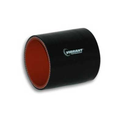

How about this one? It's 5":
http://www.xtremediesel.com/vibrant-2724-5-silicone-coupler.aspx

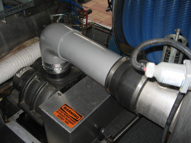

Wow. Super nice!
A little pricey though....
One of the reasons I went with it is I only had 3 1/2" of clearance to install it without removing the TM from the van and with its flexibility I was able to do it.
