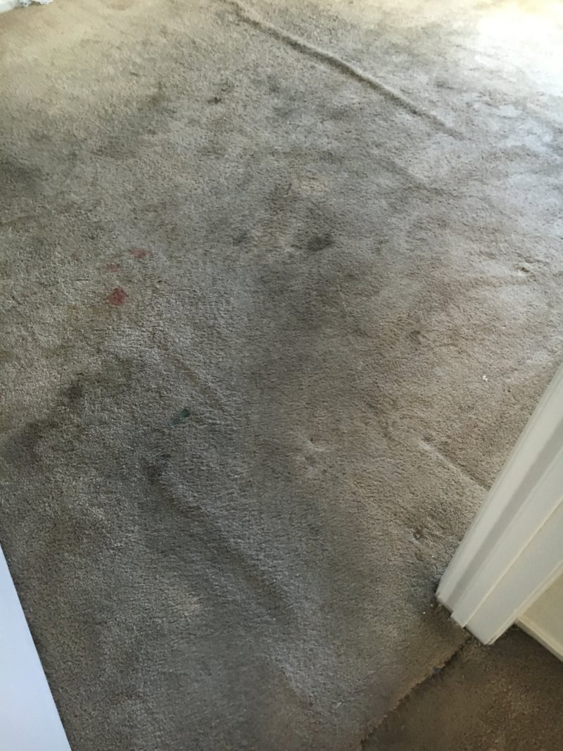

So many different colors in this carpet we declined to do the other day. On top of the urine and feces. If I was at your level I mighta attempted. :redface:
6,998
So many different colors in this carpet we declined to do the other day. On top of the urine and feces. If I was at your level I mighta attempted. :redface:View attachment 19293
You were wise to turndown that work since you don't do HWE yet.
But to be fair. It looks like the carpet is delaminating and should be replaced anyway.
