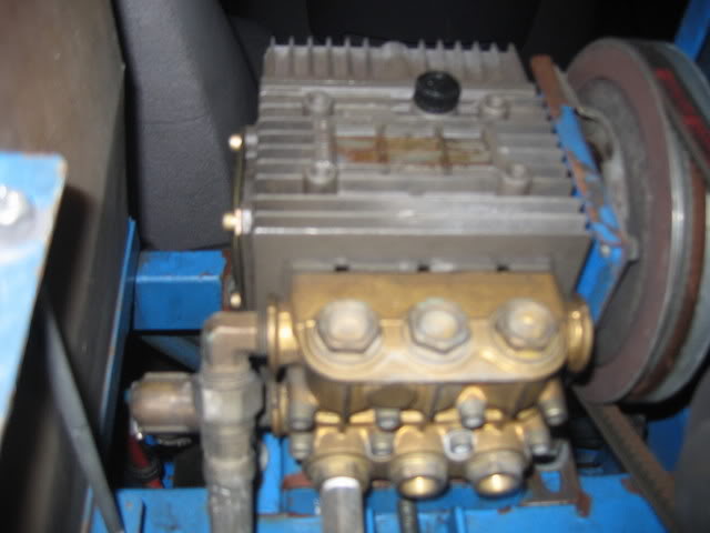

This is the water pump not sure what type it is
And the blower is belt driven
