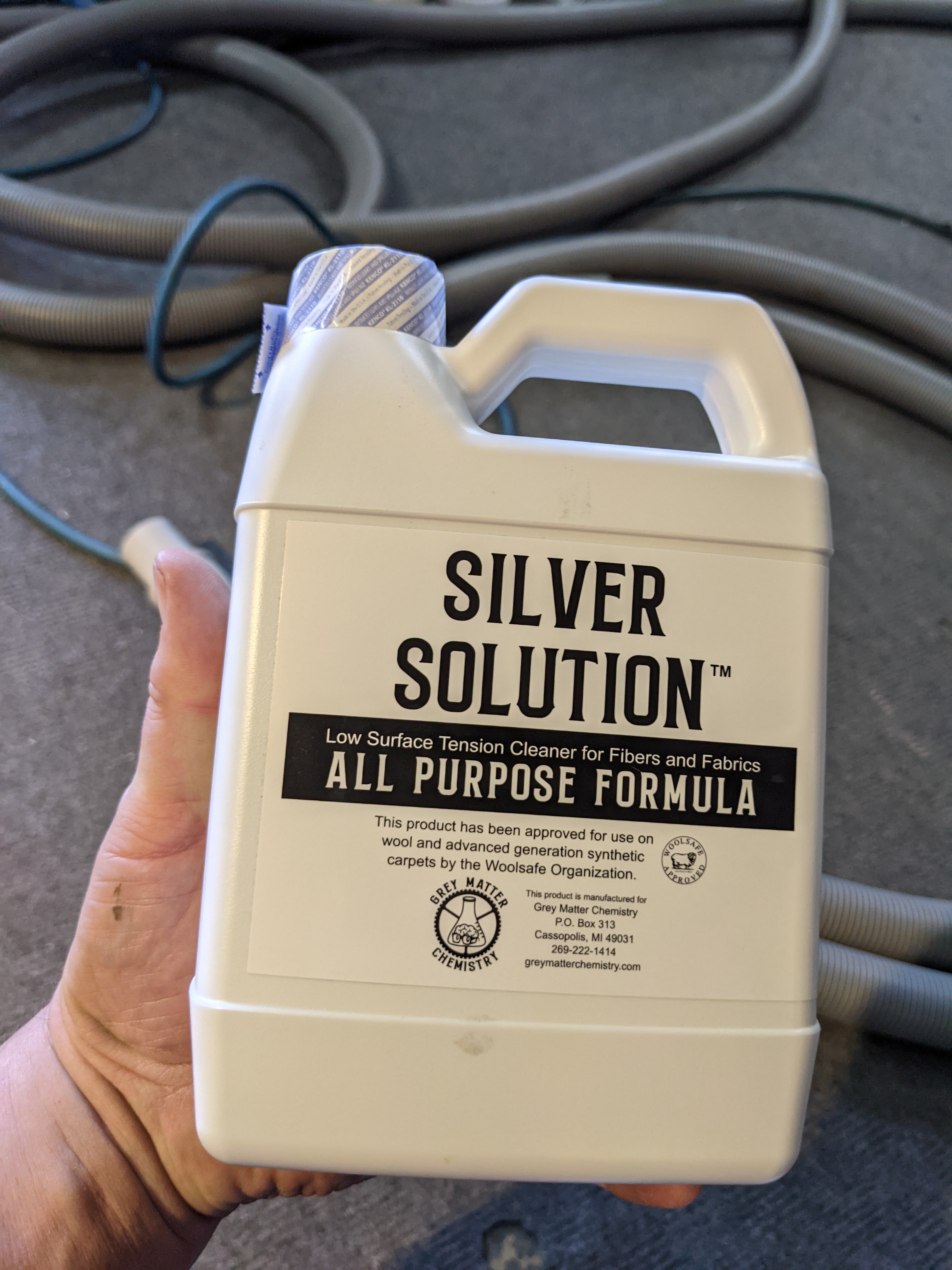

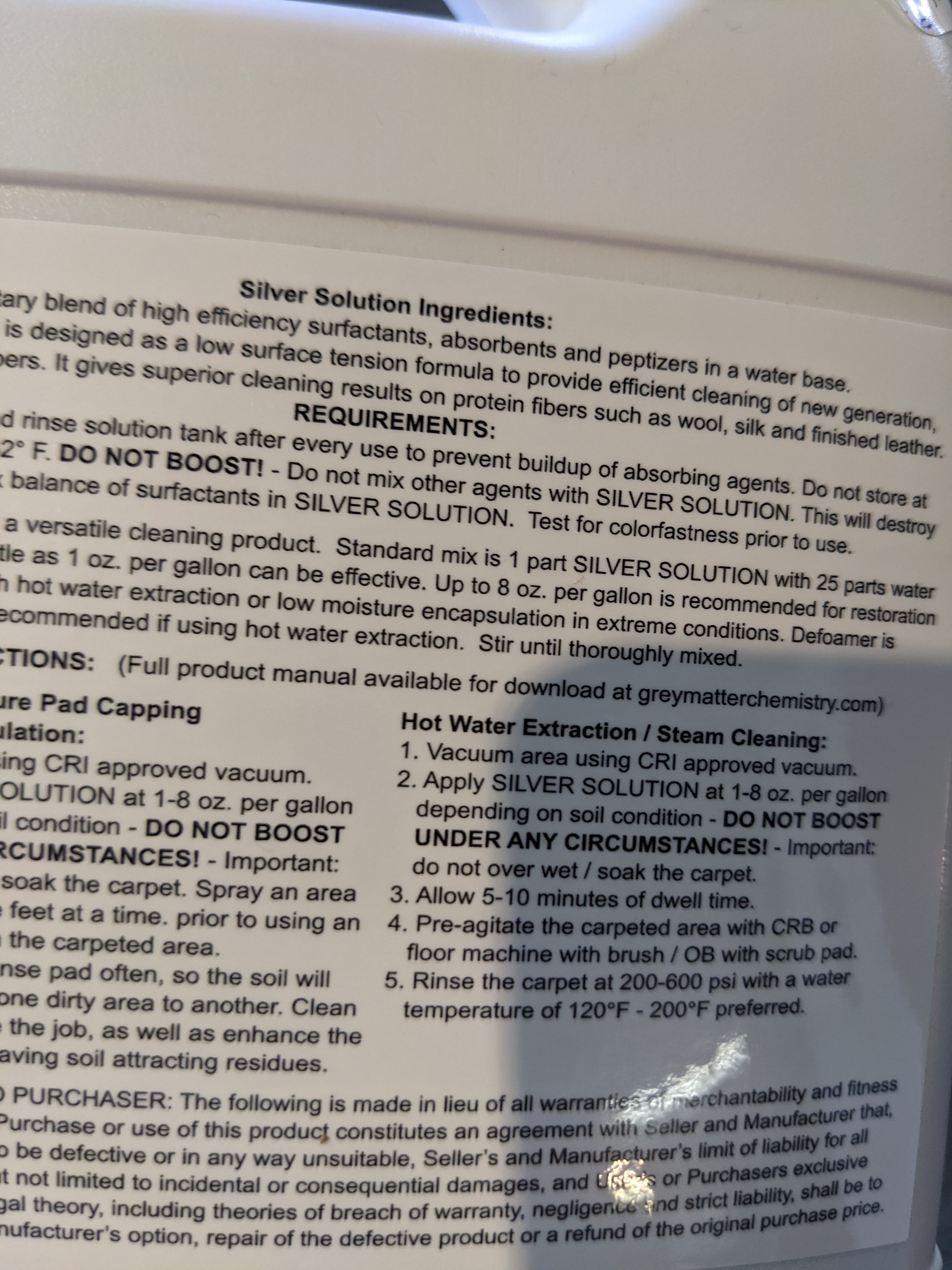

Received my sample today. At first glance it seems the same as LST. Regular dilution ratio is 1-25, same as LST. Does say that you may get results as low as 1 oz per gallon, we'll have to see. I have a small condo building to do tomorrow so I will try it out on that and see how it works. I am thinking about 20 oz in my hf at 4-1. What do think? Should I go more or less? Thanks Tim and Mikey. I'll give it my best shot.
View attachment 110242 View attachment 110243

These carpets are moderately soiled in general with a few heavy traffic areas. I also noticed that it recommended defoamer. I haven't noticed LST having foaming issues. For use as a prespray followed by a truck mount, do you recommend defoamer, or not necessary?

I don't run deformer
But when you release a product it's better to recommend for people to be on the safe side We've had no complaints of major foaming issues

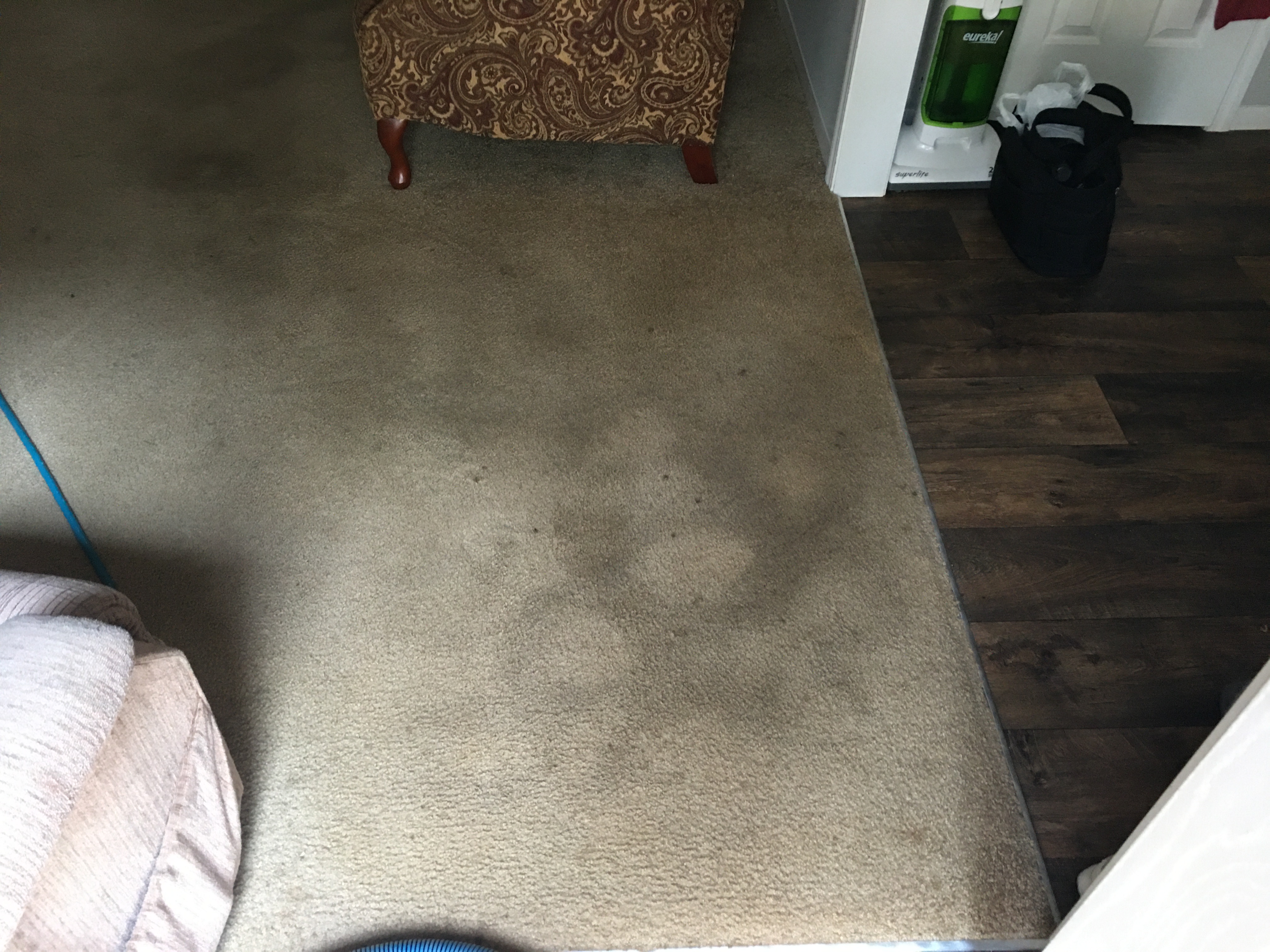

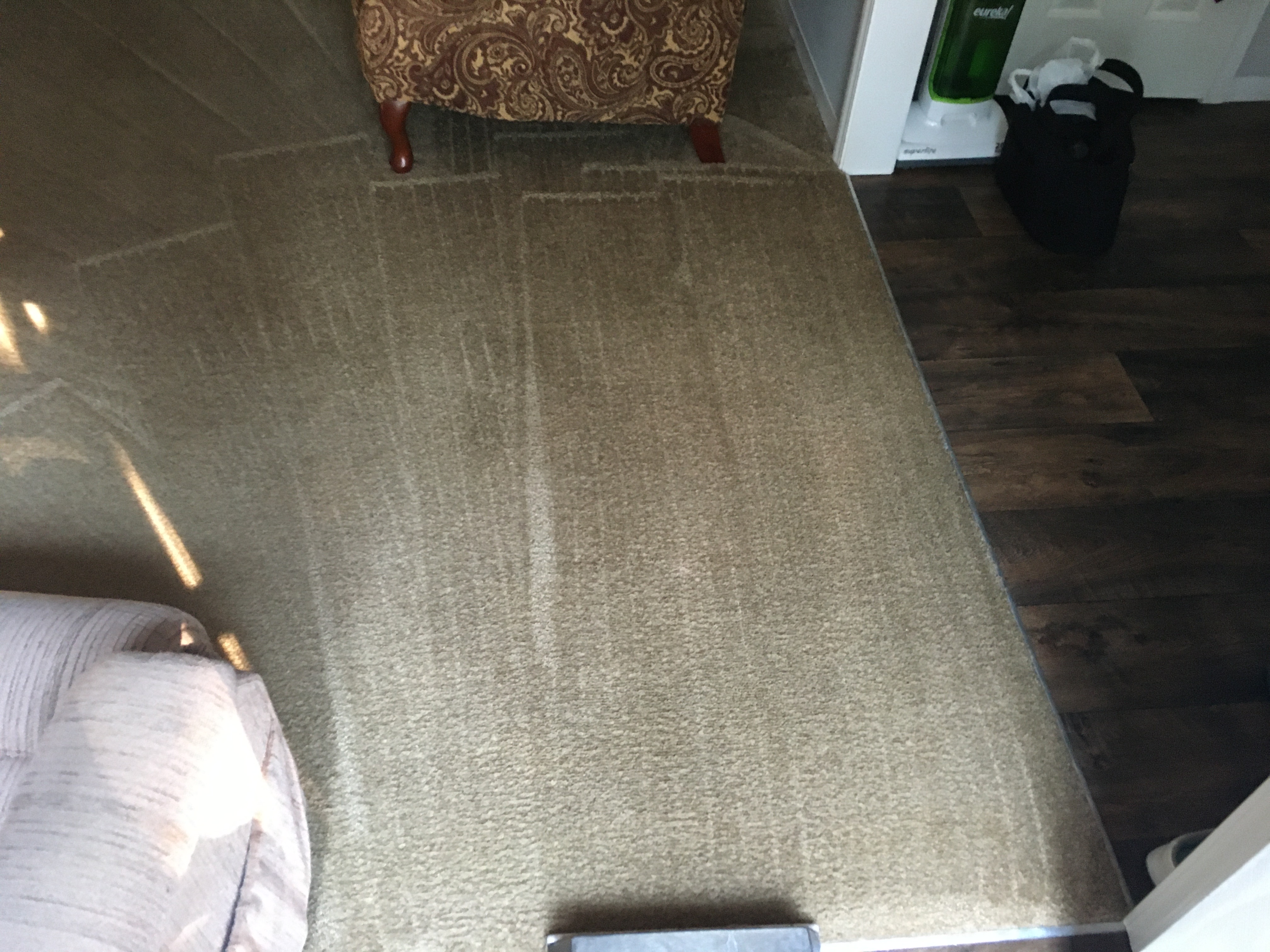

I forgot to post these pics yesterday
E6CE8F2B-459E-462E-9E37-90BC0360D8E4.jpeg 0CCE1CDC-2C38-4398-8CF3-792EAABD0B42.jpeg

I presprayed part with the Silver Solution and part with the Procyon. Seems like the Procyon works better and easier.
View attachment 110276 View attachment 110277
did you try anything on those spots you left?
:eekk:
a plain water conditioner out cleaned a wonder joose?!?!?
maybe Mike isn't qualified to judge juices for the commoner, now that he doesn't clean dirty carpet
