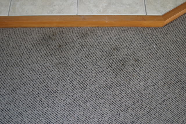

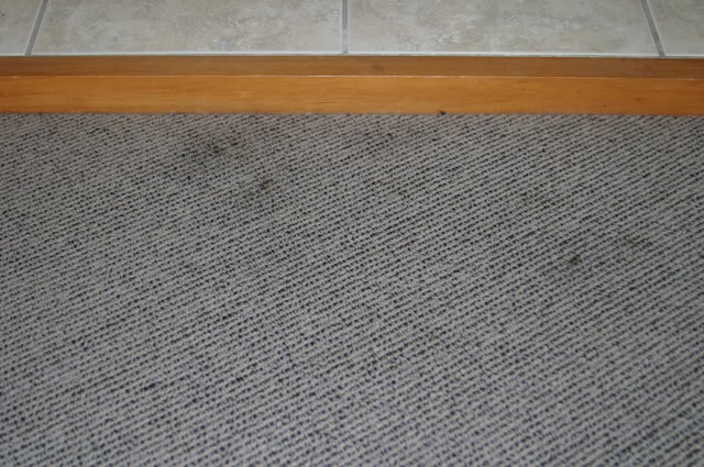

I inspected this job,
12 month old wool carpet with jute backing on cushion.
Log rolled out of the fire and left these burn and scorch marks.
The client tried to CLEAN the area with a wool approved product and left these darker agitated areas around the individual burns.
The client has replacement cover, but has a huge combo lounge/dining room. Because it is so new, they wanted me to tell them if I can get invisible repairs. I got out a section of their offcuts and there has already been some fade.
I told the insurer $300-500 and expect up to 2.5 hours max.
I have a bit of a plan, but thought I'd see what others suggest first.
There are a good mix of small burns affecting up to 10 tufts and then there are slightly larger surface areas with mild surface scorching nearer the hearth.

My plan is a bit vague, mainly coz they messed it up bad for me by 'cleaning' the carpet.
I'm hoping to re tuft the outer small burns then I thought I'd attempt a graft for the two larger scorched areas closer in toward the hearth.
The main problem is, they have stated categorically, that the don't want their carpet to look like a jigsaw puzzle. Understandable to say the least knowing the age of it, BUT, they are not even going to grant me a 1 month 'wait and see how it walks in' grace period.
I pretty much have to nail it the first time and only get 1 shot at it :shock:
I thought after I have repaired it, I intend cleaning the area to see if that'll blend their mess in with my repairs.
What do you say to that approach?

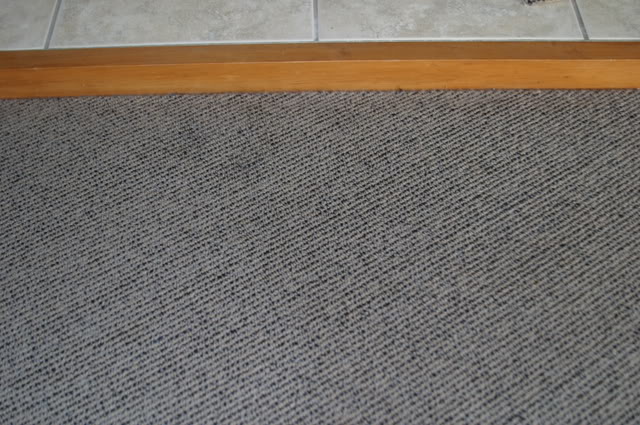

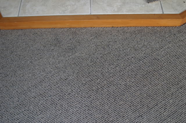

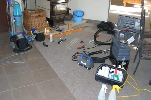

ok, just in from completing this job. 95% job and 100% happy clients.
Notice that the agitated areas have settled down a bit since the opriginal photo a couple of weeks ago.
Work in progress :shock:
Finished but the agitated areas are still highlighting the repairs.

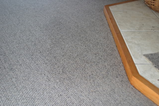

I cleaned the area and gave it a fairly aggressive rubbing with my finger tips to simulate the previous cleaning and then rinsed the entire area and lightly groomed it. I also lightly 'coloured' the darker areas to tone it down slightly.
Other side angle, notice the slightly darker area that is still damp.
I've asked them if I can re visit in 2 weeks time. There is one small area that I have a bit of concern about but I was out of time for both the client and me.
