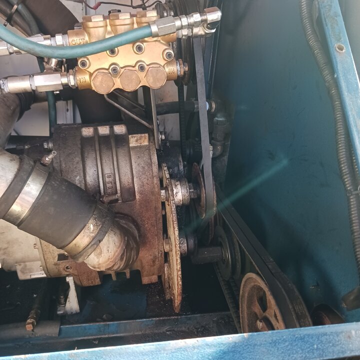

That's cool Dwain-o. I really like the adjustable belts with the idler pulleys, and the simple driveshaft construction. I will challenge you on something though, I think this CDS 4.8 is even more accessible than your sexy Steam Genie. If we consider removing your panels on par (or close enough) with removing my driver and passenger seats, then it seems to me my layout is way more open and accessible as it is spread out across the space between the driver and passenger seats as well as about 20" or so behind each of those seats, like wide open, rather than stuffed in a box. I'll remove the seats and share some pics tomorrow.

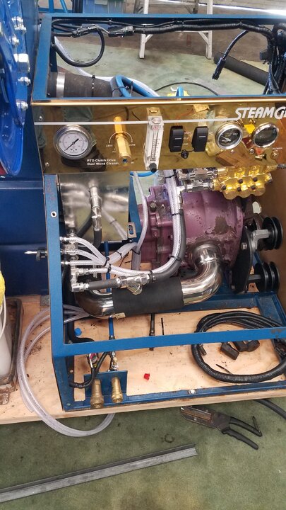

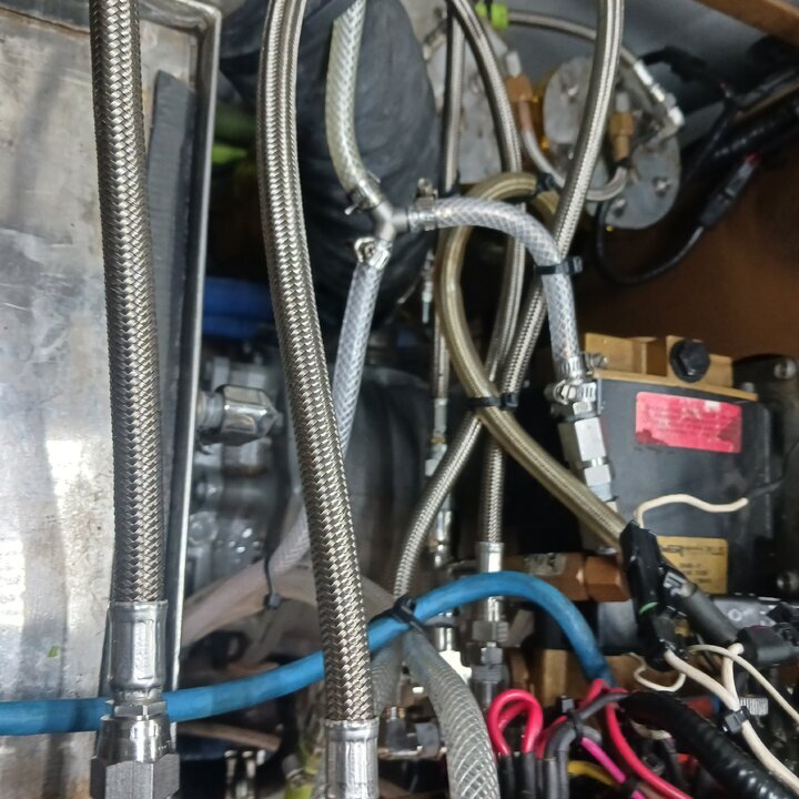

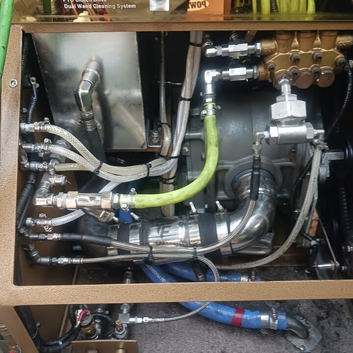

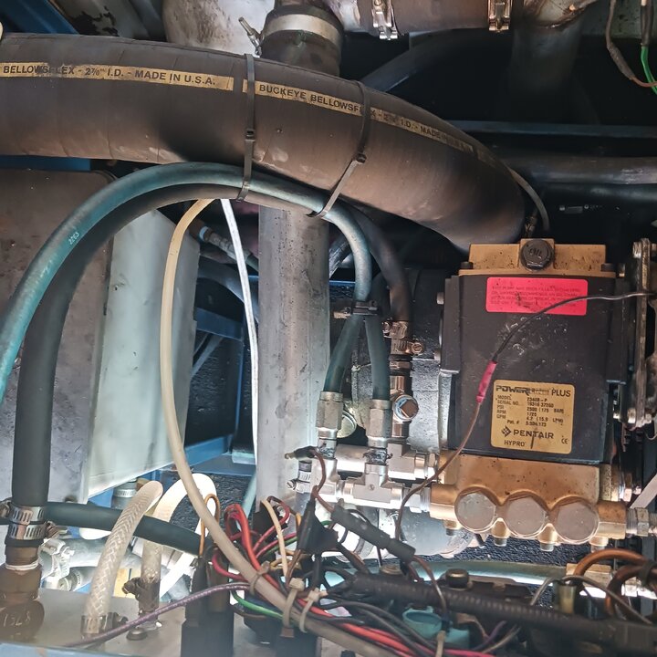

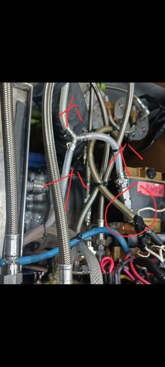

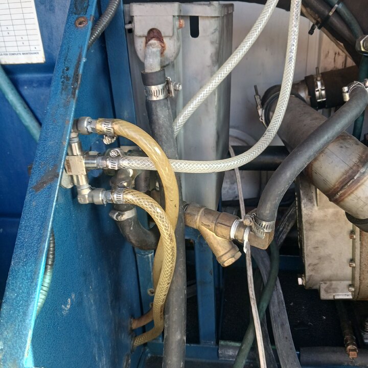

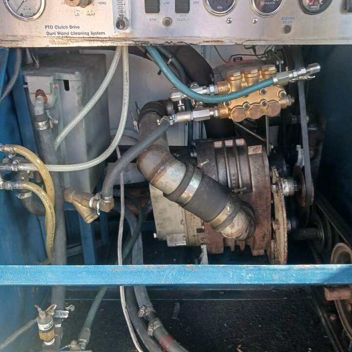

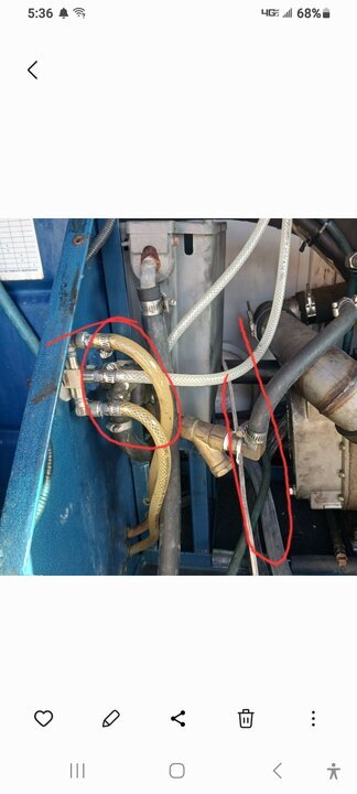

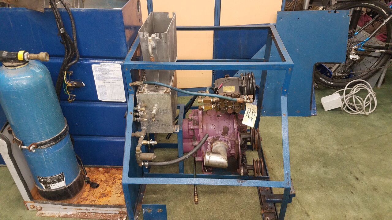

Heres what the insides of a "near original " steamgeni pto looks like the 3 hose valve on the left (red outlined) is chemical tank selector (not stock ) and white duplex wire is waste pump other than that its a stock 2000 steamgeni pto with 10,363 hours as simple as a powerful machine can get 3 belts 4 hoses a pump n a blower 3 tube and shell heat exchangers a lot of open space still in a 3×3 box tucked behind the drivers seat
20250906_173314.jpg 20250906_173425.jpg 20250906_173446.jpg Screenshot_20250906_173641_Gallery.jpg
View attachment 132463 View attachment 132464 View attachment 132465 View attachment 132466

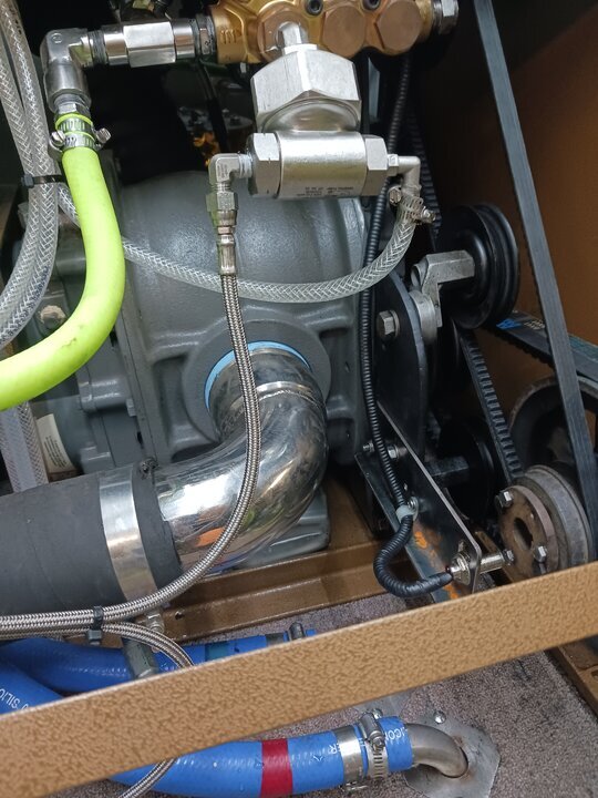

Here's a side by side Frankenstein vs near original
20250906_173446.jpg 20221108_170827.jpg 20250906_173425.jpg 20241109_153921.jpg 20250906_173322.jpg 20250208_160041.jpg 20250906_173314.jpg 20250208_160041.jpg 20250906_173425.jpg

That's sweet Dwain. Thanks for the pics. I like simple!

Your a badass mechanic Dwain. Your machine looks so much cleaner and kickass than the original Steam Genie!
Keep in mind your comparing a 3 year old machine with 1,400 hours on the clock with one thats pushing 26 years old with over 10k on the clock. There's alot more shit in frankinstiens box, last step chemical injection, thermal relief waterbox overflow drain , high pressure cleanco & salsa heat exchangers tachometer and shaft sensor . Remote start/stop pump or enitre machine,dual chemical tank selector. Dual wastepump float switches with auto and manual with auto stop. Remote excess blower grease collection. But most importantly everything including control panel is all compactand accessible in a 3×3 box . I will have to admit, theres alot more space to work in the original. But just like cars today the more features the less space. Compared to some of the shit ive seen on the market for what frankinstien is and does he's still very very simple and easy to maintain

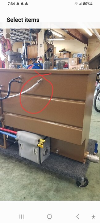

I installed a 140° thermal relief in frankinstien where the bypassed water reenters the pump the pump pumps cold water but when im not using it the bypass regulator recirculates back into the pumps inlet and as it's recirculating with each pass ot heats up so if or when it reaches 140° it dumps into the wastetank using the same hose y'd off from the chemical pump prime i also added a check valve to prevent air from entering thru the thermal relief in the pictures circled is the thermal relief (brass) with check valve( stainless connected to hose) lower left hose is chem pump discharge top is to waste tank
Screenshot_20250906_192423_Gallery.jpg Screenshot_20250906_193410_Gallery.jpg

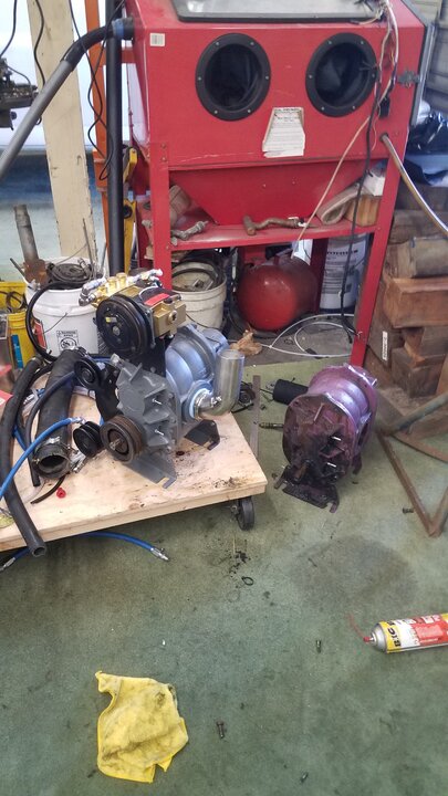

My blower is a roots 47 47 is the model stands for 4" gears 7" lobels its rated to run continuously @ 3600 rpms . Most companies that build machines don't run blower at max rpms for a couple of reasons #1 noise at 3600rpms my blower screams! #2 is heat i know that cleanco runs there blowers at 2900 to get more heat outa the blower heat exchanger so when setting mine up i went with their recommendations. My spare machine is simply set at engine rpm of 1350 steamgenis recommendations never bothered to check blower speed. (No blower heat exchanger on the spare). As far as maximum vacuum lift on your machine. I couldn't tell you all my experience is with sutorbilt and roots blowers. But a lobed blower is positive displacement and with no vacuum relief theoretically should continue sucking and pumping down till eighter something breaks, belts spin ,engine stalls or tank collapses . the vacuum relief is or should be set at manufacturers recommendations. Roots says 15 i set @16 im only 6.5% over and should be ok. My old 47 (retired 47 pink, used for mockup of frankinstien) originally came new in a 1991 steamgeni pto and is 34 years old. Used in 3 different machines before retired and has oner 17k hours on it running @ 16" lift. It still runs. It is shelfed as a spare, it started to have a slight knock and is the reason for retirement. If it weren't for that it woud have been rotated back to service in my spare machine replacing the sutorbilt 4m (roots 45 equivalent)
