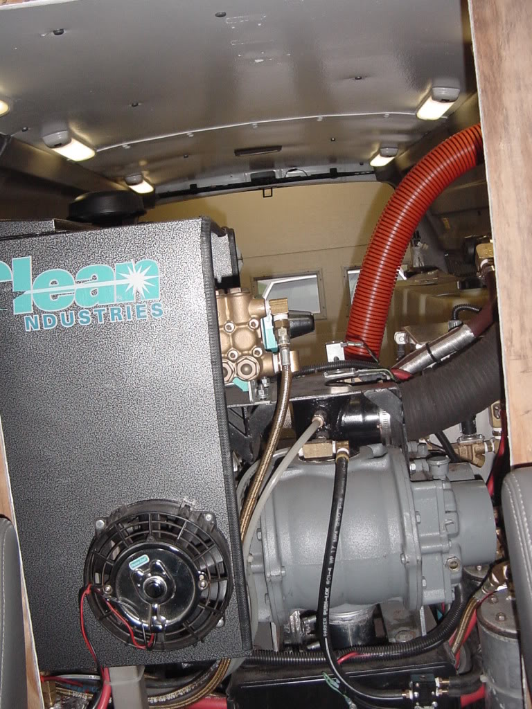

I've thought for some time that the Genesis would benefit from having the radiator fan exhaust out of the vehicle. It would keep the heat of the belts and blower. The radiator wouldn't clog. And I'd imagine that air filters would last even longer.
I've considered changing mine out but haven't asked PC if they would have a problem with that. I think the part would be less then 100 bucks.

Same here, Walt. The best cooling option to me would be to have a van with cargo doors on both sides. That option wasn't available when I bought my Chevy 2500 extended back in '03. It would create a nice air flow over the Genny, and out the other side. I do use an exhaust fan to help now.
Meat....I gots a cherry picker. If I did any work on the Genny, I would pull it out of the van.

Meat.....the fan does draw air in from outside the van, but as it passes over the engine, diverter box and related exhaust parts, it gets pretty hot by the time it blows over the belts and blower. It is the one design flaw in the Genesis that only gets worse in the summer humidity and heat.

I can dig it, RW
but it would get even hotter if the fan wasn't blowing on the engine and components
WAY hotter as a matter of fact.
turning the fan around to blow out would create bigger problems if you didn't add another fan (with substantial CFM) to blow across engine and components

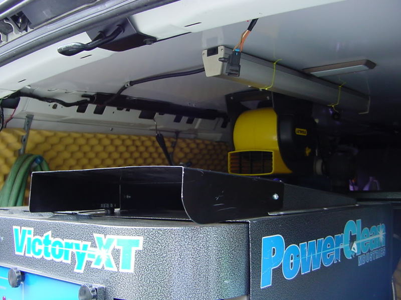

I'm not sure how the Genny is designed but my Victory has much of the same problems. This is what I've done to this point to help cool it.
There is an electric cooling fan on top of the unit which was set up to blow down onto the belts. I reversed the motor direction to take hot air out of the compartment. Then I extended the cowling to get the hot air out of the van. Hot air rises and it seems to me that its better to pull that hot air off rather than blow it back down onto the belts.
I the bought a small electric fan from Summit Racing and mounted on the side of the unit which blowss directly on the blower belts. I wired it to one of the auxillary switches on the front panel. When I turn it on you can actually feel the air coming out of the cowling get hotter.
I previously had this unit in a van with doors on both sides and the extra openning had little is any effect.

Shane....I'd be proud to have such a clean machine! You must take some time to wipe down the unit??
I use an electric fan from some car one of my sons was tearing apart. I still would like to intercept some of the hot air before it reaches the belts and blower, and exhaust it out.
