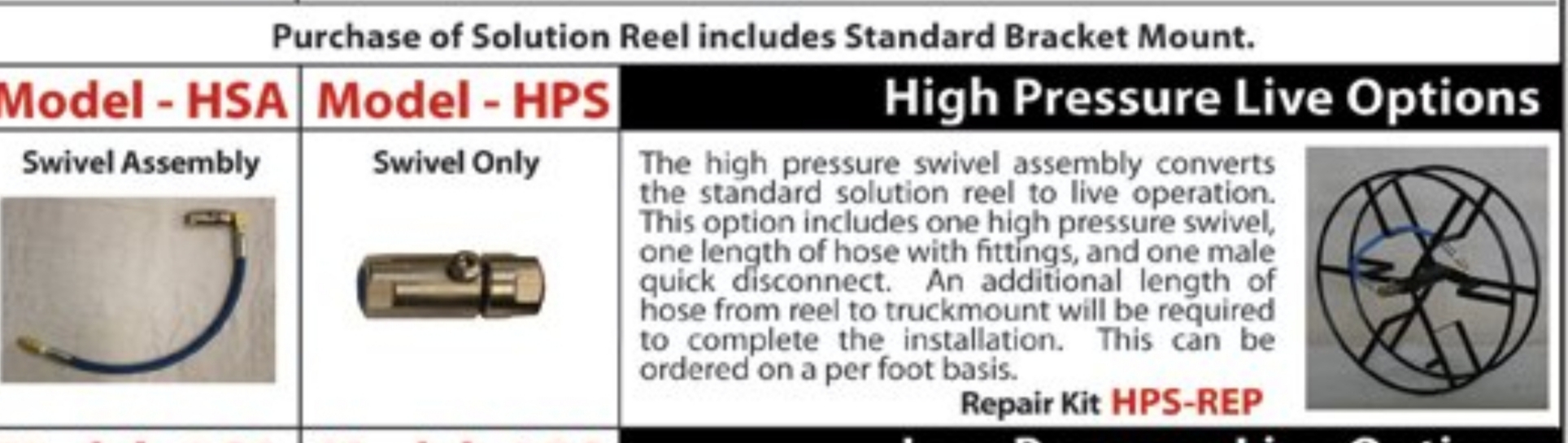

I'm considering converting over to live solution hose on my reel
14,347
Georgia
My main concern is how often do you replace that 250-350ft of hose? Because I replace 1 section of my hose 75ft once a year. If I have to replace all that hose every year... no way
And where can I get the hardware to convert it without getting ripped off $$$

300ft in multiple 75-50ft sections that I have to disconnect from the reel and connect to the machine. I'm wanting to do away with all the crimps and QR's and just run one long 300ft. hose on the reel and have the hardware to make it a live hose always hooked up the machine.

Matt, this is how I do it and it's not a problem. I Have two lengths of hose on my live reel. the first section is 150' then the second section (Lead line) is 100'. Normally 10 wraps around my arm is enough to do 95% of my jobs.
That reminds me, I need to rebuild my Super Swivel. It started leaking yesterday.

Rokan had a conversion kit at one time.
