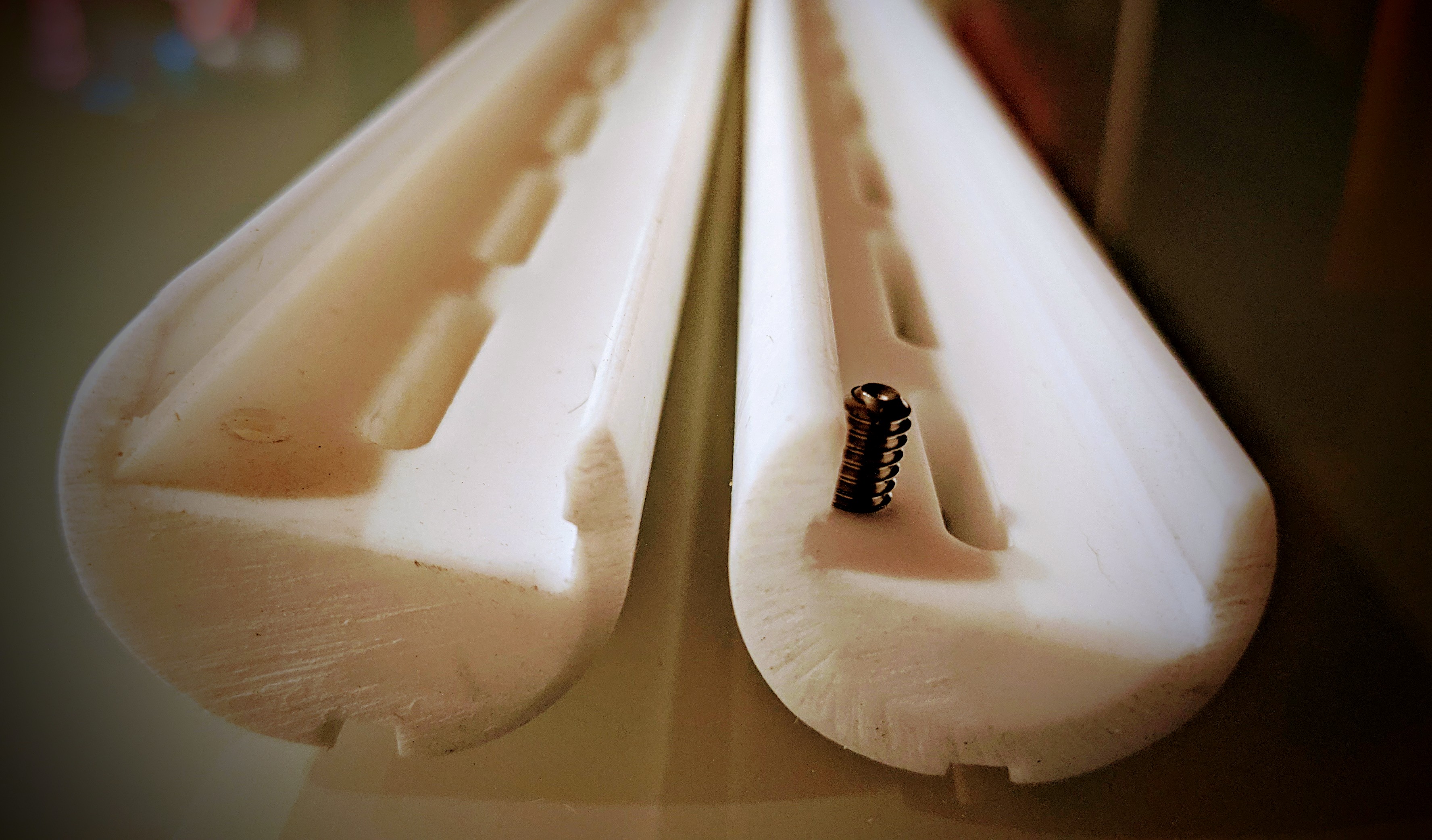

Im quite proud of these beauties...
117,010
Evo's.
Papa John was a big help.
Probably our most perfect Glide.
117,010

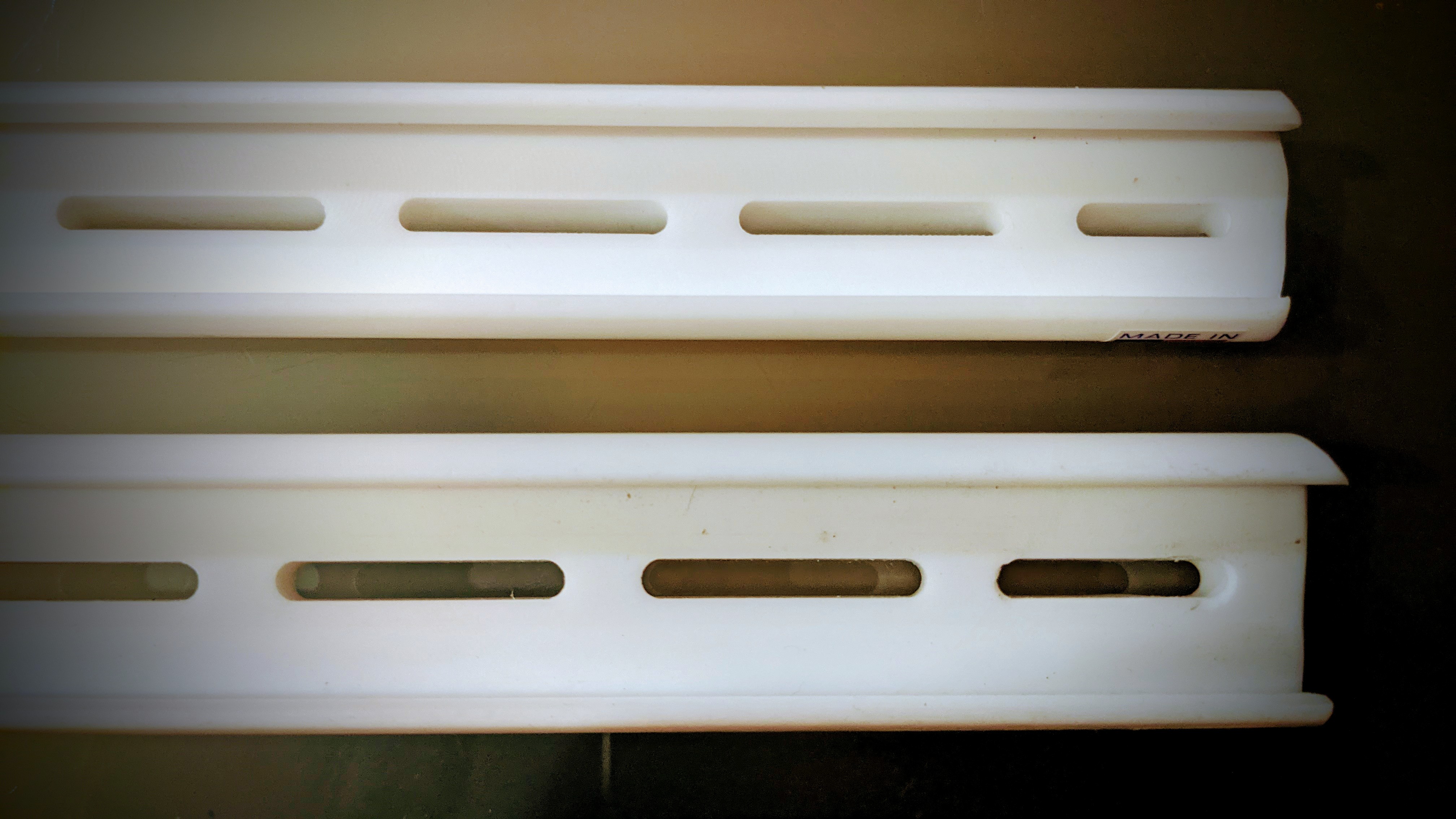

Why is it no one likes straight slot across...
I'm not a fan of stopping to clean a wand opening orifice for no gd reason...
Straight slot,if clogged butter knife crap out keep moving...
We want the Teflon slide,the holes an slots make no difference.
One step forward two steps behind...
Where is data on slot,hole,straight air flow results...

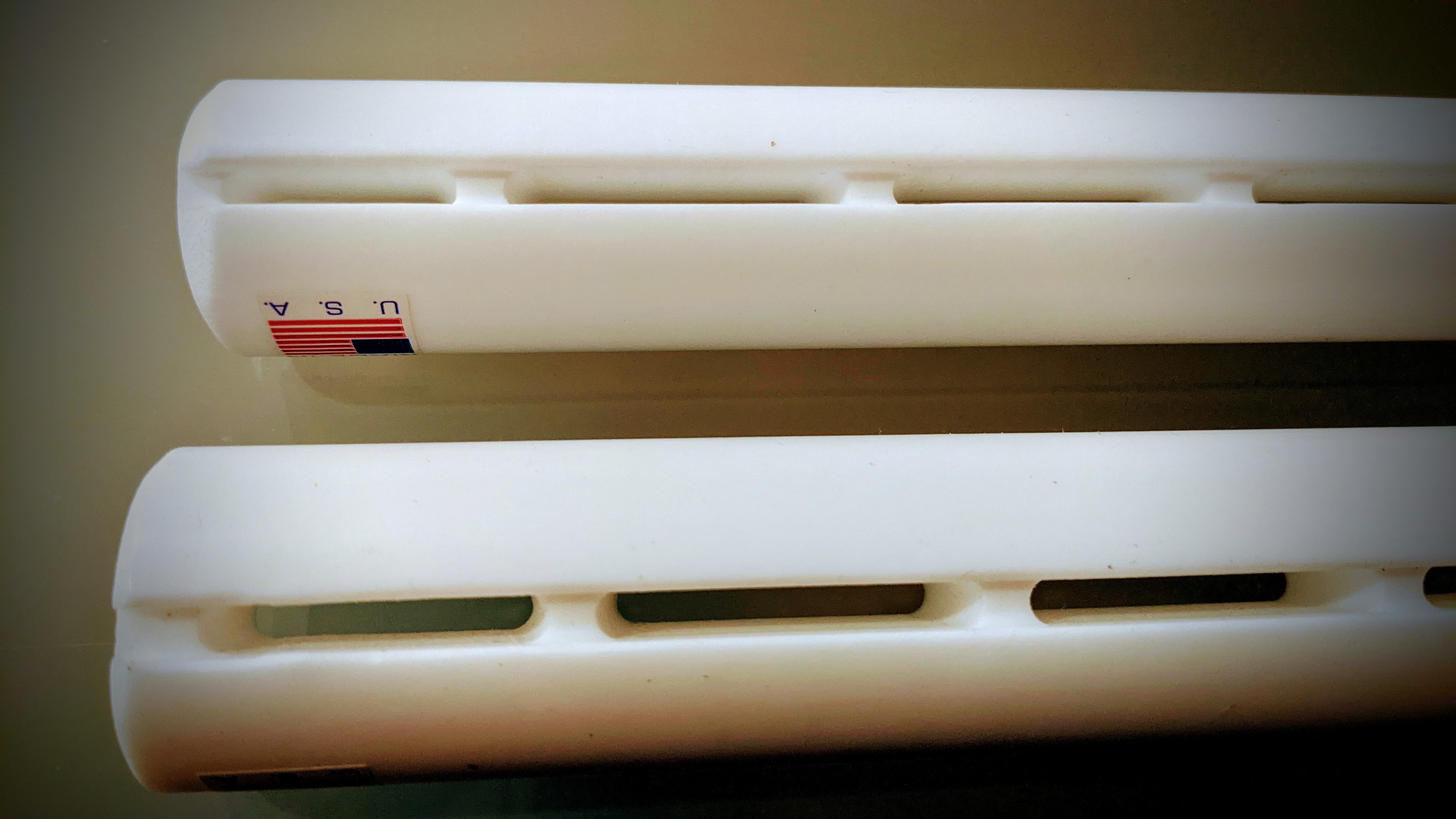

That is our "slot" glide
Bridges are necessary for strength.
It's our best selling option by far and away.
Holes are good for super dense piles, Rugs mostly, especially when there is no one to stand on a corner.
Marty likes a hole because the Devastator slot glides suck.
and he's a gimp.

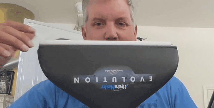

7,004
It's a nice glide.
I was skeptical of the water recovery due to its narrower slot- But the Evo wand with this glide seems to remover more water quicker than my Dev wand.
It's now my go-to wand when I don't need a swivel.
The wand did stutter sometimes on some carpet at first, but after doing a couple of homes it stopped. :biggrin:
I only use a hole glide on woven rugs when I need less suction.
