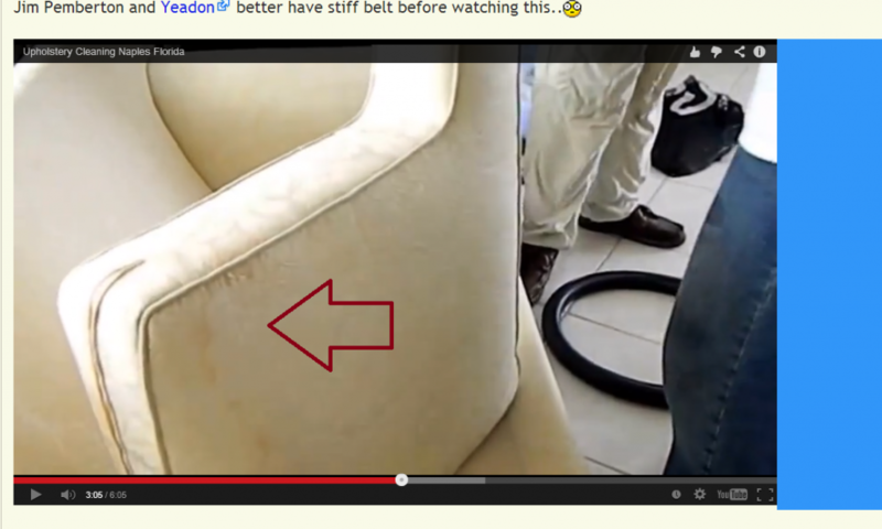

Jim Pemberton and Yeadon better have stiff belt before watching this..:eekk:
http://www.youtube.com/watch?v=JHgSkmDJCjA#t=58
So here this guy in Naples Florida is trying to optimize his site with all these You Tubes to a high end client base. Naples if you have not been there is a community where almost every house is on a water channel and has a nice boat tied to the dock.
What retired Jewish lady in her right mind would ask this idiot to come clean here cotton Davenport after watching this Rob Allen School Of Overspray drop out soak that poor thing.
I was almost crying just watching it.
I could never be an IICRC instructor. I have zero tolerance for retards.
and yes. I've Hydroforced a few sofas in my day but with far more skill ,no lance, over a tarp or carpet, low pressure and certainly not a white cotton already stained and wrinkled...
and certainly not on fooking YOU TUBE!
Speechless. :numfi:
Reactions: Mark Saiger
:eekk: Hack work at it's finest?
Actually he wasn't doing that bad a job cleaning. 1. NEVER...NEVER use an injection sprayer on a nice upholstery piece unless you're willing to have it in your home.....once you buy it.
There is just no control of your precondition. Even if there was you're using carpet precondition on upholstery! BIG no no! Carpet precondition is designed to penetrate, you don't want that on upholstery.
No drop cloth or plastic tarp, even if you're doing the floors, you risk cleaner spots on the floor where over spray could be working away while you doing the upholstery.
He isn't holding the fabric tight with his non cleaning hand. Some day he is going to do that to a fabric that weakens when wet and he will tear the fabric. He is also not paying enough attention to the trim when dry it's going to look like Ofer in a brand new suit wearing .....dirty tenny shoes. :p
The spot appears to be protein, needs a protein spotter and cold water rise. Hot water makes removal harder. Hopefully he prequalified the job because he just left that cushion with a halo around the spot and will look bleached out when dry.
All minor stuff but any or all could come back to bite you. :icon_cry:

The problem is that this is the norm. This customer as well as probably 80%+ will be "happy" for the $60 he is charging to clean it. Very few customers know the difference or even care to have it cleaned for $140 and correctly. I just had this conversation yesterday, "cleaning is cleaning". :oldrolleyes:
12,319
The skirt had already shrunk from GKW, and I would have to think it would look worse when it was done being bathed like that.
The Drimaster Tool was a nice idea, but if you use a cleaning tool that won't wet the back of the fabric after having applied the prespray so heavily that everything soaked through, there was no way he could neutralize and rinse the prespray out.(assuming he was using something that could neutralize the prespray)
That spot was something water based, and the way it started to spread, I think it could have been removed with the right amount of attention.
