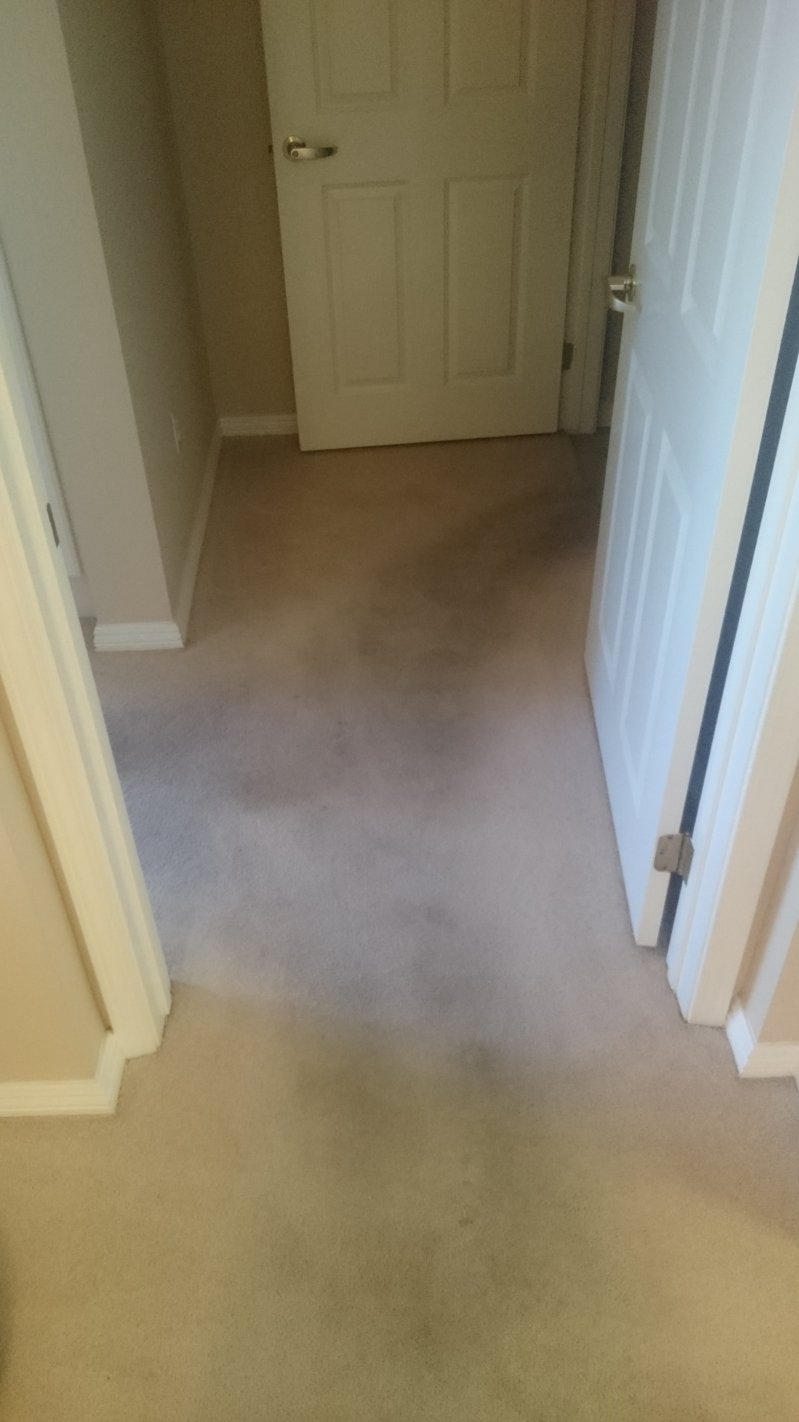

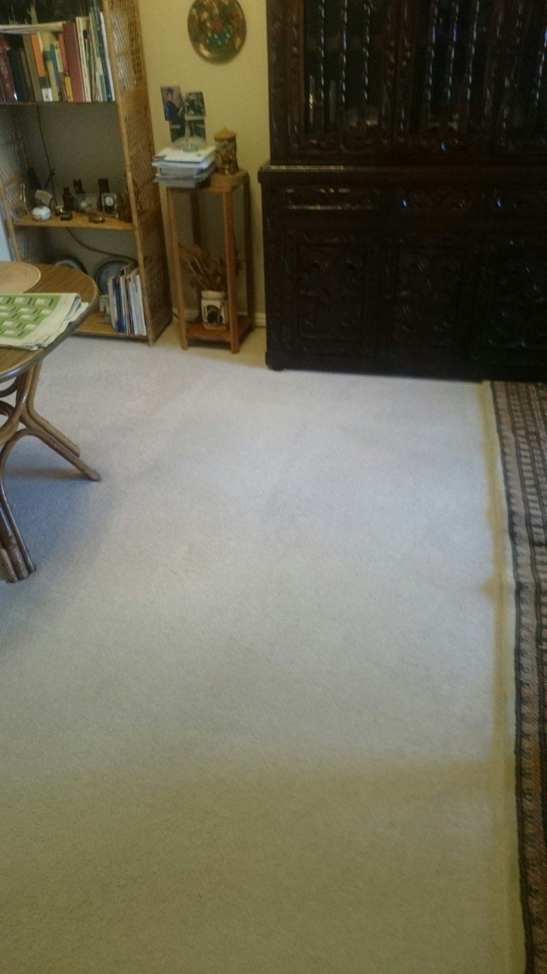

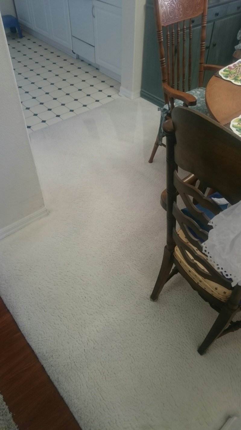

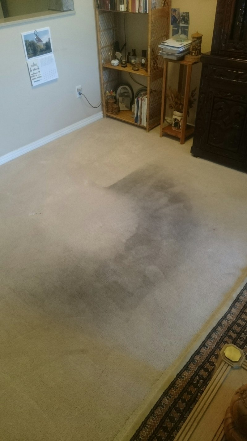

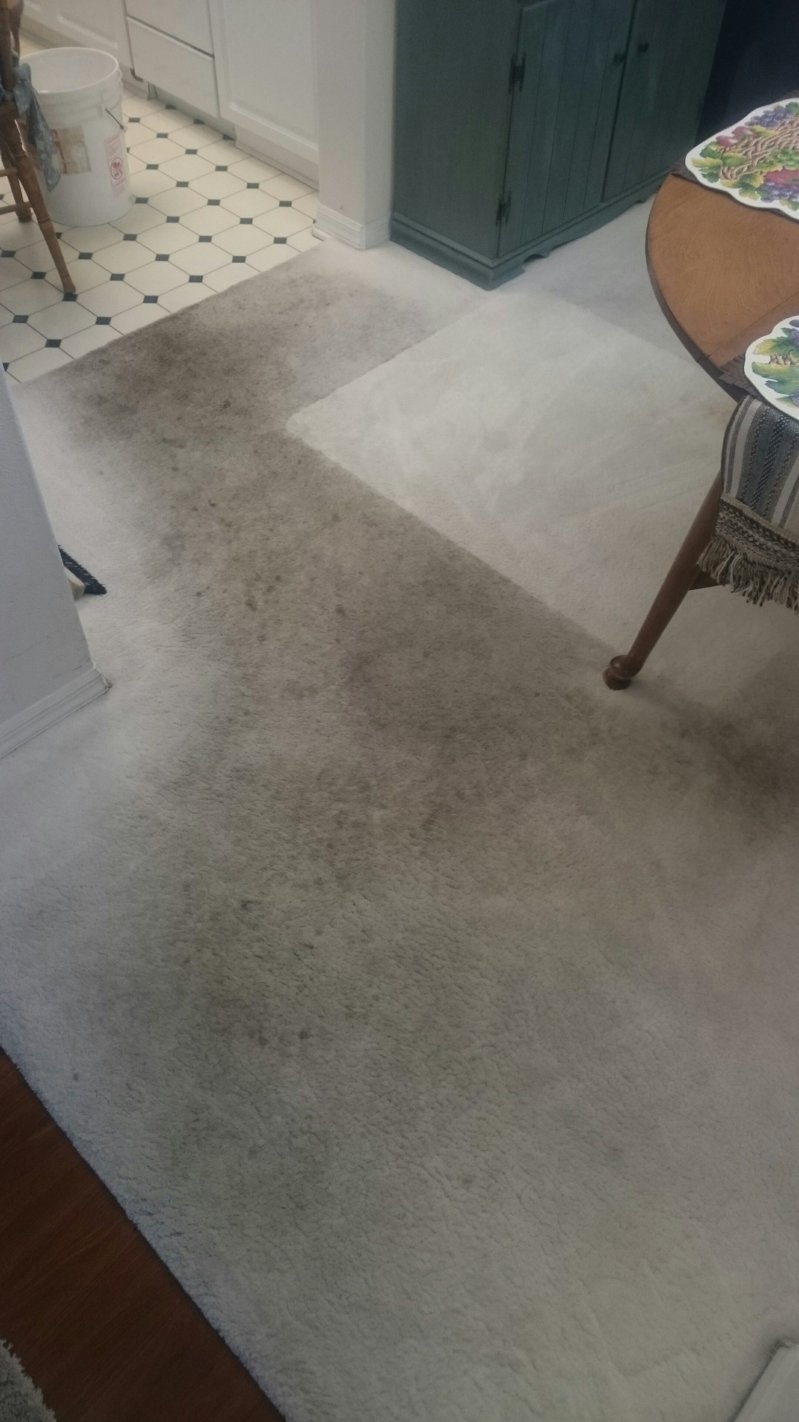

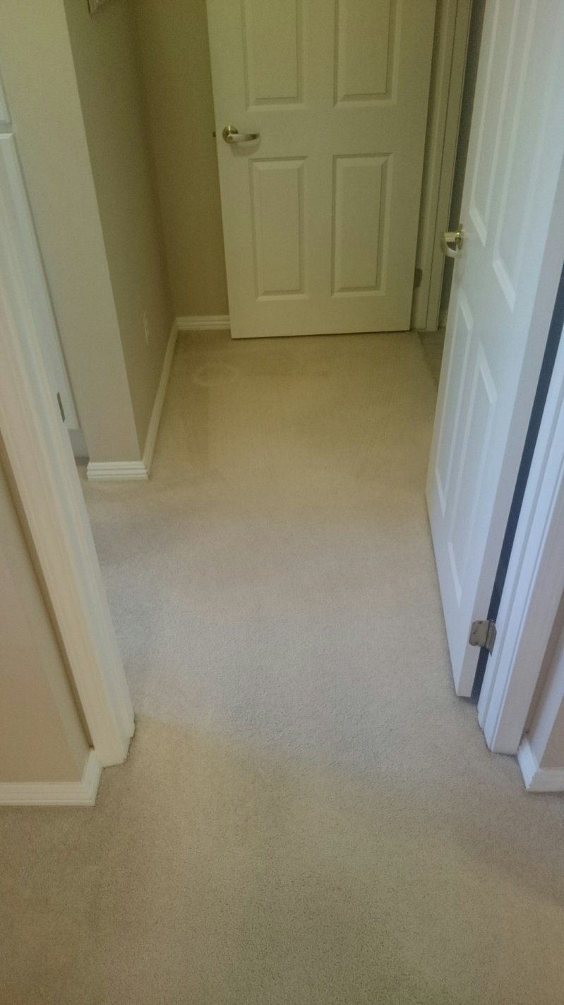

I didn't have the CRB nor the Dwellpro.... And it is not truckmount accessible.
So just padding.... With the 360XL.
The whole place looked like this. Two bedrooms, living room, dining room and 2 weird long hallways.
Thick white carpet...corn rows every inch.
