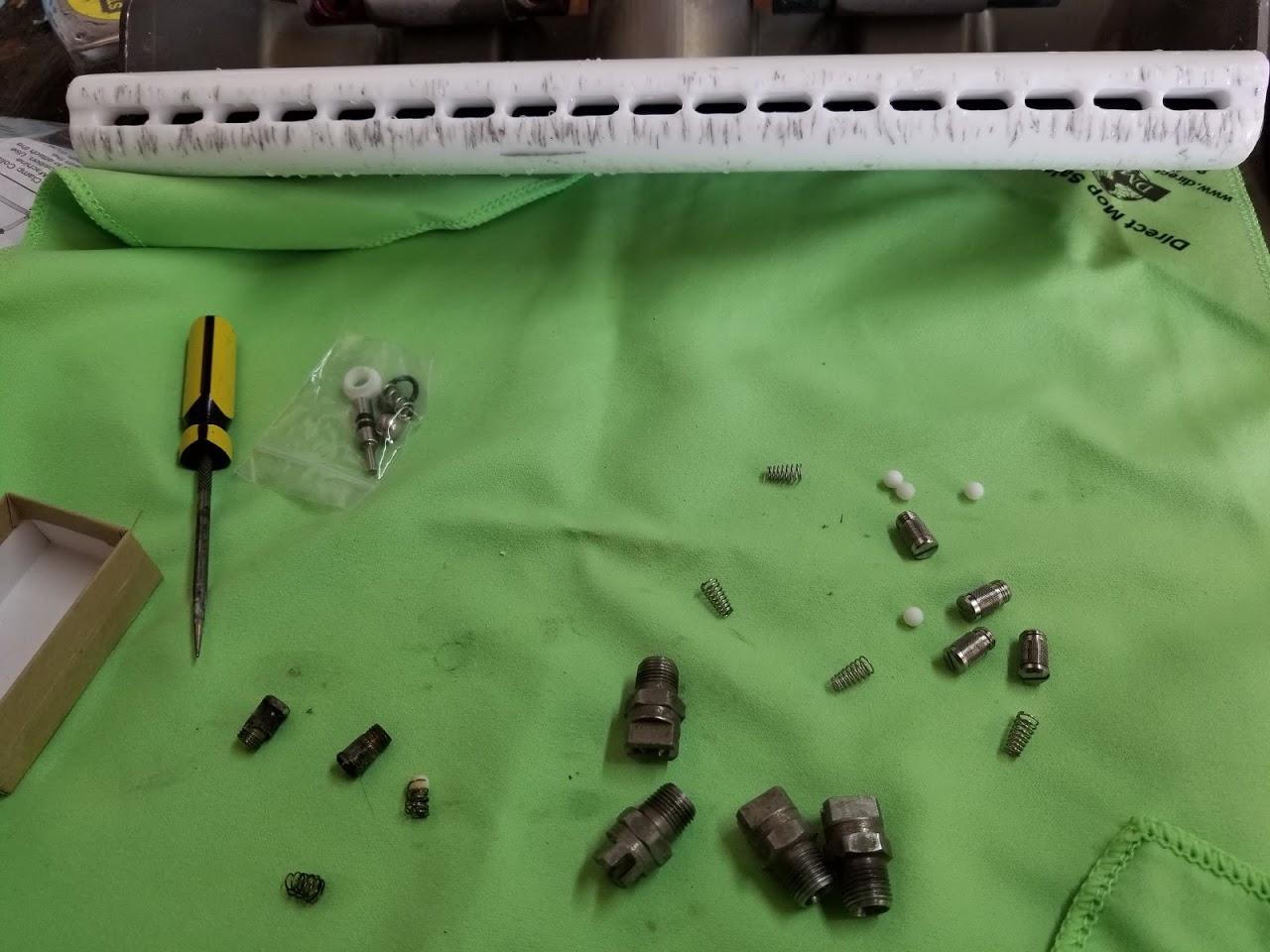

i took out the wand jet filters, upped the flows from 1.5 to 2flow jets (making my wand 10flow), and installed an in-line filter after my soft touch valve, as well as before like always
Since I’m now using 10fliw on my wand, should I increase or decrease my water pressure?

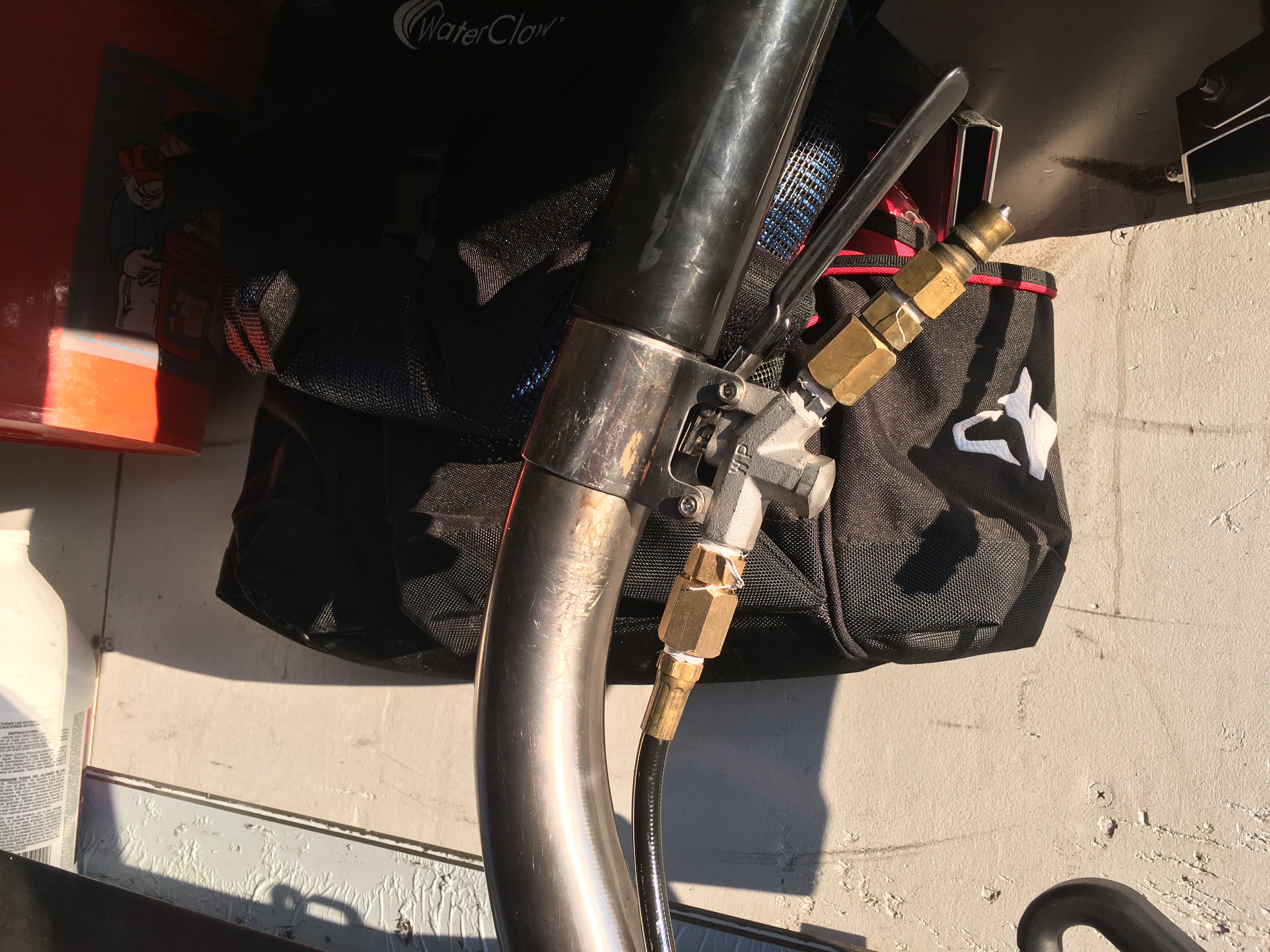

I use a 100 mesh filter before the valve on all my tools. Prevents debris getting into the Jets and easy to clean. Who the hell wants to clean 4 filters on a 4 jet wand when you could clean just one?
Do you have a picture? Sounds like a great idea!

I know, I know. The wand is looking rough.
But I was assuming that since the jet filters aren't doing their job at catching all the debris, then maybe another inline filter will catch the junk. That's another reason why I bumped up the flow on my jets also, so the hole will be bigger.
And from the ridiculous price that those stupid little filters cost, they're a ripoff.

fouled filters and jets became a thing of the past when we started flushing the line for 10-20 seconds at start up.
if you work alone, set up hoses, plug empty QD into sol line, stuff it in vac hose, fire up the TM .
By the time you walk back in the line is flushed
seriously, fouled jets and filters became a thing of the past

I have had my Devastator wand for about 2 years...last month I just replaced the jet filter/check valves because the springs finally broke....in that time not once did I have any clogged jets or a single problem with anything.....
I always make it a habit to flush the hose bib before I hook up......
I always have a filter hose washer with a screen in the hose connection ....
I use a fine mesh wand filter after the male quick connect on the wand.....
a few little things that once you get into place ..... takes a lot of aggravation of something like jets clogging away....
