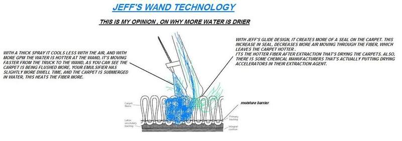

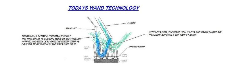

I have been thinking? how can more water get the carpet's dryer. You would think flushing a lot of water would overwet the carpet, but I can actually take a bucket of water and pour it on the carpet. The water will pour out from where I pour it. This is because the carpet has a moisture barrier in it's primary backing. This barrier does not make the carpet waterproof, it just gives you some time to blot up a spill in case you have and accident. So adding more water as long as we are picking it up fairly soon, should not overwet the carpet.
This is just my opinion, on this concept of Jeff's design, which I think is a revolutionary breakthrough.

ok, see what you think about this. It's a lot more simple than I was thinking. The fiber will still be hotter from the increased heat on the carpet, and dry faster.
As for any other mfg. doing high flow I've never heard of any one doing 24 jetting.
LES

Les that is good and just what I was thinking. The only difference is the angle of the jets, on my wand the jets seem closer to the carpet and at a bigger angle the water does not hit the carpet at the angle you show in the picture. But it's the same thing.
Flow is KING, I have noticed a difference in the weight of the wand with every step I have made. More water better cleaning.
