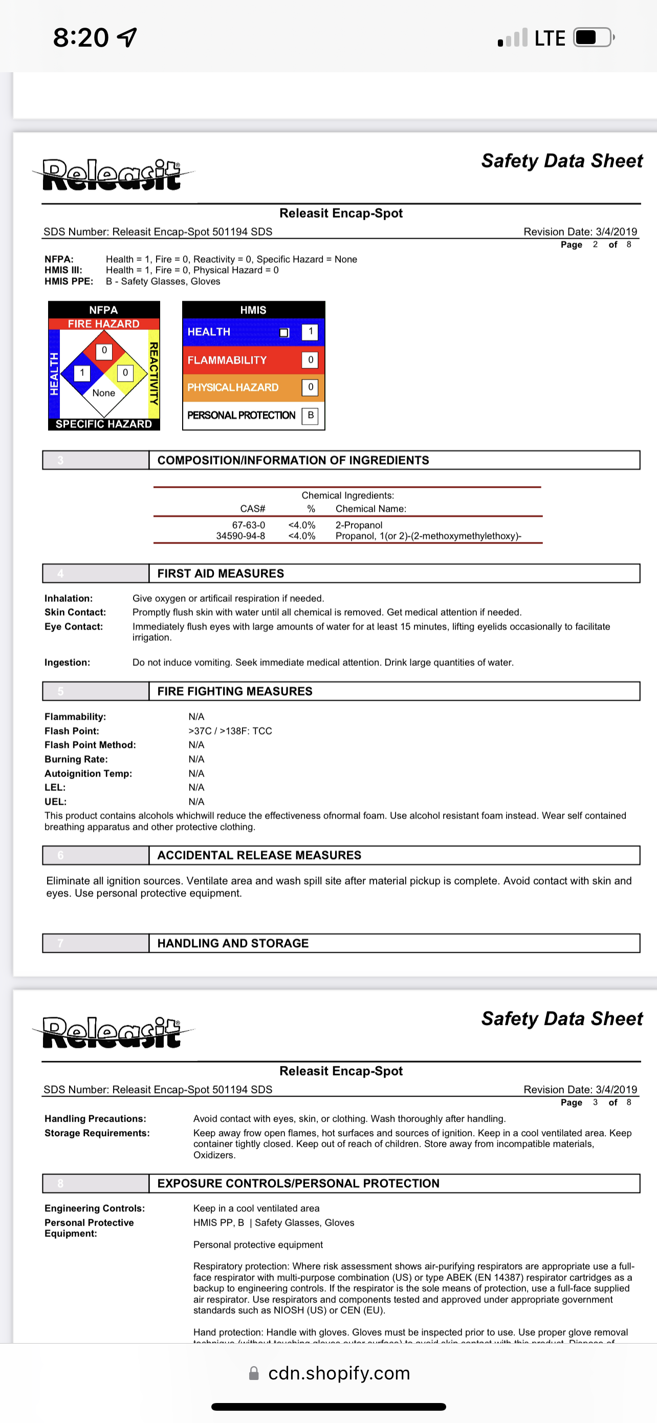

Encap-Spot will also take out a lot of ink spots.

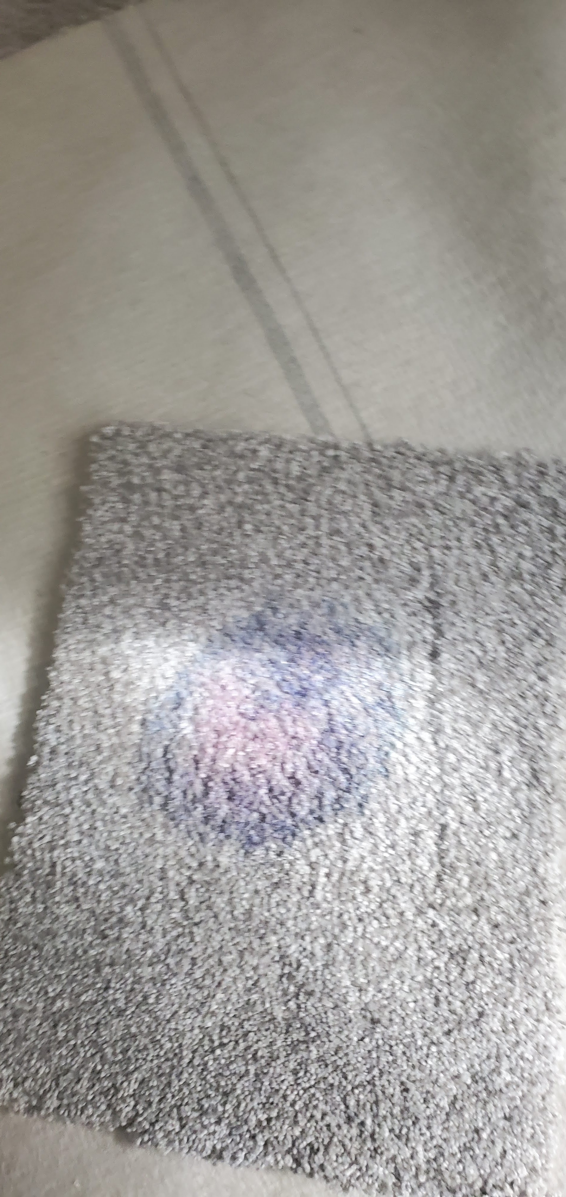

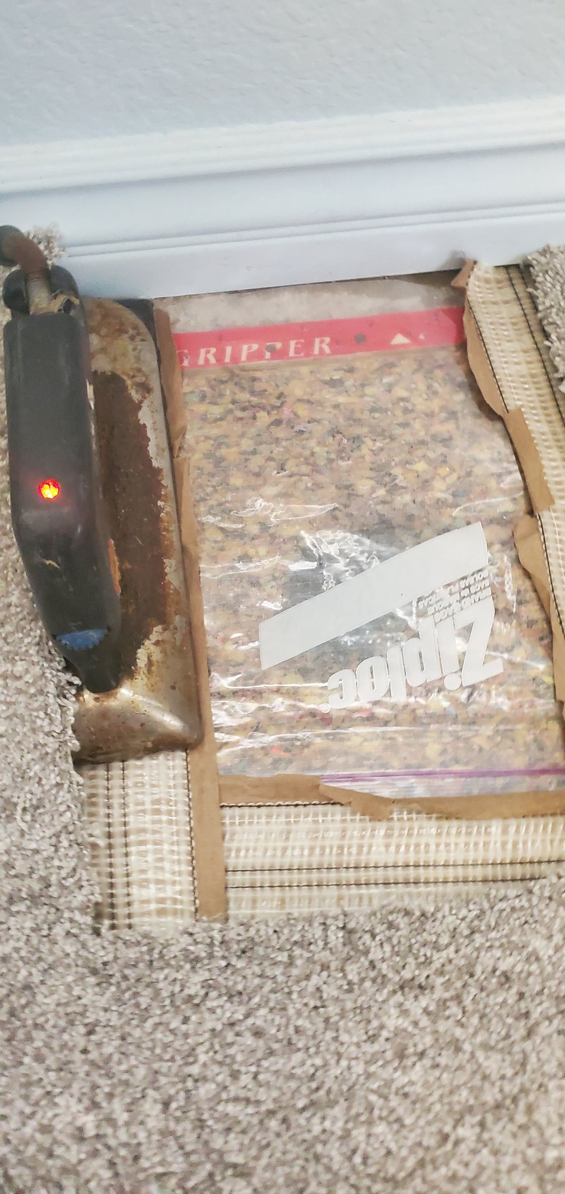

Seriously not all ink is created equal, just cause you got lucky on a sofa and thought you were a hero.
I had a small drop in carpet explode ended up patching it.
You can see the size of the ink spot in the pad.
View attachment 115320 View attachment 115321
That's why you want to use a gelled product. In a pinch you can use hand sanitizer with a 70 percent or greater alcohol content. Doesn't work on all inks.
11,354
Power gel stain 1 and pro solve liquid.
The smallest pinhead exploded.
Wasn't a ball point ink either.
I've never had luck with ink exit.
A cuff and hand sanitizer has worked. lol
Your right on that….As i said a few threads up….had a situation that appeared small ink no problem….ended up half the room was inundated with The Blob.
