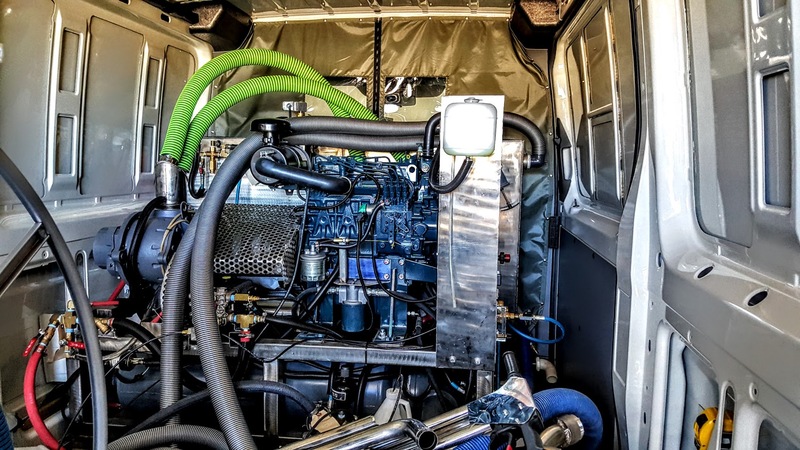

Local buddy of mine owns it..

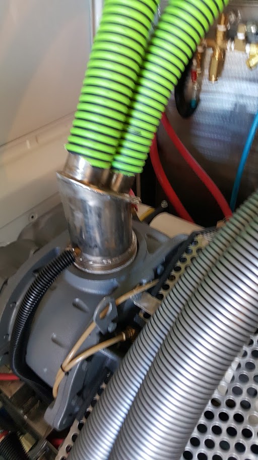

45 blower and a big ass cummins diesel

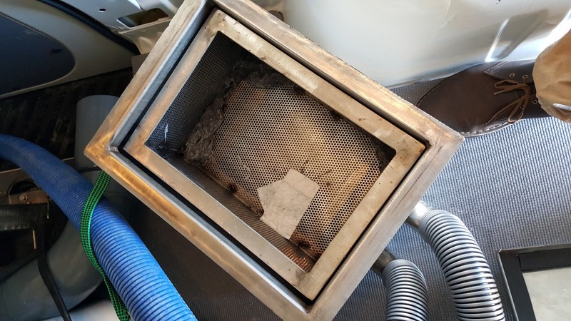

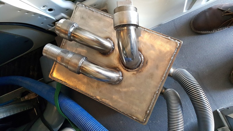

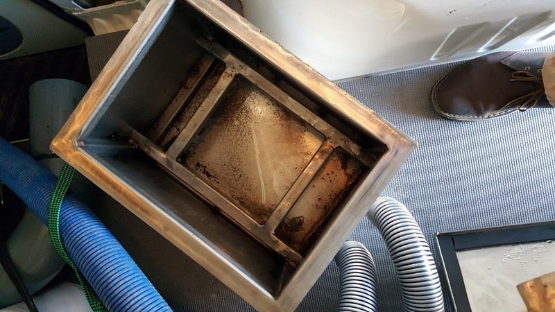

the world's most over built filter box..

4 to two 2's

the world's smallest blower protection filters..

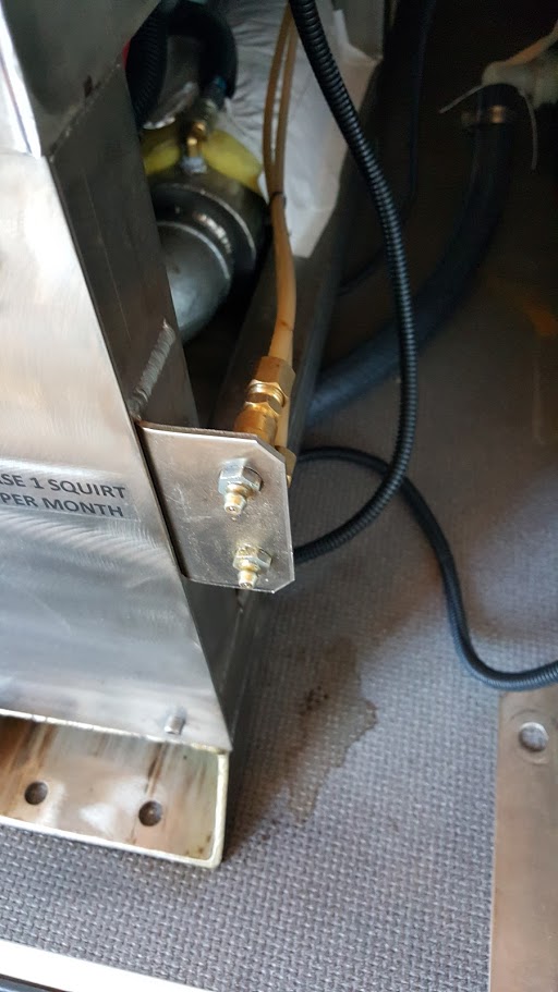

Blower lube ports out front..

That Cummins should be driving at least a 59. What a waste of torque!

Still pretty cool to me. Looks really clean.
I think that is kinda what Savage does to his blower set up...2 2.0 to the blower to waste tank connection.
