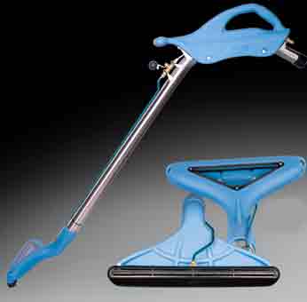

So the pmf internal jet upholstery tool seems to be an awesome tool all around which I use on upholstery. I'm sure they make internal jet wands and am curious what advantages and disadvantages those might have? I have a pretty good idea but curios of yalls thoughts?

If you mean a carpet wand with the jet inside the vacuum chamber, I'm not aware of such a thing

Yea I wondered if there was one. I could see them having some pretty potential benefits especially for yall rich cleaners cleaning up at those millionaire mansions lol. No over spray on other surfaces. No over wetting from sitting in 1 spot to long. No inconsistent dry times in random areas for the most part. No issues with cleaning pattern. So on so forth. Now obviously this sounds similar to a drag wand or rotary tool but qoukd be slightly different

I have an enclosed PMF stair tool. One user advantage is the controled overspray. The technical advantage is that it retains heat better than open.

I used a pmf buttercup wand (lame name) for several years.
I loved it until I switched to the mach wands
I should’ve skipped the mach and just spent the $$$$ to get the prochem titanium
But back to your reason for this thread. I really enjoyed the internal spray
It wasn’t inside the vacuum chamber. But it did prevent overspray
Yep I was thinking a stair tool would be pretty much a smaller version of what I'm talking about. How well does it clean compared to a open jet tool?

There's no need for an internal jet wand. Especially with how hot your truck mount gets.
Yea I get that I was just cleaning the rugs on top of wood floors at my house and it just crossed my mind on how nice it would be not to have to worry about overspray. Now ik some of these guys will say that's why you clean them in a rug shop 🙄

Pretty cool. Just seems like a internal jet wand would be absolutely ideal for the ones on her that clean high end carpets that aren't even dirty and just need a quick rinse. Seems more practical. Maybe I'm overthinking it lol.

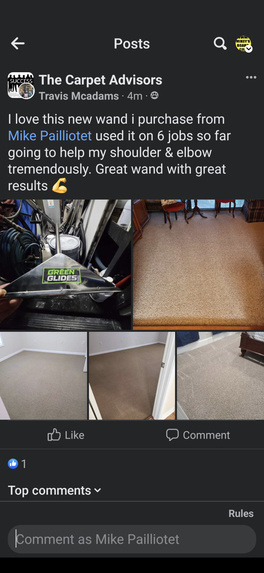

The only actual “improvement” ever made to wands was the glide. Everything else was just window dressing.
I don’t know pig guy. Doing away with the bulky triangle head down to a low profile rectangle head and the feather trigger with the jets at an angle instead of straight down is nice too
Yep has it's advantages and disadvantages for sure. Would definitely be alot more low profile and easier around furniture to maneuver theoretically
