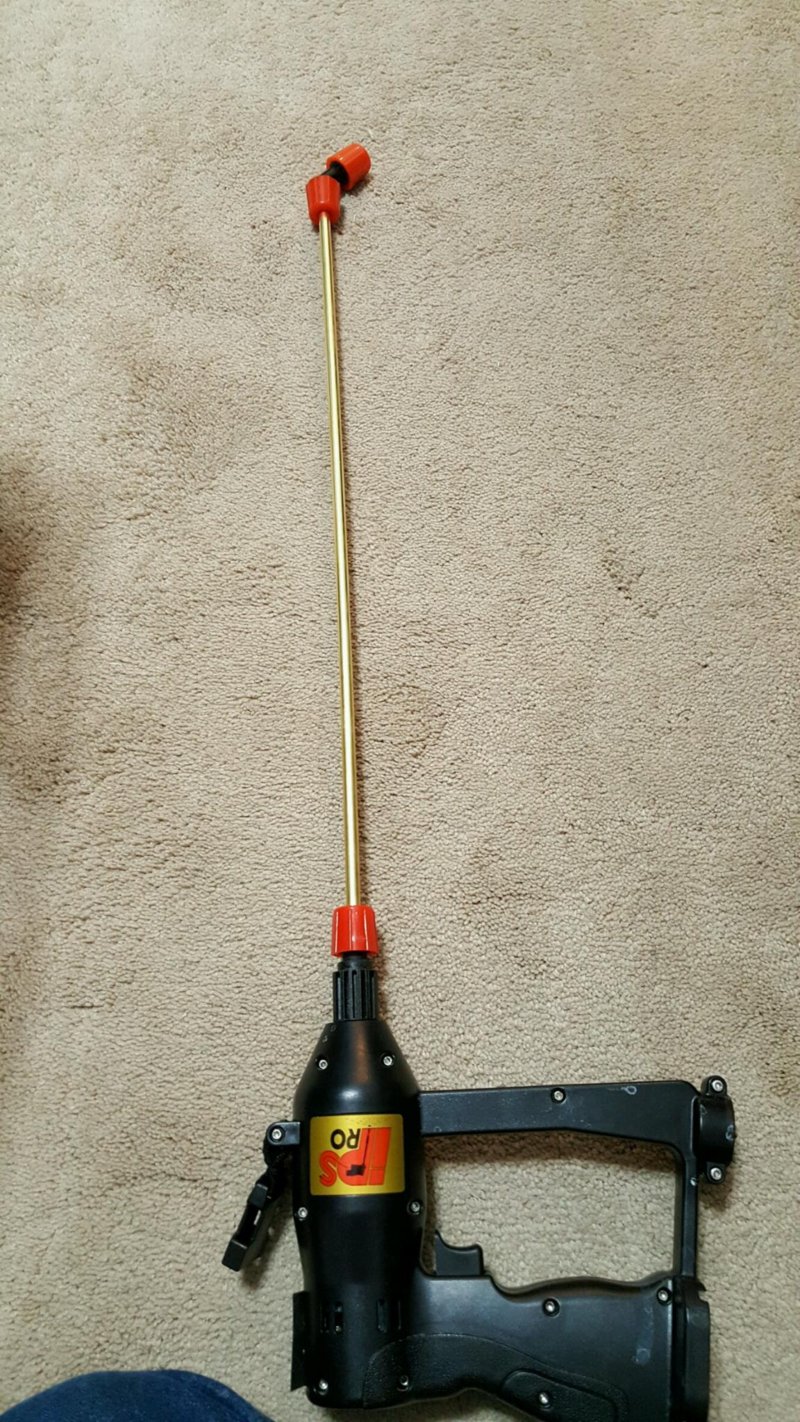

1st thoughts..
I certainly have questions about some of the spray tips, the lay out of the box and really wonder why no manual was included. I' give the two a shot but imagine I'll get some stainless tips soon as the included two put up a bit too much..
After talking with Shawn Bisallon I decided to fasten a five foot long section of hose to it and primarily use it with a 2.5 gallon jug. I'll use it far deodorizing, encap pre spray and maybe mass coffee spotting. I used a hose clamp to fasten the 1/4 hose on.
I also took a grinding wheel and McGiver'd the case to fit the gun with a tip and the hose installed. Taking both off after each job would really shorten the life of the plastic threads..

Only benefit I can see for the rotating tip is in being able to easily adjust the angle of a fan jet tip on-the-fly.

The tip doesnt move, just the logo'd colar...
Oh.....then it's just silly.
You should be able to hold the far end of the lance to steady the unit when changing tips, not have it spin around making you have to reach farther down for no good reason.
That would annoy the shit out of me.
I'd Dremel those fooking pins right out and 86 that thing.

its a extension to the wand.......I should of left the other end on but when I was messing with it trying to figure it out I left it off in the picture..there are 2 red caps with built in compressions in them.....take one..slide it over the rod and hook it to the yellow end of the wand...then slide one on the other end and attach the bent one or the straight one to it with which ever tip you want........that being said...I doubt it is going to hold on because from where I am sitting...there is just not enough compression for the amount of pressure for it to hold together..........Personally I could care a less...not something I need or would ever use...I took all that out of the case when I first got it....still the best sprayer I have ever had...my new seal should be here beginning of next week so we will see how well they hold up..I have heard through the carpet cleaning grape vine that they are working good....??????

The compression "caps" hold tight on the gun end but not the spray tip end.
Goofy design.
I wouldn't use it for pre spray, too much mixing of chemicals. I put down at least five gallons per ldh3br home.
The two included T jets are too simular in volume, I need one half their flow.
