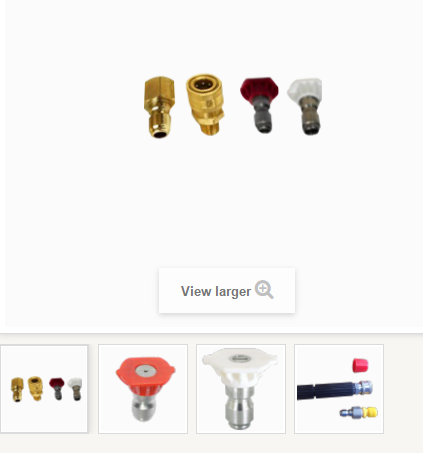

I put them on and tried them and based on the 40 degree tip it seems that the psi/flow of the IPS is too low for there to be enough backpre reach full fan "spread".
Seems more like a 20 degree soaker tip, which kinda kills their upholstery potential.
It makes sense with the tips being meant for bigger pressure washers.
Anybody else try them yet?

What flow rate did you have on it?? because yea a 5 vs a 1 wont but dribble out at 100 psi....

Your gonna want tips made for those electric plug ins, probably a 1.5 or 2.0. Standard tips are 3.5-4.0
Or just make your own
