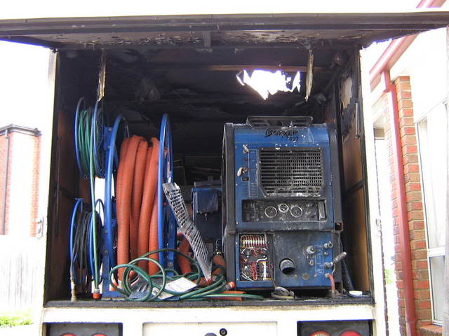

Kelly said:
The first problem I experienced with the genesis machines were the wiring harnesses the wires were actually falling out of the connectors as the machine ran.
In the past, the wiring was done in house at PowerClean in Chicago. PowerClean are now getting all of the wiring done by a professional wiring contractor, and they are thoroughly tested prior to leaving. If something is not as it should be during testing, the wiring contractor fixes it prior to shipping. As an added measure, all electrical ends/fittings are covered with liquid electrical tape to further prevent any challenges.
Kelly said:
The fuse box routinely rattled its fuses loose especially the one controlling the electrical solenoid for the diverter valve, causing it to stop heating its water.
I can hit this one on the head very easily, as I have done it myself. On the older model Genesis, where the fuse box was located, when you reached in to remove the waste tank lid it was quite easy to knock out on of the fuses. I am sure you probably have done the same thing. To get around this simple problem, PowerClean now run with a marine grade fuse box that is fully covered. You have to unscrew the faceplate off the box to get into the fuse area now. It means they can also label them clearly now so as to improve troubleshooting as well which is nice. We have supplied a lot of Genesis machines over here into Australia and New Zealand and I can honestly say I have never had this as an issue due to vibration. Most of the time, an accidental bump would take out the solenoid or the pump clutch or something like that. Simple push the fuse back in, and away you go. But that isn’t an issue anymore. However, this is not a vibration issue, in my experience.
Kelly said:
Once just after installing a new genesis machine... in front of the customer....at the initial start up..the adjusting tensioner pulley blew off right after the engine started.(We had to hustle to keep that guy sold ill tell ya)
I can sympathise with you there. I have also been put in situations like this as well with various machines over the years. But this is why we, as an independent distributor, put ourselves between the manufacturer and the cleaners. Manufacturing problems happen – with anything. But we make sure everything is running smooth no matter what equipment we supply. We put quite a few hours on the clock ourselves with all the machinery we supply to make sure our clients don’t get caught themselves. Manufacturing faults normally exhibit themselves right at the start so putting a few hours on them can normally highlight any mistakes.
I had a client a few months purchase a brand new Ford Transit van that we installed a TM into, and with less than 100 miles on the clock while he was driving home from our factory, the gearbox went in his brand new van and because Ford Australia didn’t have the parts here, he was off the road for 5 weeks awaiting to get it repaired under warranty! Car manufacturers obviously spend millions of dollars on their R & D, and guess what - I still haven't found a trouble free car or truck.
Kelly said:
At the time they were using an electrical solinoid to control the diverter.. it poduced such a load on the alternator when it kicked in that it actually bogged the engine down when it worked.
This is true Kelly, BUT Zenith did approve the system. It did bog the system down for a literally a millisecond allowing for the initial pull of the solenoid. PowerClean then changed to the vacuum operated system because of it being able to increase the overall life expectancy of the diverter and related parts. The new system also allowed for compensation for carbon build-up over the years of daily use as well.
Kelly said:
The auto pump out has no filter and is prone to clogging and some came from the factory which were mis installed and wouldnt shut off at the proper time burning up the impeller in the pump itself.
A filter is not needed for that particular APO. It is designed to pump waste water and is commonly used in large seaworthy vessels. If the waste tank top inlet filters are kept clean, the debris/dirt that passes through it is pumped out. Which is easier, climbing into a dirty waste tank or removing the impeller cover on the machine? Personally, I would prefer the latter of the two.
However, I agree. The impellors can be a weak point. Sort of a catch 22 situation. However, on the new Diesel D-XT Genesis, PowerClean have changed the APO to one that doesn’t use a rubber impellor to get around this point. This is a very industrial unit. Have you seen it?
Kelly said:
Adjusting the blower on the genesis requires a flexible body and some special tools and also the knowledge of belt tension and the ability of checking for proper alignment.
This is true. Adjusting the belt tension is a challenge. It is probably the ONLY serviceable item on the unit that is hard to get at. However, with your experience working on other major machines I think you will agree that that changing a coupler on most units is fun to say the least. What makes the PowerClean machines any different in your opinion??
Kelly said:
the 59 blower in my opinion is not suited for use in carpet cleaning machines unless there is proper balancing or load torque compensation which by some miracle white magick seemes to have worked out, and power clean still needs an education on.
I have never met you Kelly, but I wouldn’t mind to one day. However, that is a massive call you have made right there. Correct me if I am wrong, but are you saying a company the size of Dresser Roots is incorrect and you are correct? You know yourself, that every major manufacturer, PowerClean included, involves the independent component manufacturers in the production process. They are the ones at the end of the day that maintain the warranty, so they want to make sure their individual component is working well in it’s designed application, otherwise it comes out of their back pocket to keep replacing or repairing the said defective component. Dresser Roots have approved and give a warranty to all the blower configurations that PowerClean use.
