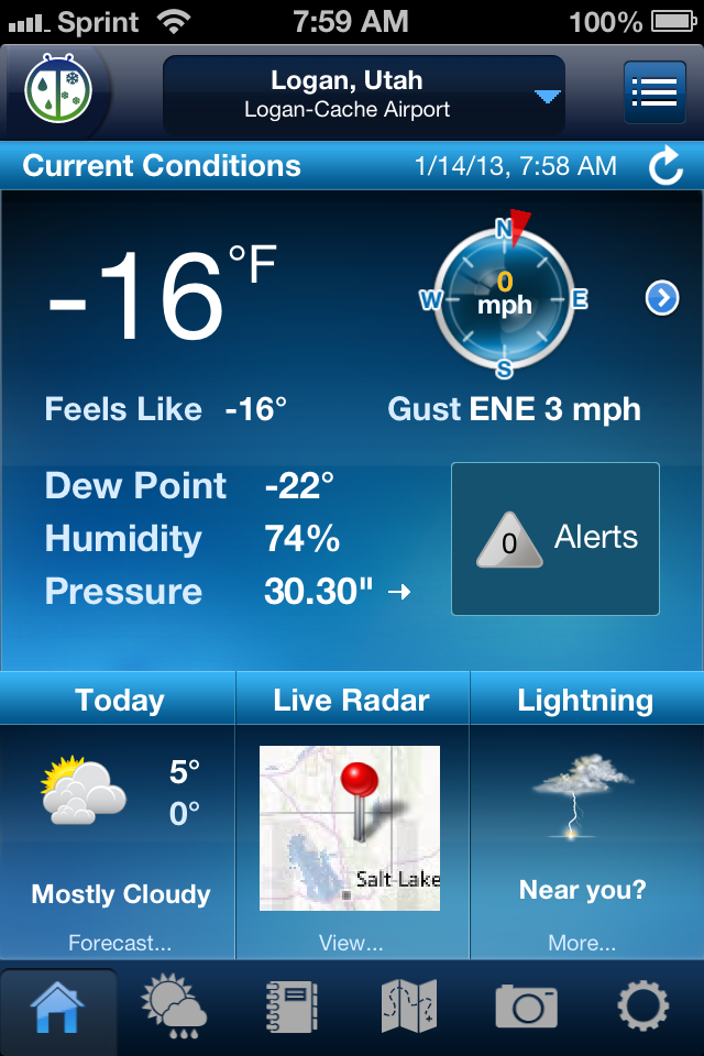

Just about every day this January has been like this. Its the coldest winter I can remember here. We just happen to be cleaning 20k feet when it was -16. It warmed up to -5 though.
Jeez, that's Alaska weather!
