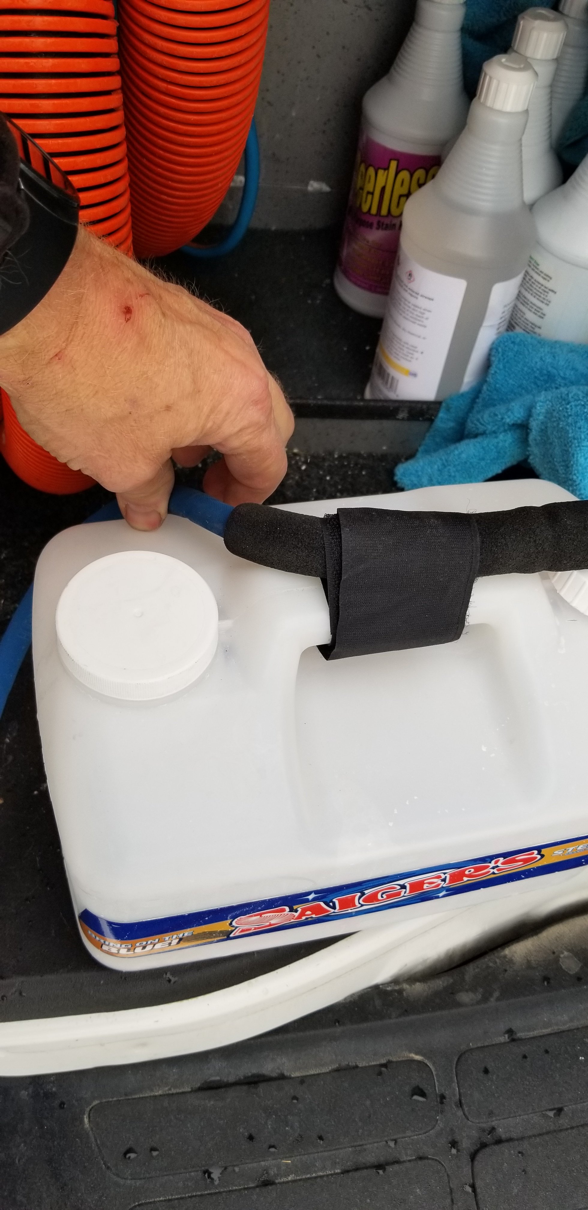

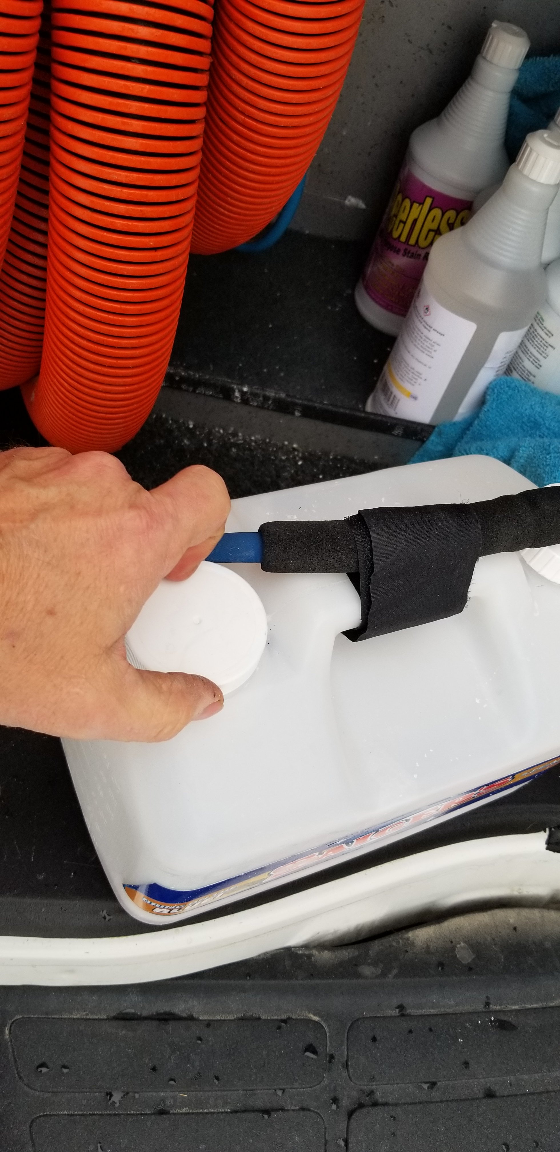

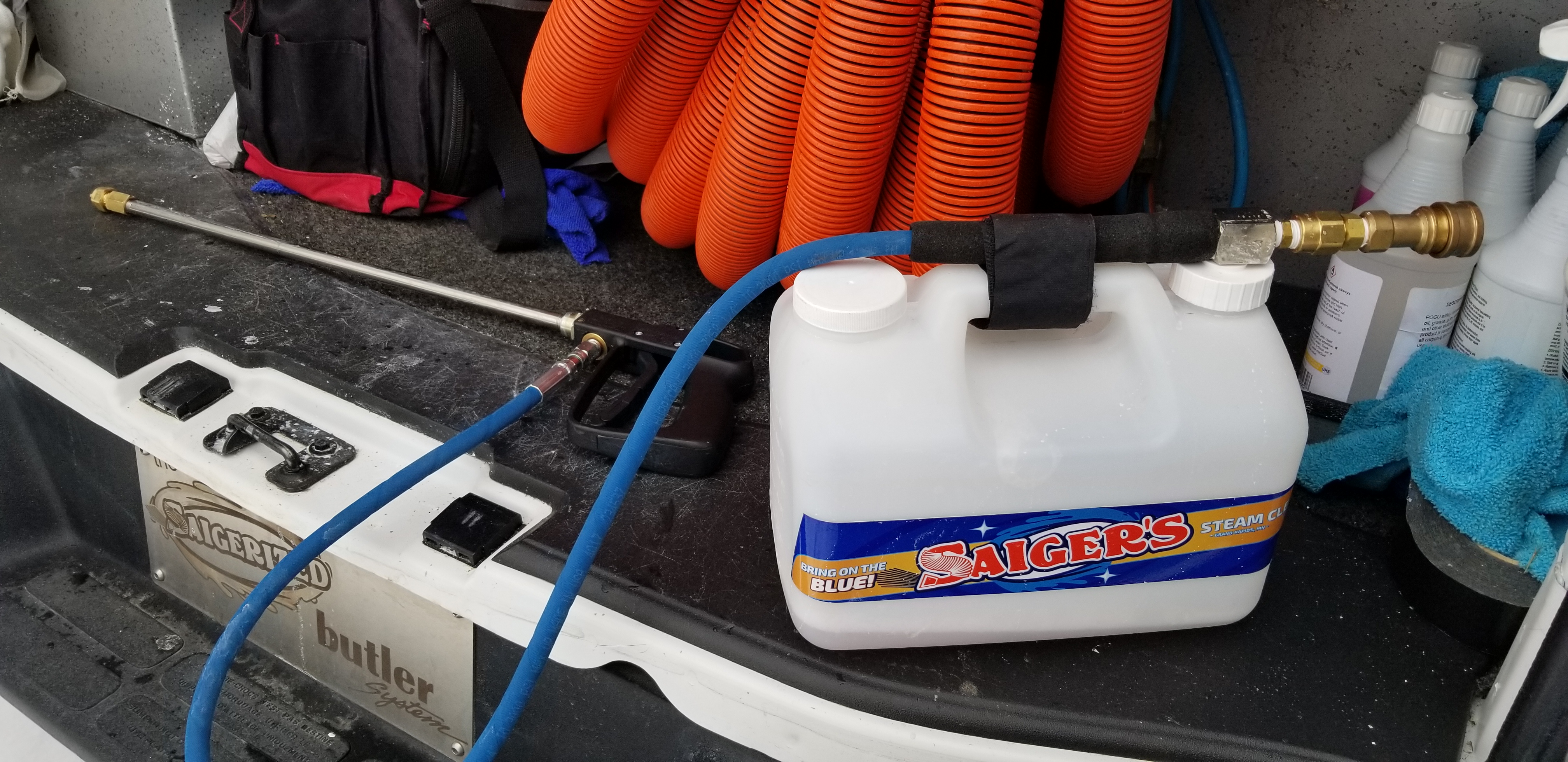

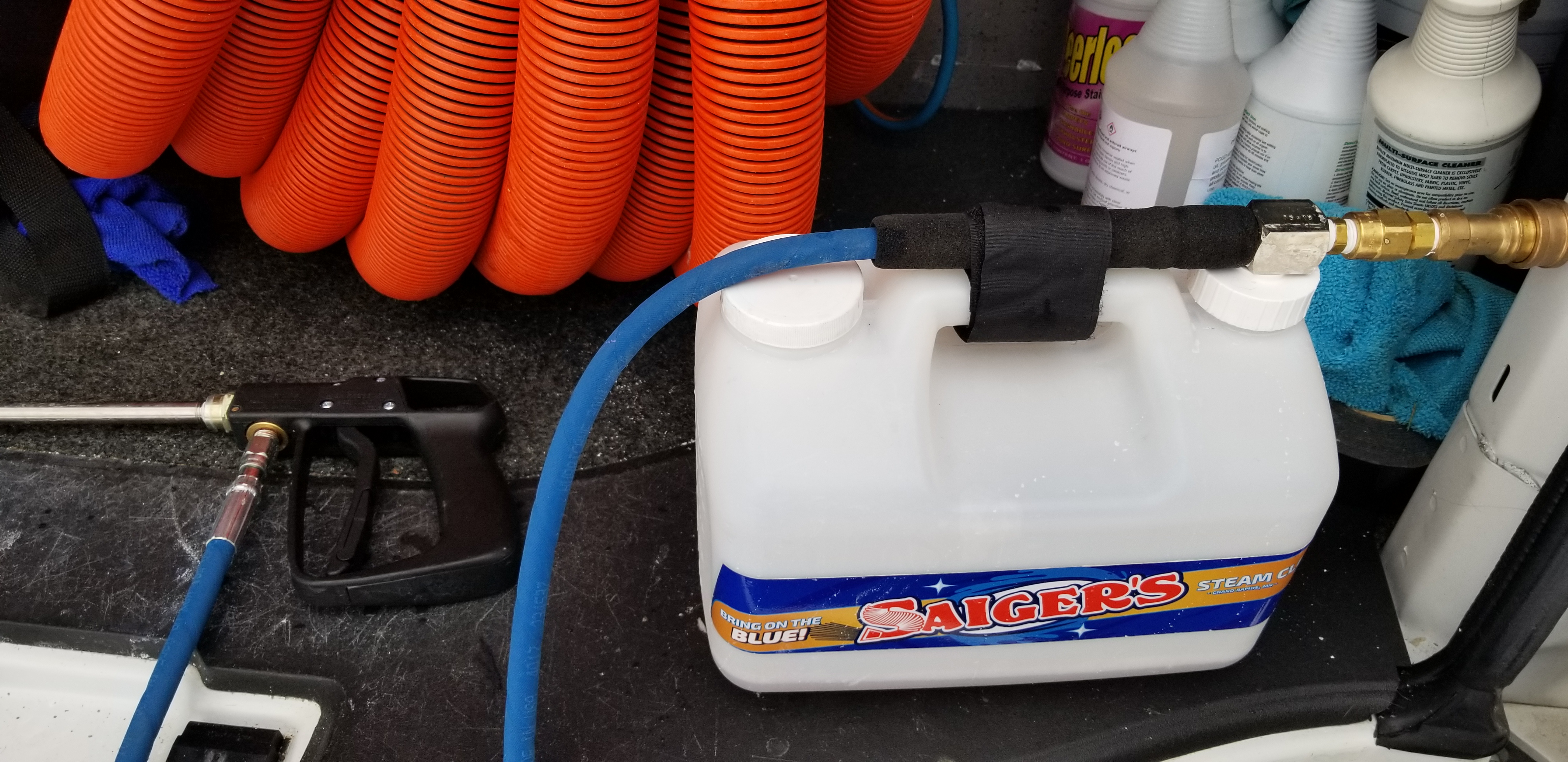

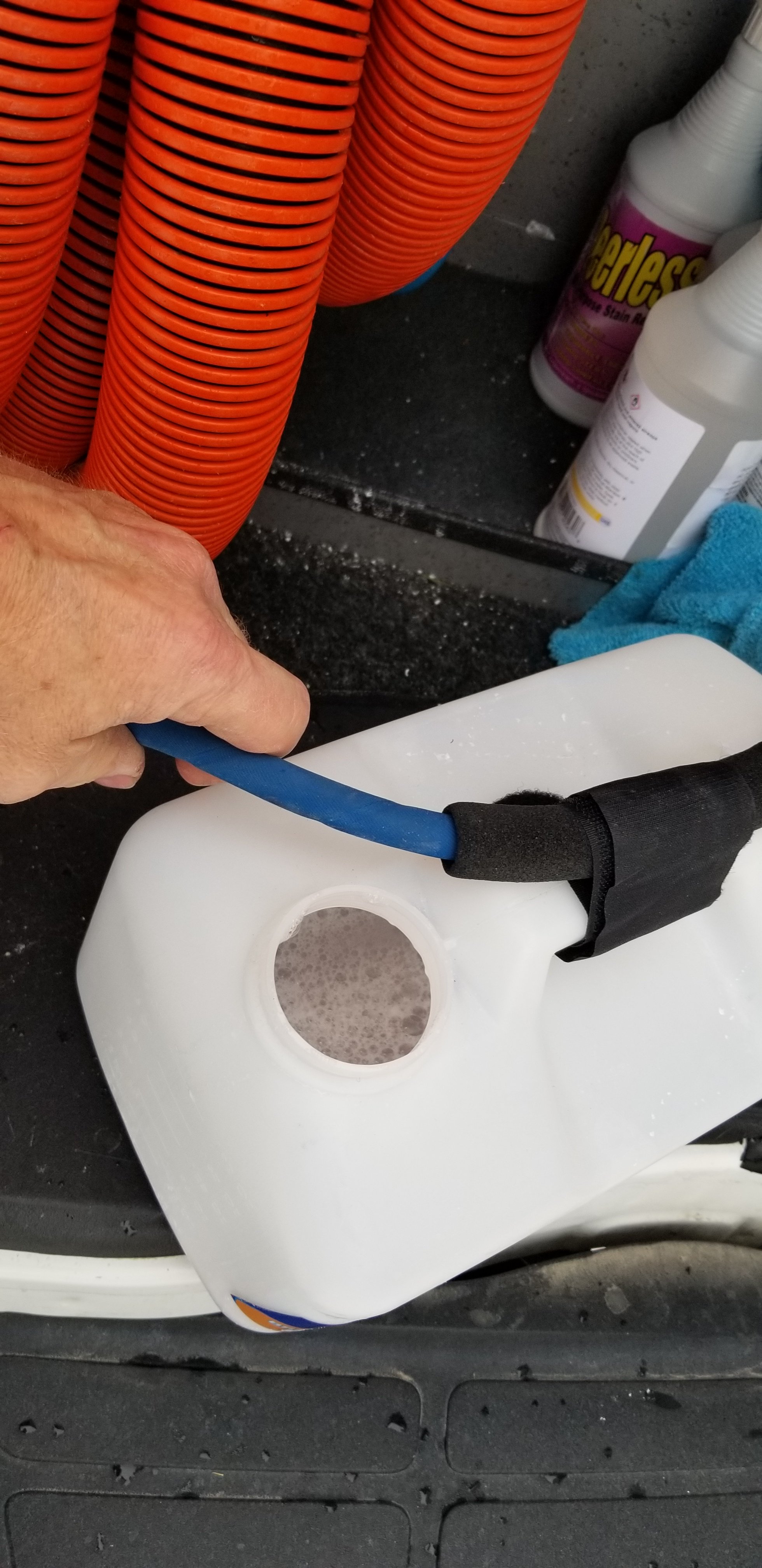

Yes...that's what then did on the six quart units. If look in pics, easy to get to the large opening now because the rubber hose will move off to the side.
