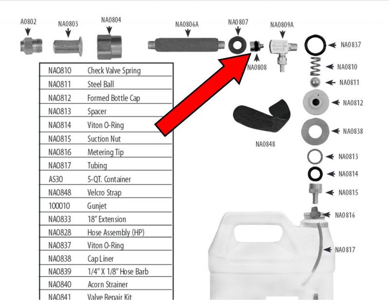

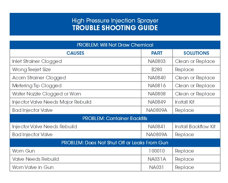

Here is that 10 problems list and the exploded parts view.
<!--[if gte mso 9]><xml> <o:OfficeDocumentSettings> <o:TargetScreenSize>800x600</o:TargetScreenSize> </o:OfficeDocumentSettings> </xml><![endif]--> [FONT=&quot]HYDROFORCE PROBLEMS[/FONT]
[FONT=&quot] [/FONT]
[FONT=&quot]Ten possible problems that will prevent it drawing -
1) The filter behind the QC where the water comes in gets plugged. Many folks don't even realize there is a filter there. So they never clean it. Should be cleaned every week or two for best performance.
2) Strainer behind spray jet tip clogged. Another "hidden" filter.
3) Spray tip changed to a smaller size or plugged with some powder, hard water deposits or whatever. Keep spray tip clean and replace every 6 months to a year.
4) Air leak in the draw tube that goes down into the chemical. If it is drawing air, it won't draw chemical. That plastic will eventually crack or split. Also one of the cheapest parts to replace.
5) Spring installed upside down after it was taken apart.
6) Dema valve clogged or corroded and needs to be replaced. The most expensive repair.
7) Breather hole plugged. Clean out.
8) Water nozzle clogged. This is a relatively inexpensive repair. (Replace NA0807.)
9) Metering tip clogged. Replace.
10) Acorn strainer at the bottom of the draw tube plugged.[/FONT]

49,924
Isn't it depressing that you spent so much time and money on this site and all you can get out of the fools here is a schematic drawing?
Fools? I see no fools here!
Well....(there's always a "Well") besides yourself that is! :winky:
