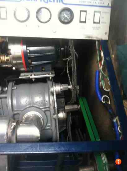

My First : )
Thought I smelt it.
Was down a total of 2 1/2 minutes : )
Tyler said he never seen me run so fast before, wow!

prolly YOU that started the fire wit those damn Cosco cheep assed belts.......:dejection:
Thats it ya crabby fooker!
I am mailing the belt so you can actually fondle it a lil.
B good for yA : )

They have a higher temp rating and last longer. I had the problem with shredding belts when I first got my machine. I got maybe 3-4 months before shred, yes Bob green. It's a easy problem to remedy. Put a radiator fan on your belts and drop the temp and they will last forever. The higher the temp the shorter the life reardless of belt quality. That's why ss puts the fans on their belts.

Gene..that unit don need a fan....
jus an operator that can follow manufacture directions
and the knowledge to align belts correctly

Yea no shit...my buddy runs them belts till they catch fire...on a genie too..and I been runnin mine for 2 years and no prob...

I have seen smoke roll out the doors : )
