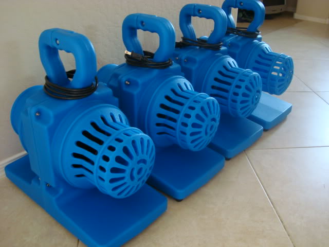

Very interesting Ken, tell us how it works. Is it on a thermostat? or do you just run full on until you're done? CFM motor size and amp draw?
Looks well thought out and constructed very strong. 8)

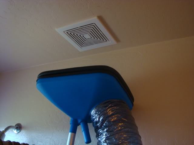

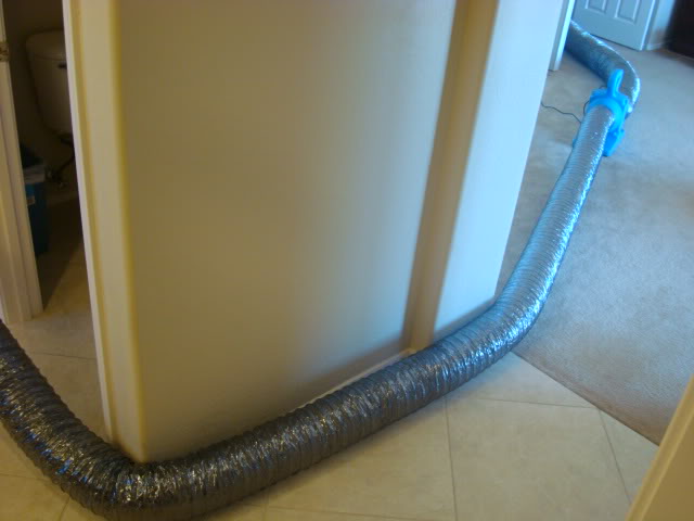

The booster fan runs on 31 watts. This is .259 amps. CFM under no load is 226. You can run up to 75' of ducting, which comes with the unit. Venting through the ducting and then through an exhaust fan in the bathroom or laundry room nets you around 100 cfm on an typical setup. Unit is is designed to run continuously. No on or off switch. Not something you want someone shutting off. Works with a 12' or 20' Zipwall pole.
Our goal with the VapairVent (patent pending) was to create the moisture removal capabilities of a large refrigerant dehumidifier without the energy requirement or having a door or window compromised. Although you can duct out a window if you like. We have also used the VapairVent successfully by venting out through the dryer exhaust.

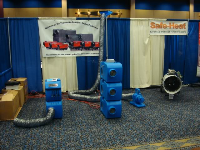

Especially in the beginning of jobs in which you are looking for more dehumidification than you have ease of electrical power, the unit can greatly increase moisture removal from the drying area without hardly using any electricity. Quiet as well. We had it running at the Connections show and no one could tell. I will say that in a home void of the noise in a convention hall, you will hear it running.

Aside from drying, could that setup with the vent cover and zip pole be used to as exhaust for neg air?
Does it seal tight enough for environmental work?

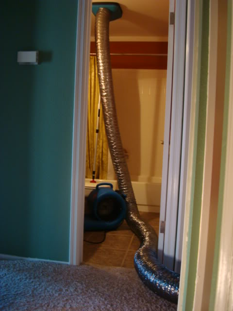

I did a 2 bedroom, hallway & small bath flood in which we floated the carpet. We only used the VapairVent and the photo of the bathroom above is the job. Dried completely without the use of a dehumidifier.
I would say it would not work for neg air containment situations. Definitely not.
You can use it for ducting from an a/c vent to the Phoenix Solution. I have a Servpro in Florida that does this and he says it works very well.
The main thing about venting out of an exhaust fan in bathroom or laundry is to make sure the the exhaust ducts out of the building. Some older homes did not require this if a window was in the room. Good to check first or you may be dumping moist air into the attic. I have not come accross this yet, however, it is something to be aware of.
