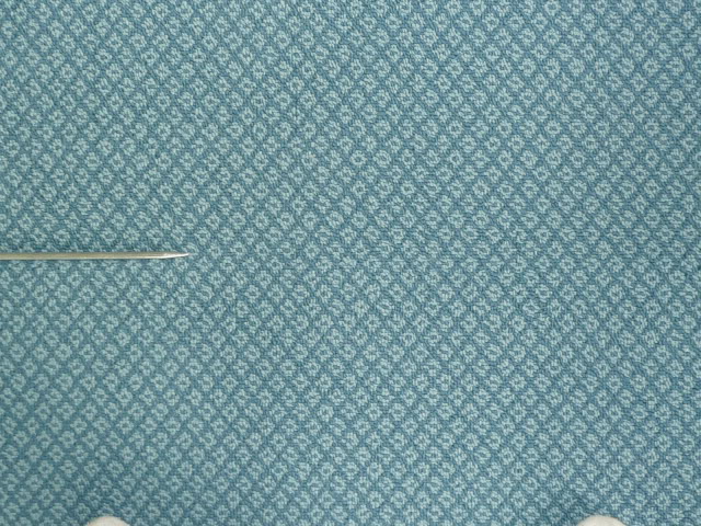

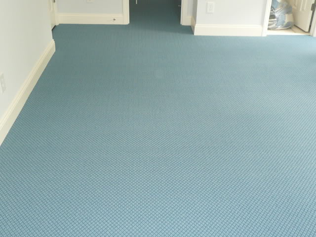

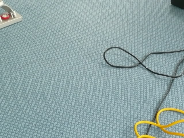

Here is a carpet small pattern. The smaller the pattern the more to line up. This makes it harder for us to do. You will see the runoff. What I did was start in the middle of seam. Stretched both ways to achieve pattern .

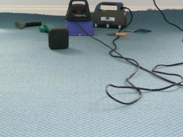

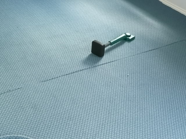

What I did was kicked it up to achieve match. As you could see the rest of the seam is not done. This is how we spot weld it could be anywhere I was lucky enough the pattern was pretty good after I kicked it.

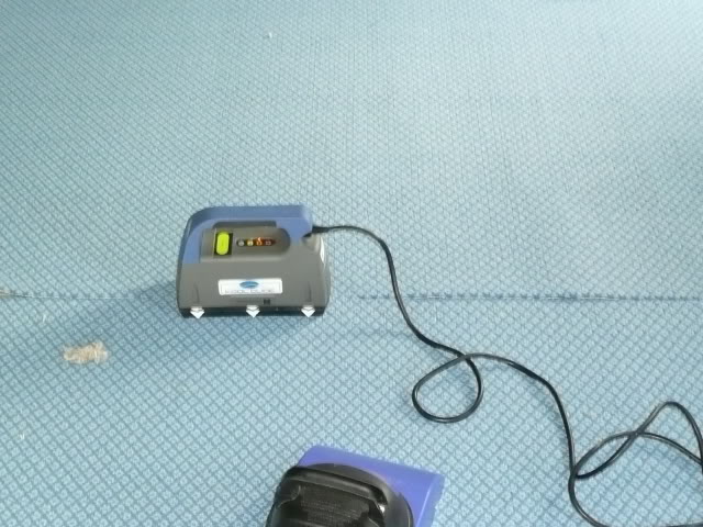

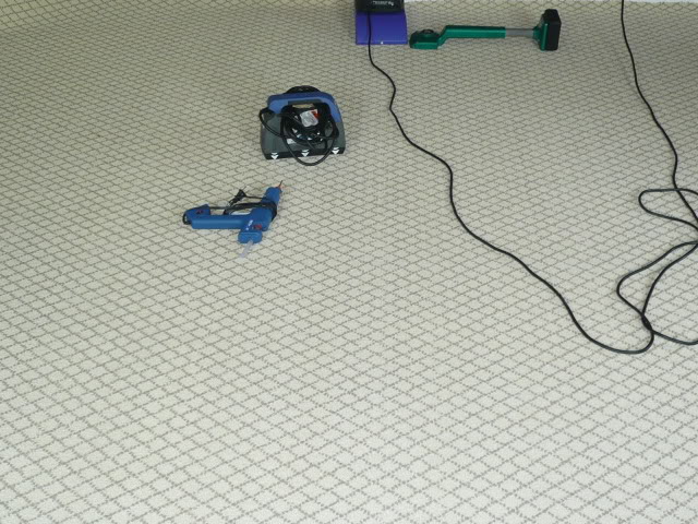

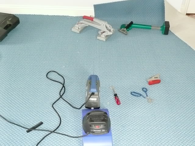

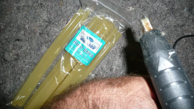

Here is another run off. Spot welding needed. I am showing the kool glide sticks along with the orcon Peak Buster . Sometimes like on friezes or some pile carpet s, I like this tip better. You seal both edges it is neater.

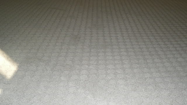

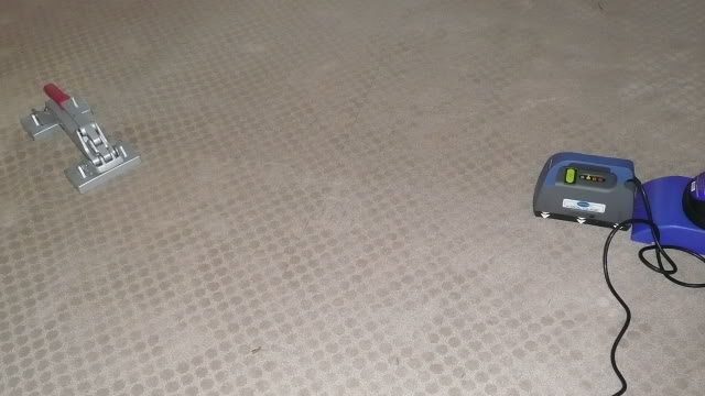

The other side of the run off.
If you notice I made some line to match my product . If the lines are off so is my workmanship.
