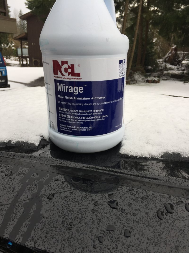

Bought this rinse free neutral ph cleaner. Used Mikey's method for cleaning a tile floor for a commercial account we clean weekly.
Will be trying it out on laminate on 1000sgft on Wednesday...
