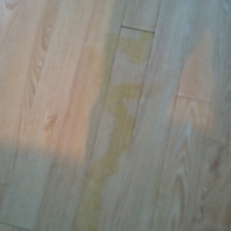

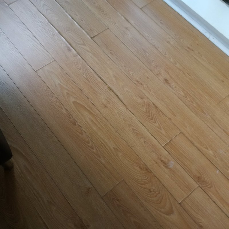

27,108
I just did those laminate floors today. Turned out they were badly water damaged and couldn't have used a 175 on most of it due to warpage. Floors should be replaced but lady wants them cleaned for now. Used my wife's handy/dandy spin mop with a neutral cleaner with some urine deo in it. Then a scrub with zep l. Floor cleaner. Then rinsed it again. Came up nice except for the damaged areas.
Reactions: EDS
27,108
she had a small flood and her tenant did the rest apparently. she just wanted it to be more sanitary so she could move back in and plans to replace it soon. I'm thinking on my next one, I am going to try a 175 and cotton bonnet.
